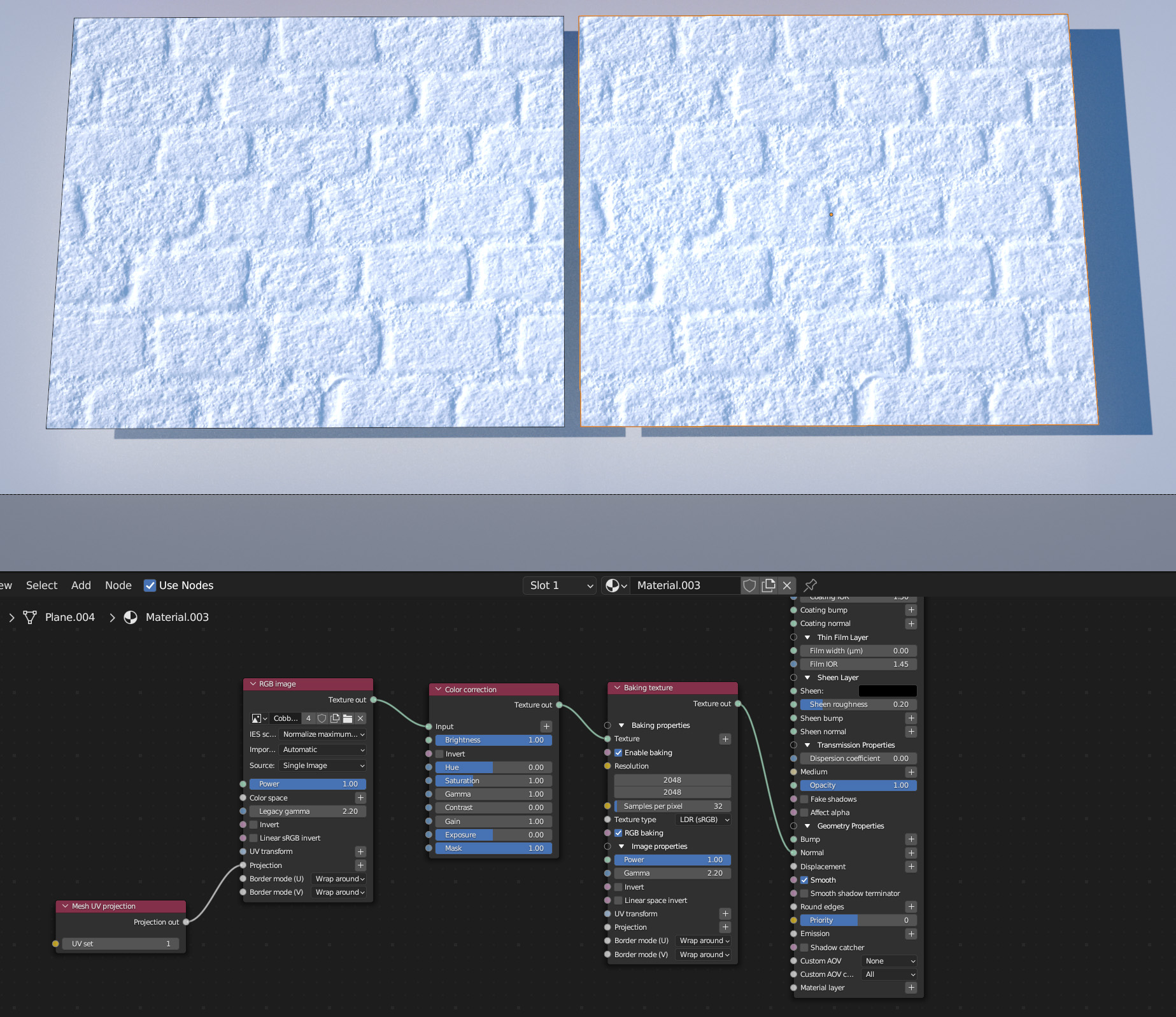

Changing the Gamma doesn't do anything - so 2.2 is as good as anything else. And I don't see a "Non-Color-Data" selection anywhere, so that's not an option either. The RGB image node isn't the problem.
As for the bump map issue. I fear you got a point here. The other thread is a few months old already and the bug is still there. Plus the last official reply was "It seems to work", which isn't reassuring. I remember reporting the same issue to the Luxcore devs a few years back and they never solved it either. But there it was because in the background they already knew, that the project is going to die. I have a similar vibe here but I hope I am wrong. So far no third-party renderer for Blender has survived and thrived. That's why I'm a bit hesitant about Octane as well. I don't want to end up with even more project files that I will have to convert to Cycles in a year or so. We will see. For now I'll stay in testing mode and will hold back on production.

Again, the only operation that makes sense to perform on a normal map is to vay its strength (using the Multiply node) or combining them (Add node). Anything else doesn't make any sense. Unless you tell me about a situation where changing the Hue or Saturation (or whatever change the Color Correction node allows to do), we can't talk about a "bug", and we can't talk about a needed "work-around" either, since there are defined way to work with Normal maps "changes", and those implies using the nodes I just mentioned.

Don't worry any longer. The Multiplier node will do for now. And if I need some more contrast, I will change the map in Photoshop and save a separate version. I never talked about changing the hue or saturation. Sometimes I tweak the contrast a bit. And the Color Correction node would allow me to both adjust the brightness as well as contrast. At least in Blender that's possible. But generally a node that doesn't work as supposed and even changes the output although it shouldn't do anything at all when no settings are changed, is something that I would look into as a programmer. Just to keep things tidy and avoid misunderstandings. A node that works differently for different sockets is prone to confusion.

A little follow-up. If I feed the node through a baking texture node before going into the Normal socket, it works. Not that I would use it as a workaround, but maybe this is of some value in case the devs want to take a look into it anyway.

Actually it has been solved in Octane 2023.
