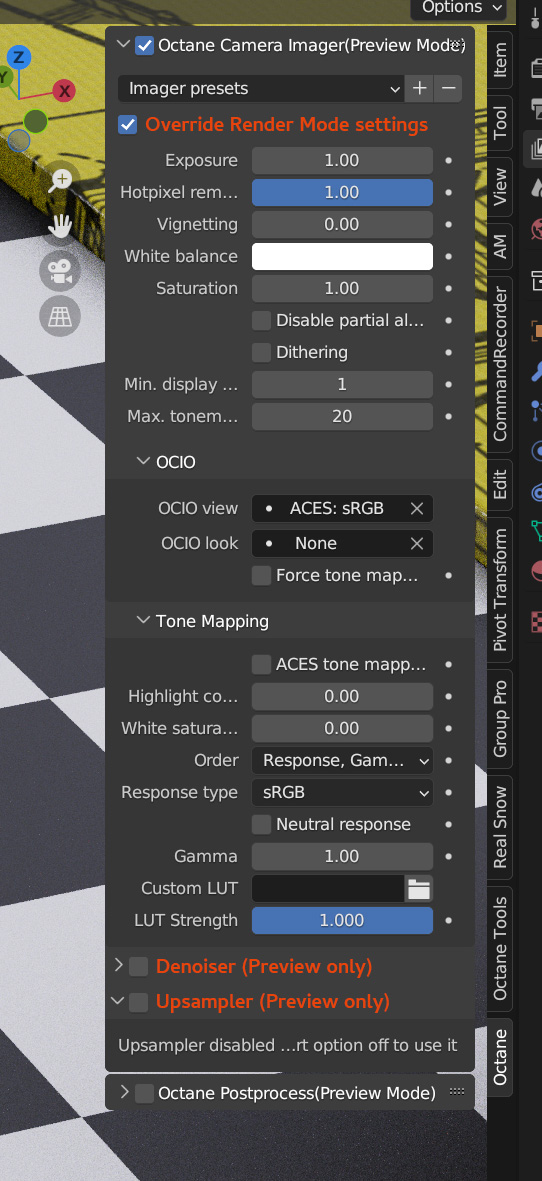

Here's a mockup about how I would adjust the Camera Imager (Preview Mode) panel.
I would also do these things ...
*) Never gray out the first section of the panel, no matter if the Override checkbox is checked or not.
*) Align all the sub section to the left.
*) Make the Denoiser (and maybe the Upsampler, which I don't really use) independant from the Render Mode setting. Me (and I guess most users) would have the Denoiser OFF in the viewport for performance reasons and would like it ON in final rendering.
*) Alternatively automatically denoise the passes that are checked in the Denoiser passes section, no matter if any Denoiser checkboxes are checked anywhere.
With those changes I would set my Render Mode settings properly for output (including Denoiser ON). I would have the "Override" checkbox in the Preview mode OFF and would not have to worry about the final rendering settings any more. I would also mostly have the preview denoiser OFF (as it's set in the Render Mode section anyway).
Maybe give those changes a thought. I think they might improve the overall experience.
