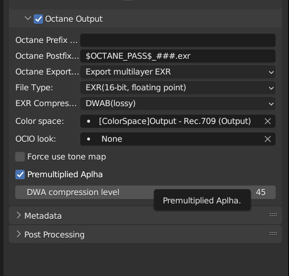

Is there a way to apply a gamma correction to the EXR when saving? Right now I have to adjust the gamma in Photoshop (to 0,4545) for every layer in the EXR. I know Photoshop isn't the best tool to deal with EXRs, but it's my preferred way for image editing. Any advice?
Here are my output settings ...
Not possible, never will be.Andreas_Resch wrote:Is there a way to apply a gamma correction to the EXR when saving? Right now I have to adjust the gamma in Photoshop (to 0,4545) for every layer in the EXR. I know Photoshop isn't the best tool to deal with EXRs, but it's my preferred way for image editing. Any advice?
Long story short, it's completely against foundational principles (and not subject to personal preferences).
However, for that purpose, there is TIFF.
EXR "linear" encoding > conformed to the output medium (web/display) through an EOTF is the basic necessary post workflow, but not recommended. See why here, and the other relevant pages from the website.
