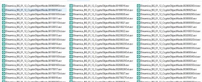

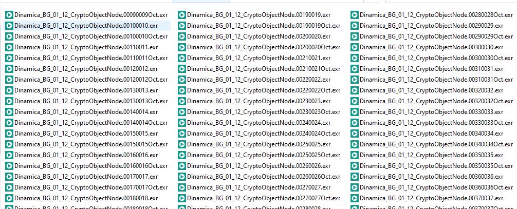

4. another issue is that when saving any of the cryptomatt render elements, octane save two files, first file named:"file_name_0001" and a second file name:"file_name_0001Oct" having the "Oct" in the end of each frame is preventing adobe after effects to recognize the files as a sequence and forcing me to put all the render in a different folder and use the "Force alphabetical order" when importing the files

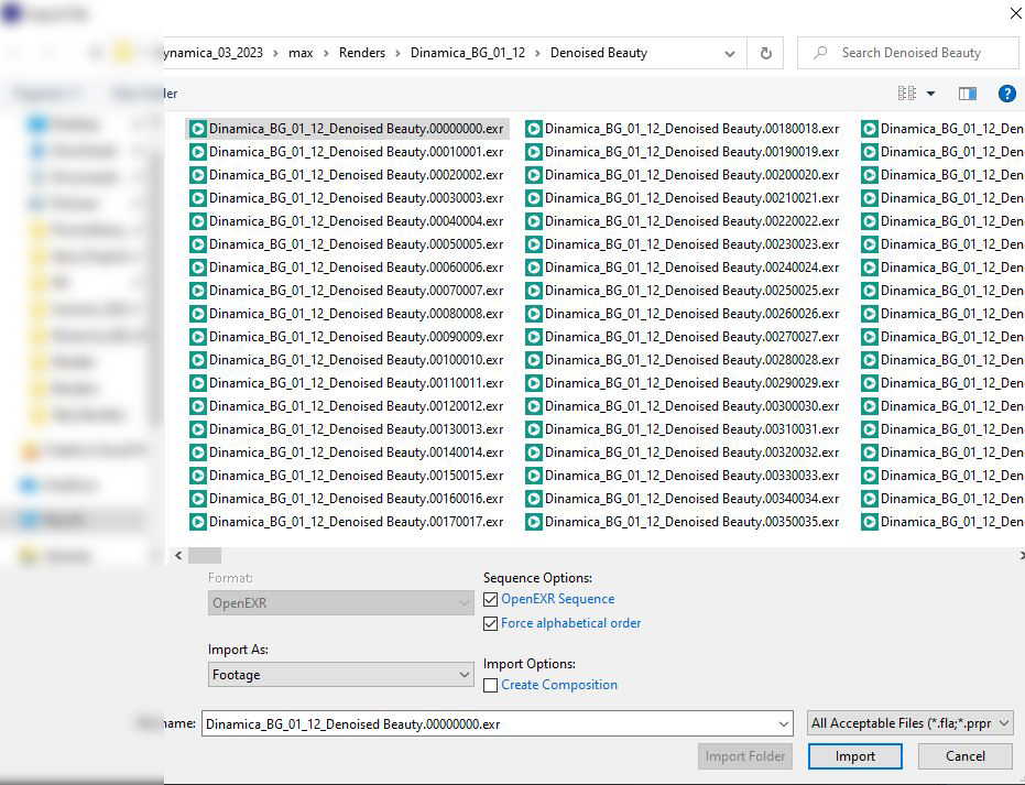

4. another issue is the frame numbering when using deadline, I'm getting "file_name_00010001","file_name_00020002","file_name_00030003" and so on, this causing adobe after effect to think there are missing frames between one frame to another also forcing me to put all the render in a different folder and use the "Force alphabetical order" when importing the files

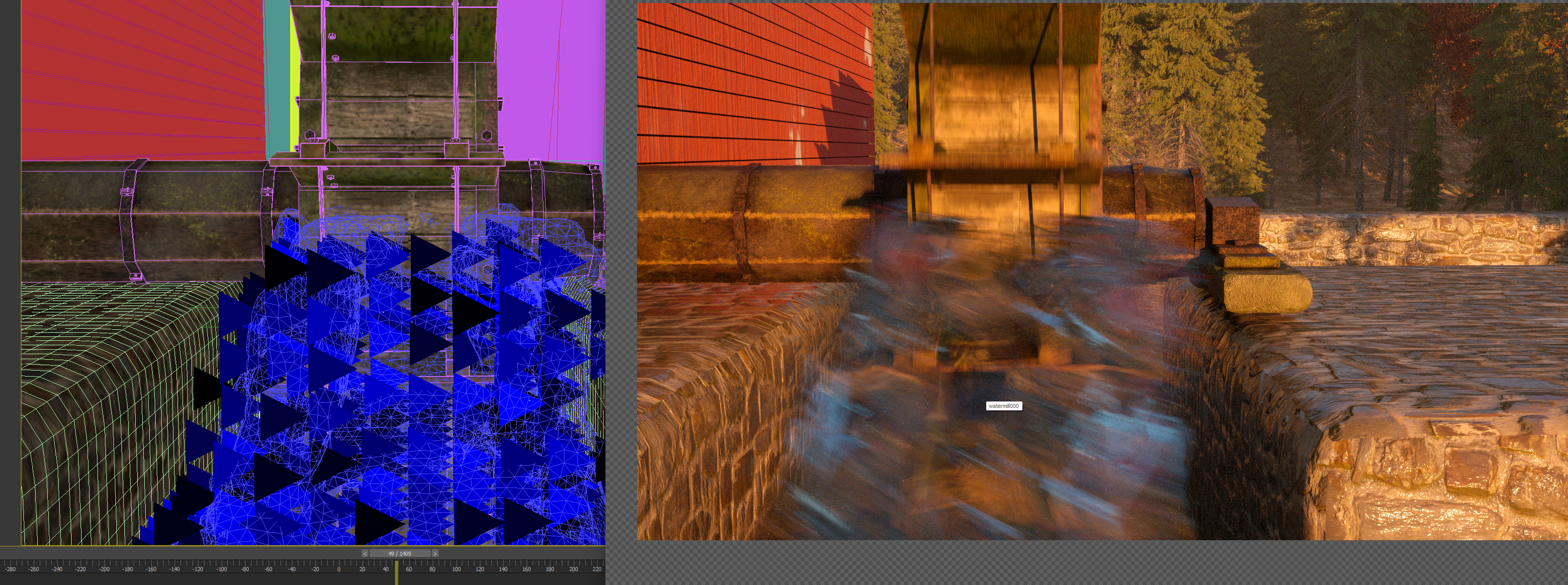

1. There is a bug with phoenix liquids motion blur direction. It goes diagonally and doesn't follow particle motion blur. I posted this problem before. It happened since you quit supporting phoenix vertex motion blur.

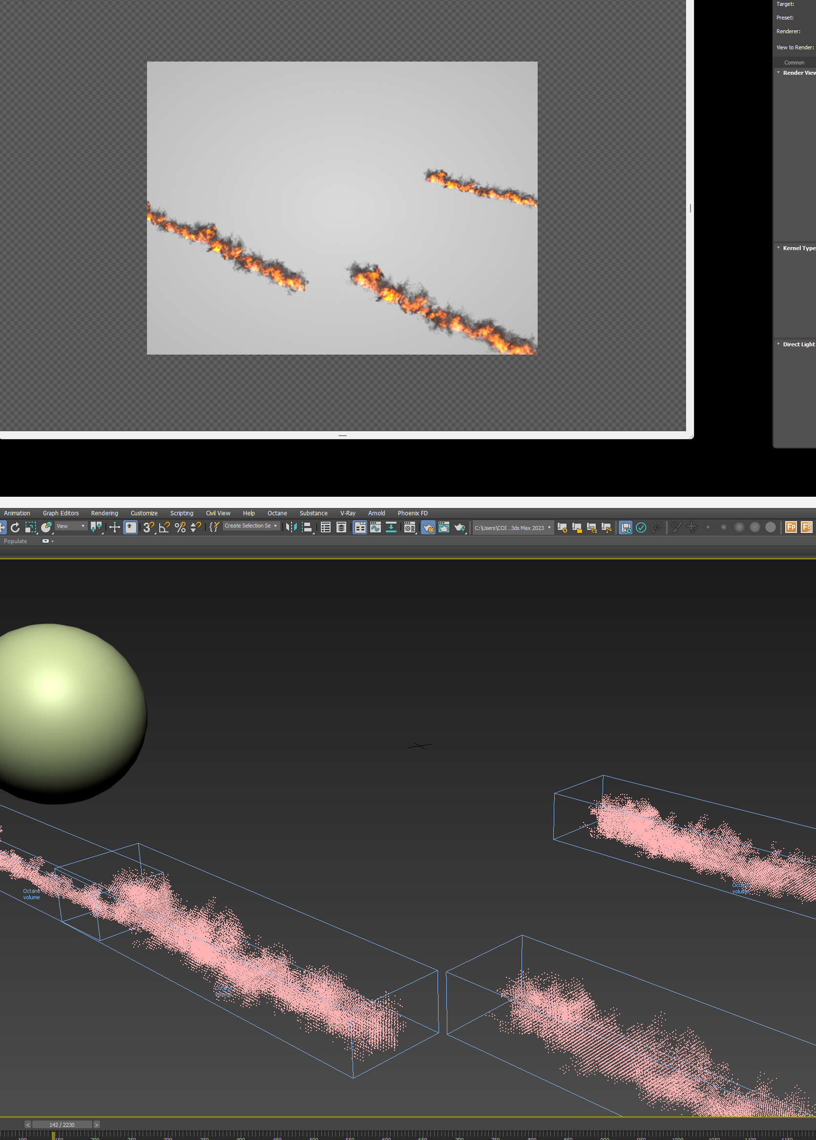

2. your phoenix octane particle modifier scale is way off. You need a half of a meter particle like a foam to look like it is 5 centimeters
In the image water falls down Thank you
