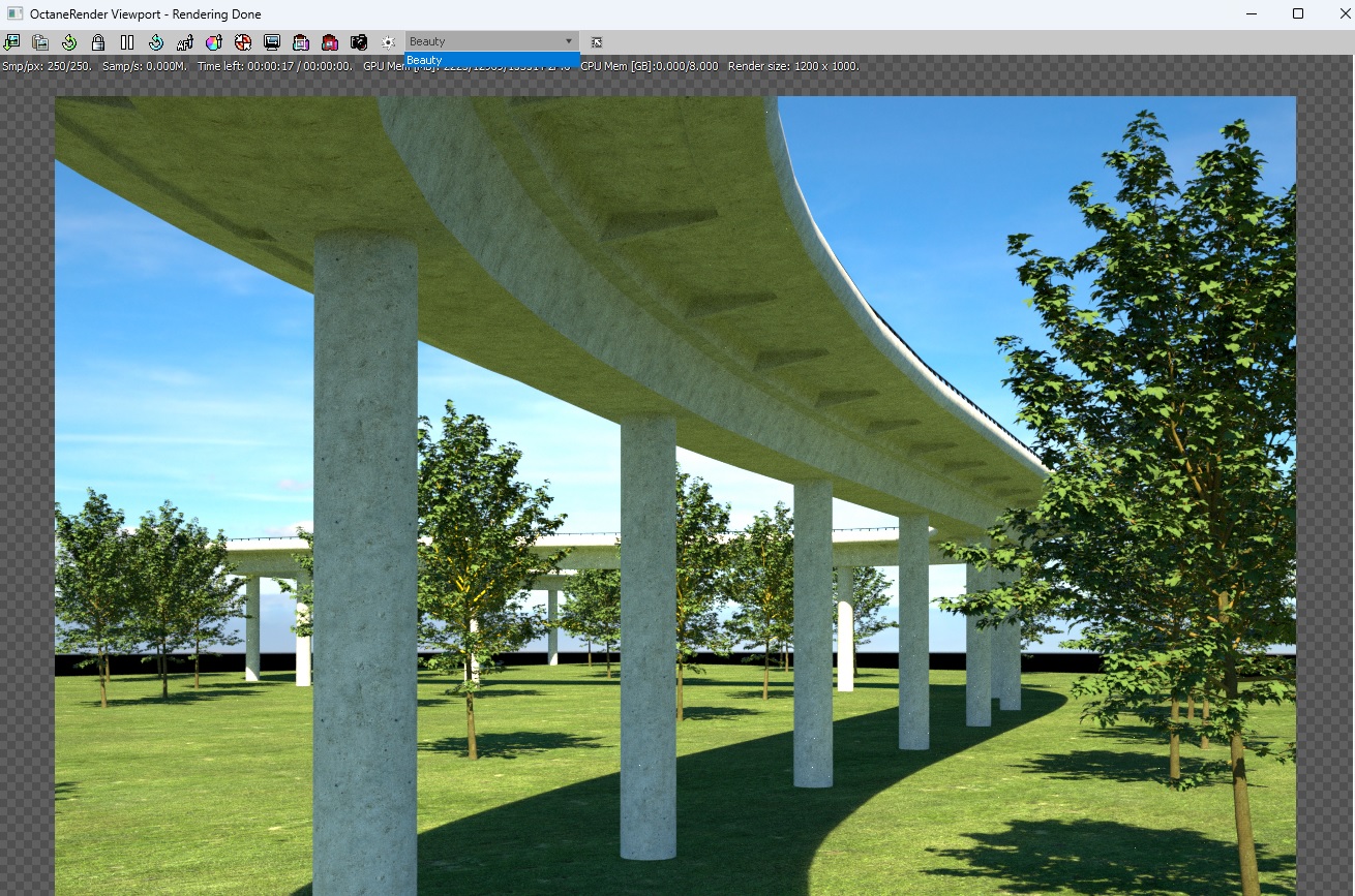

I have other problem with the version 13.16 I don't have the option Denoised_beauty and i would like to know why
Add picture of reference
Thank you OctaneRender team
OctaneRender® for 3ds max® v2022.1 - 13.16
I have same problems since two versions now. But devs can't reproduce the issue. You need to have octane render view open and then uncheck and check the "Enable Denoiser" checkbox. This will bring denoiser back. It don't happen when you use Production Render. Only with the interactive viewport.I have other problem with the version 13.16 I don't have the option Denoised_beauty and i would like to know why

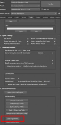

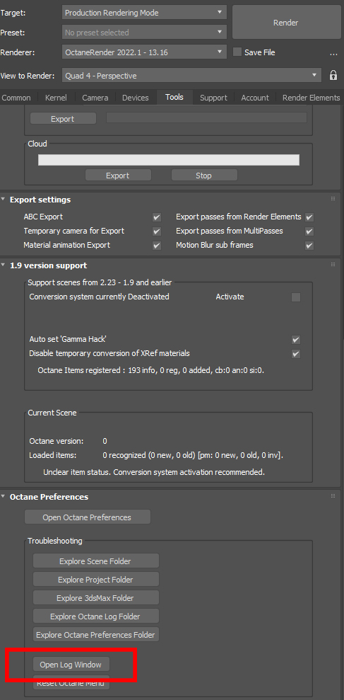

using denoiser makes a PC very slow and overuses CPU even denoise on completion. It was never like this in older octane versions
and errors especial when using a lot of reflections
Tried to access null node pin
Tried to access pin via an invalid ID P_REFLECTION (145)

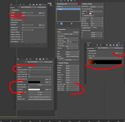

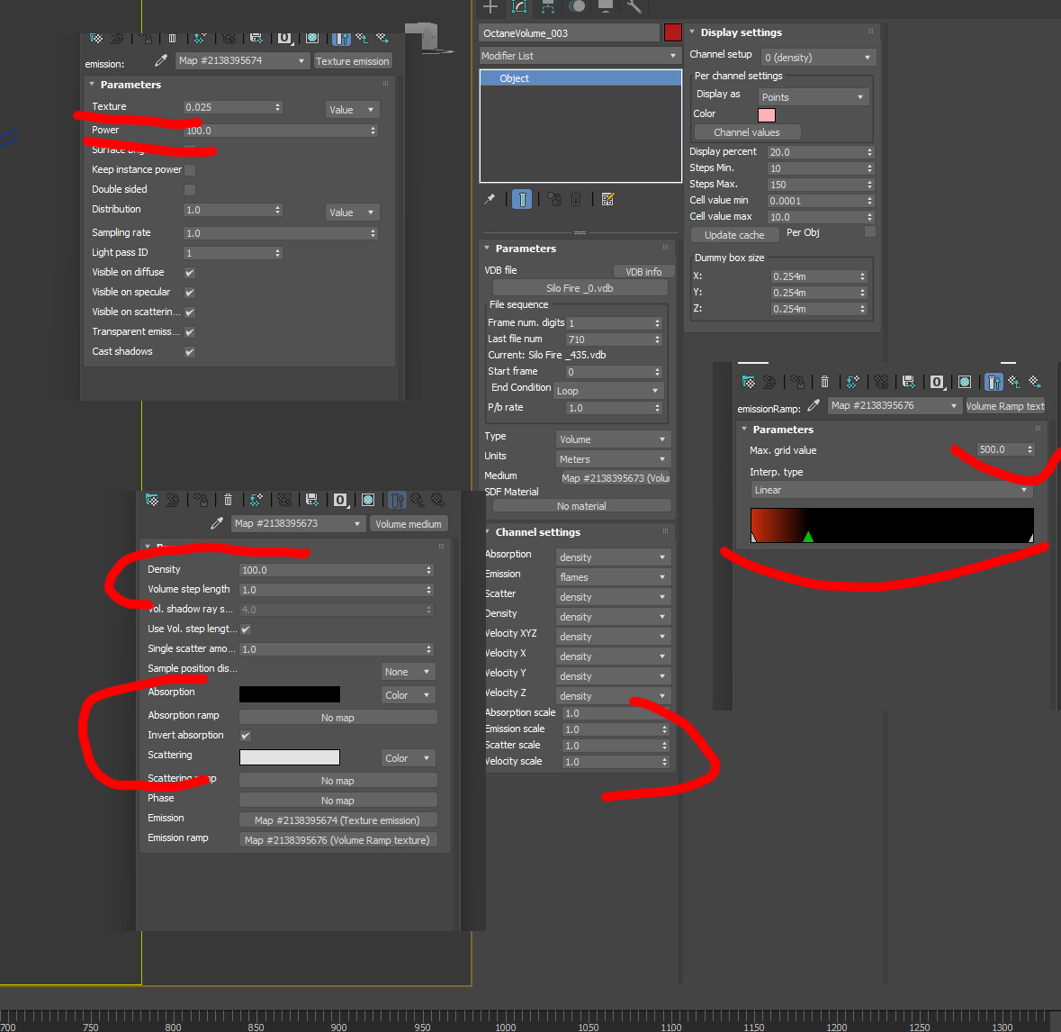

Hi Paride,
Can we please have a proper tutorial for using embergen vdb to setting up fire material in octane? Now, embergen has export for flames and temperature. What is the difference? thank you
There are so many similar settings by default in octane it is unbelievable and confusing. I think you should overhaul your approach to fire volumes and smoke. Too many buttons do the same. Please make shading as simple as embergen or add a button to auto match or auto-create quality flame. Thanks
