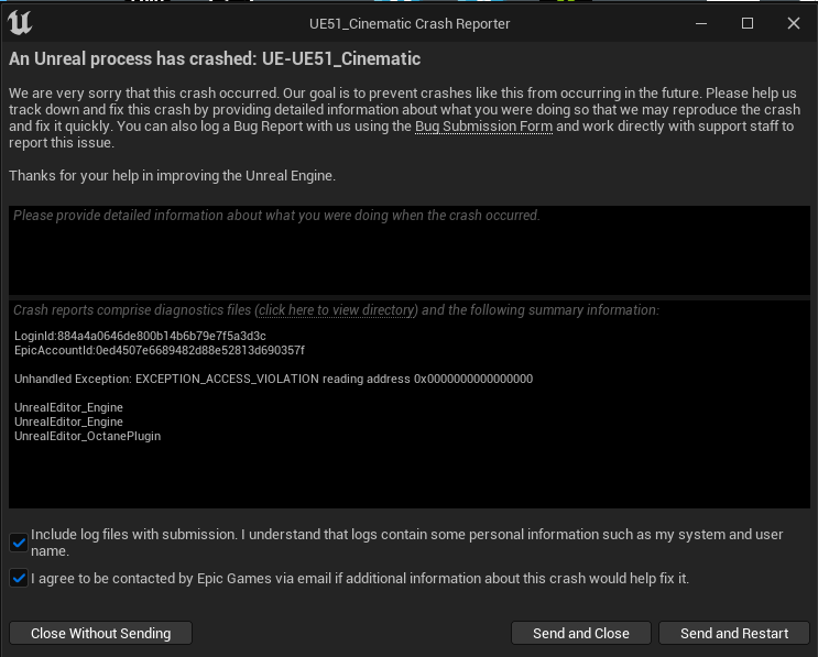

solomon wrote:Does it always crash on 5.1? Or specific scenes? I could not find the crash you are talking about.
Metahumans are not fully supported at the moment, and various materials might end up black.
crashes every single time, regardless of the scene
Once I click on the Render in the render target
What is your hardware situation? Windows version, GPUs?
Win 10, RTX 3090[/quote]
Thanks, ill try them.
That being said, ive uploaded a new version of the 0.59 plugin that works with the latest version of UE5.1, could you check if it still crashes?

Also crashing on Existing & New projects with 0.59 build on UE5.1
Octane didnt work on the preview 2 build either.
Windows 10 21H2 64bit (19044.2251) R9 5950x - RTX3090
Tested on latest Studio driver 526.98 and 522.30
UE error code:
Unhandled Exception: EXCEPTION_ACCESS_VIOLATION reading address 0x0000000000000000
UnrealEditor_Engine
UnrealEditor_Engine
UnrealEditor_OctanePlugin
Edit: Same build 0.59 loads without crashing with UE 5.0.3

Seems like a problem with SM6 and DX12. Loaded SM5 + DX11 on UE5.1 without same crash on Octane load.

VennardLWD wrote:Seems like a problem with SM6 and DX12. Loaded SM5 + DX11 on UE5.1 without same crash on Octane load.
Thanks found the issue due to your report.
Even with the new update, instant crash when Octane is loaded.

solomon wrote:
Ill try to releasea build with the fix tomorrow.

solomon wrote:
viewtopic.php?f=132&t=80799
This build fixed a hard crash that i think is the underlying cause of your crash.
