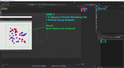

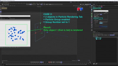

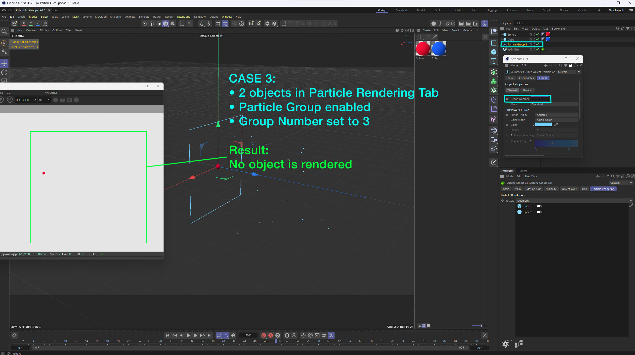

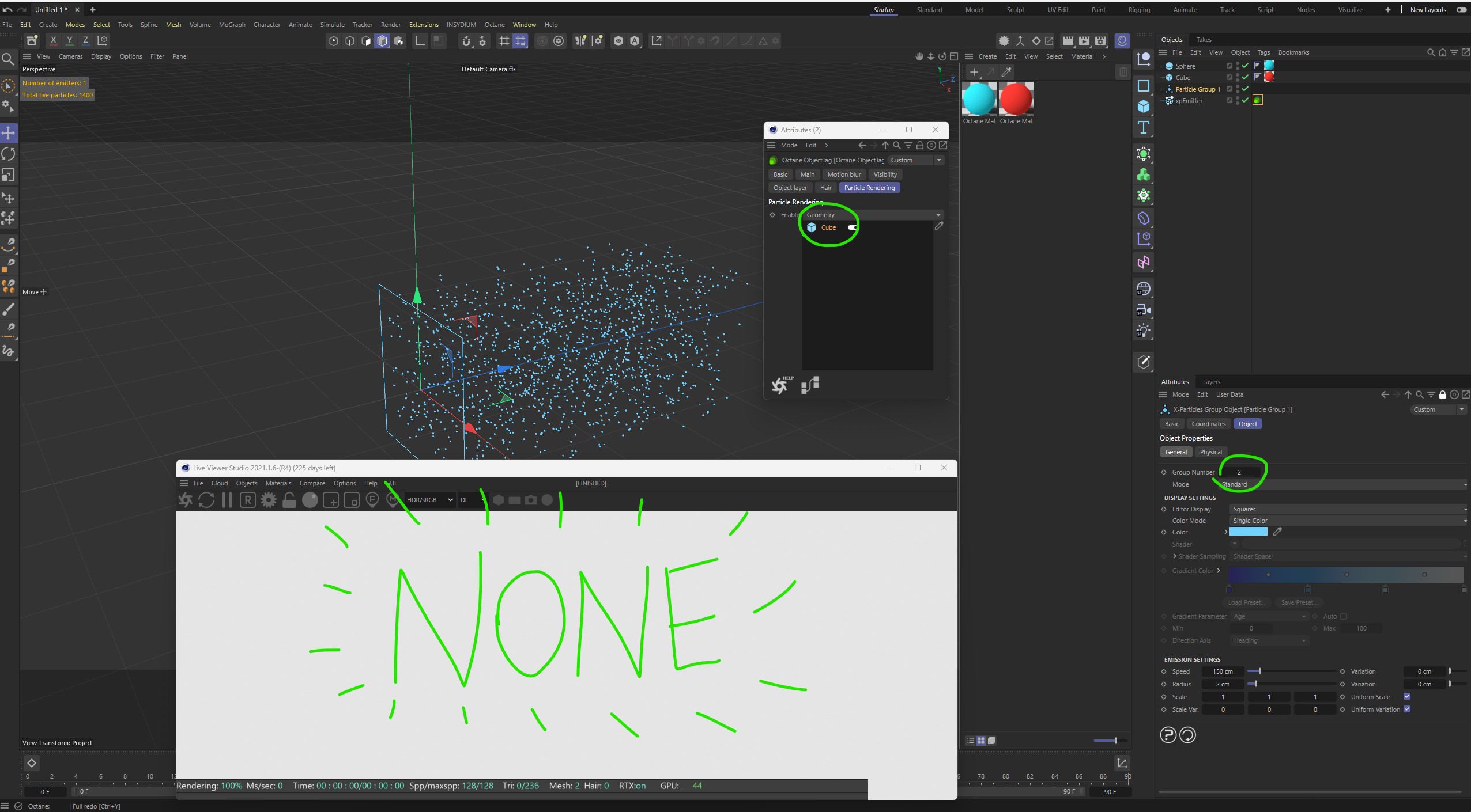

The problem is that in Octane 2020 you could just drop any objects in the "Particle Rendering" tab and they will all render normally, regardless of the "Group Number" of the X-Particles group.
In 2021 this is no longer possibile, since it renders ONLY the object corresponding to the Group Number in a list, as you can see in the attached image.
So if the Group Number is 2, and you have two objects in the Particle Rendering tab, it will only render the second object, and not both.
Likewise, if the Group Number is 2 and you have only one object Particle Rendering tab, it will render none.
This behavior leads to two major issue:
1- You can no longer render multiple objects in the same emitter using the Octane ObjectTab
2- More importantly, if you have several X-Particles Groups, you have to put in each Octane ObjectTab a number of objects corresponding to the X-Particles Group of that Emitter.
This is EXTREMELY frustrating, as it's really a pain to render objects when you have multiple X-Particles Groups.
This is obviously a new issue, as in Octane 2020 it didn't work like that. Are there any plans to fix it?
Thanks.

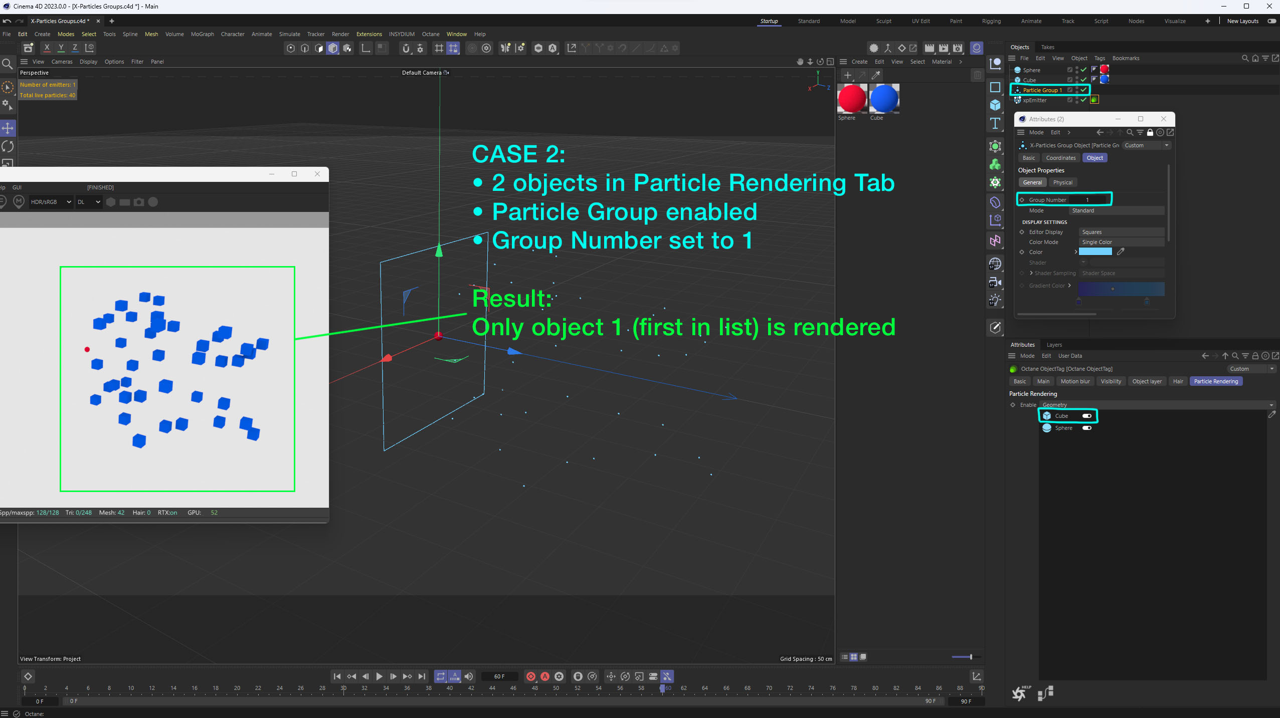

To summarize:

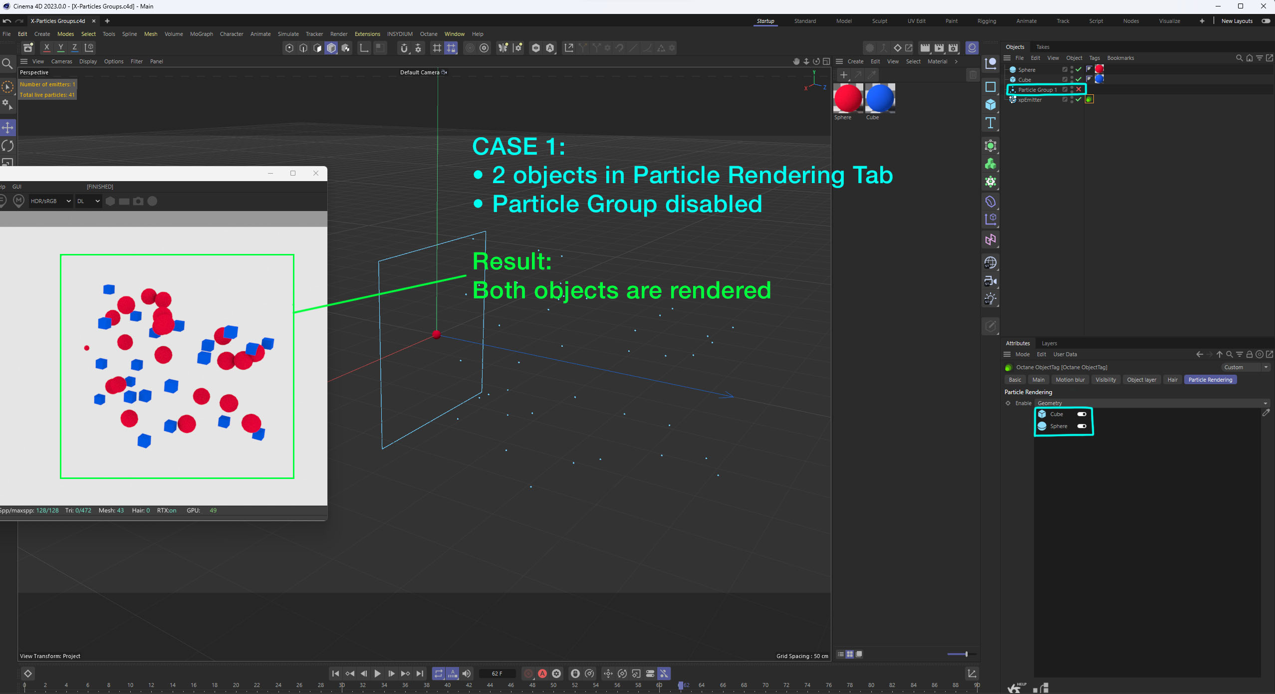

1. If you don't use X-Particles Groups, you can render how many objects you want in the Particle Rendering tab of the Octane ObjectTab.
2. If you do use X-Particles Group, it will only render the object in the Particle Rendering list corresponding to the Group Number.
Octane 2020 used to work as the first option, regardless of whether you were using Groups or not.
In the 2021 version, when using Groups you can't render more than one objects per emitter, and more importantly it's a pain to setup when you have multiple Emitters and multiple Groups.
Please see the attached images showing different cases. The first one is how it used to work with Groups in Octane 2020.
Yes, you can still render multiple objects using the Object Tag, but only if you're not using X-Particles Groups.
However, the issue here is specifically when you are using Groups.
I'm not quite sure what you mean by "closing the groups to use parameter" in the xpEmitter, but any solution that disable Groups won't solve the issue, because it defies the purpose of using Groups in particle simulations.
To summarize:

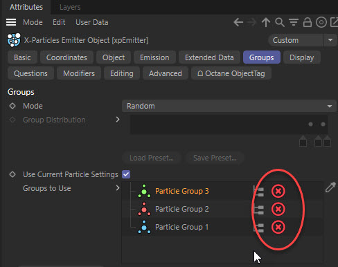

it will read the groupID and make the assignment when they have group numbers. Why don't you disable group items from this list? This will make groupID=-1 and will let you render multiple objects. What avoid it to do?

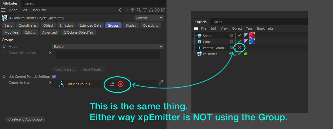

@Aoktar because disabling group items from the "Groups to Use" list, as you suggested, it's like disabling or deleting Groups entirely, therefore is not a solution.
If you disable a Group from that list, you're just telling the xpEmitter NOT to use that Group, which defies the purpose of using Groups at all.
For example, if you have a modifier that affects all the xpEmitters assigned to a particular Group, and you disable that Group from the "Groups to Use" list in the xpEmitter, that xpEmitter won't be affected by that modifier anymore.
