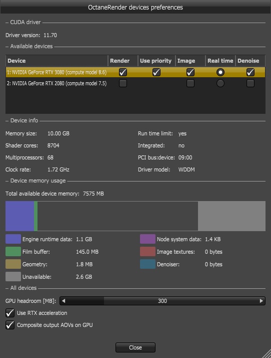

I am experiencing this bug as well (with the last Octane 2021 build). Sometimes the partially baked frames are 2 frames apart, other times they're 20 frames apart. Increasing samples per pixel to around 900 doesn't help.
I have both a 2080 and 3080 to render with (the 2080 also drives my display). After some testing it seems checking the "image" box in render devices for the 3080 will cause this bug to occur.
If I have the image box checked ONLY for the 2080 the bug does not seem to occur. So, there is that. While this is a work-around (for me, at least), it's not ideal, as I prefer to render only with the 3080, leaving the 2080 for display purposes.
Update: After updating to Octane 2022 the problem is worse and happens on every 2nd frame now no matter how I set up my render devices, so my work-around no longer works-around.

Hi
I still cannot replicate this issue. Can you please send a screenshot of your device preferences (by clicking on the Open Device Settings button on the Render Devices tab of the plugin.

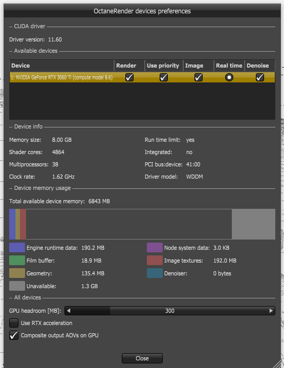

I used RTX acceleration on and off.face_off wrote:Hi
Paul
Same results.

face_off wrote:Hi
Paul
When I turn off RTX Acceleration the bad frames go from every second frame to about 3 bad frames out of 30.
