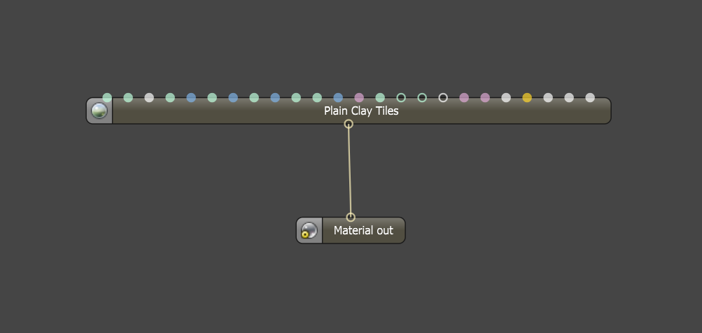

2. i tried to export some Octane materials from MODO to use in Archicad but neither of the formats available when exporting seem to work. Depending on which database i choose AC either asks for a .ocm file or a .orbx file. AFAICT i can't export .ocm from MODO and the .orbx that i exported gives this error message when i try to import into the AC scene
Open the ORBX file in Octane Standalone, and plug the Material node into a Material Out node, so the ArchiCAD plugin knows which material node it use.

face_off wrote:Open the ORBX file in Octane Standalone, and plug the Material node into a Material Out node, so the ArchiCAD plugin knows which material node it use.
looks like the material is already plugged into a Material Out node, but still get the same error in AC

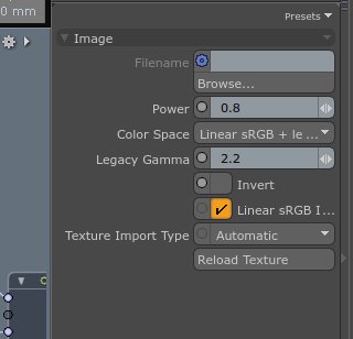

On a Linux, I am not getting options for texture repeating. Modo 16.0v3 and latest Octane. Tried reseting preferences too.
