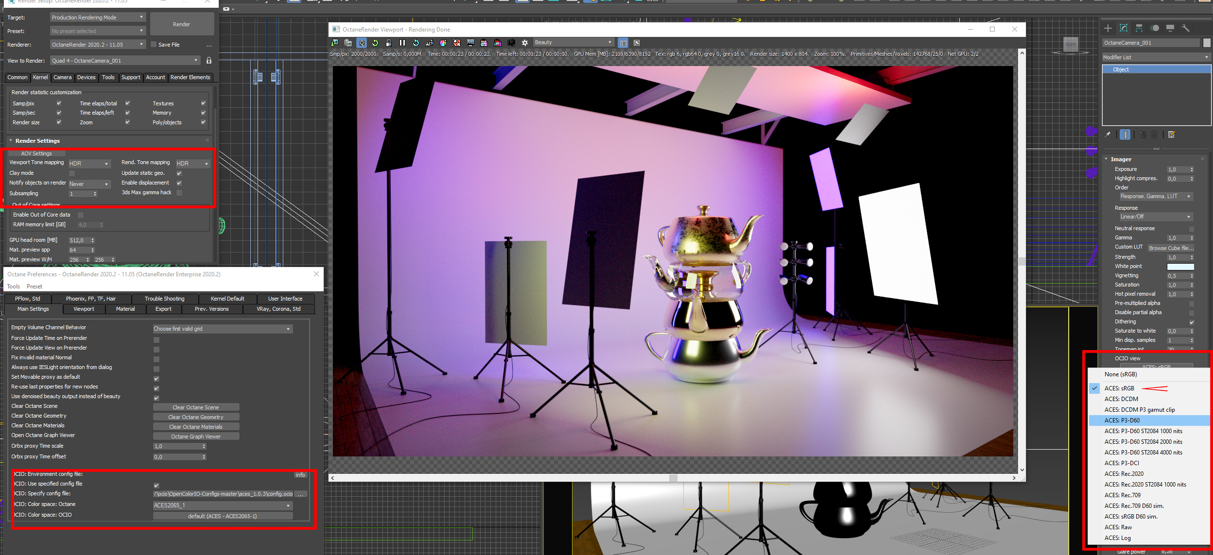

I been downloaded and I'll put the rute like image, in System/environment...\config.ocio.
I been selected the camera and change in Ocio view for ACES: sRGB.
In Octane Preferences Main Settings OCIO: Specify config file and I been selected the rute writing at end \config.ocio.

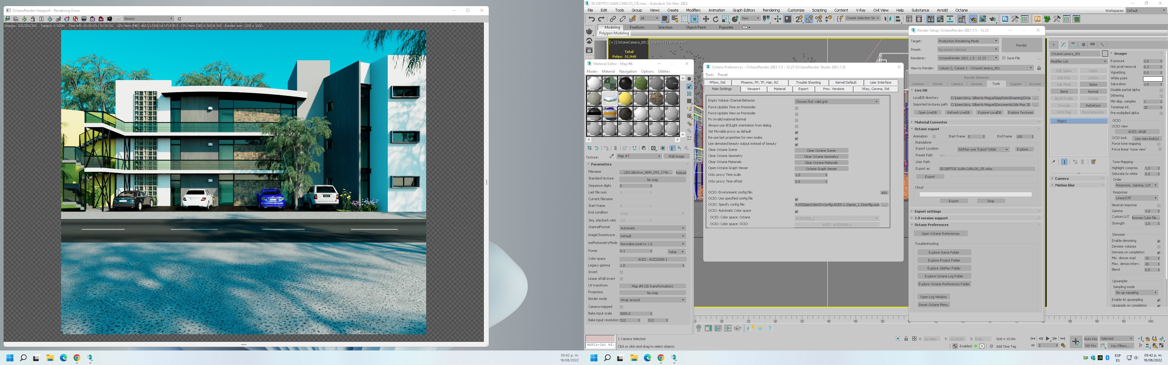

I been selected in the RGB image Color space ACES-ACES2065-1 and looks all blue, I don't know what i can do wrong following the steps like the link in you asnwer.

Hi merid888,
please share your issued scene (in pm if you want), I'll look into it.
3ds Max > File > Archive
