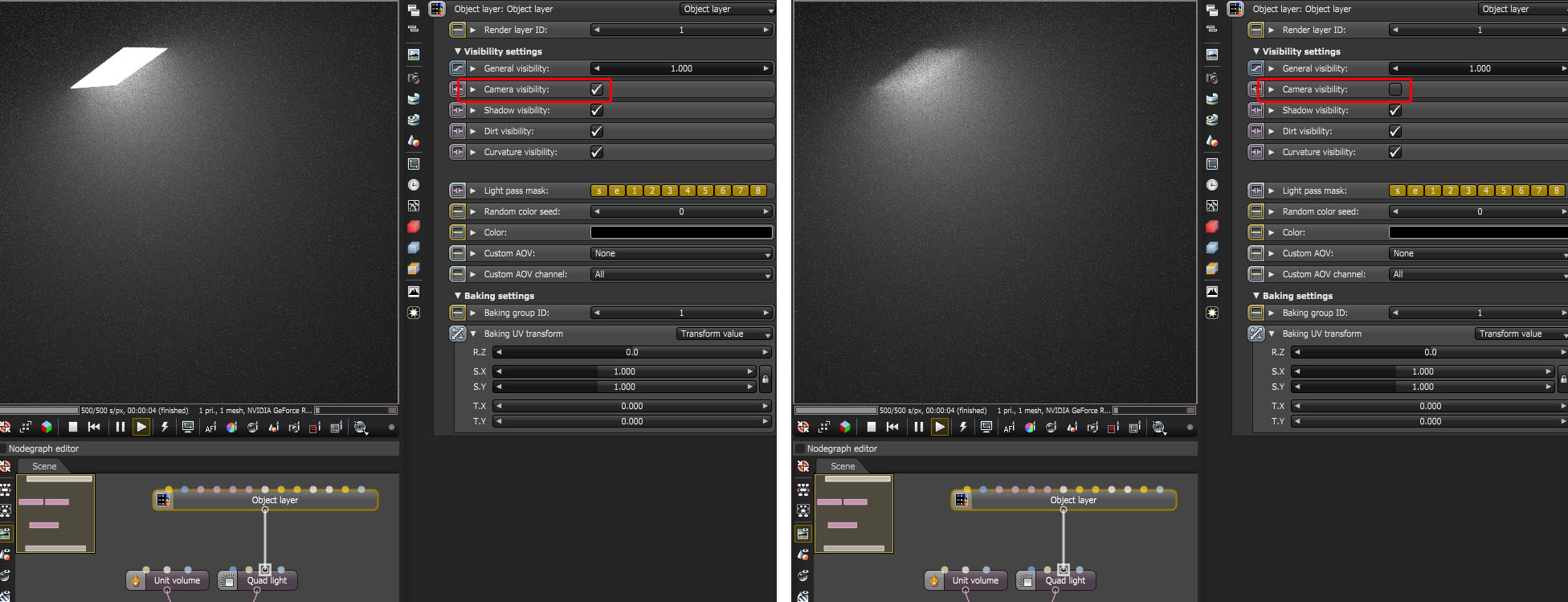

Yes, ok that was a little bit misleading. I mean i want to make the lightsource unvisible to the camera. The lightbeam should stay though

Yes, that's my whole pointelsksa wrote:Did you try one of these two options? Any light > Object Layer (properties)
General or Camera visibility.
I tried a quick test and camera/general visibility seem to be hiding the light geometry as expected, although you can still see the light affecting the volume.Hesekiel2517 wrote:Works really great! I noticed one thing. If a light is inside a volume turning off the lightsource itself is not possible. You can work around this by creating a bubble around your light with the same material as the volume and inverted normals.
Can you attach or PM me the scene, so we can see exactly what you're doing? Please include the problem and your solution.

Hey there,
i tried it again and suddenly it works. Very strange, but cool! I'm sorry, that I bothered you!
