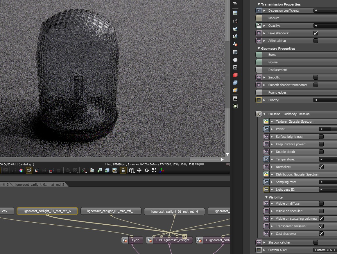

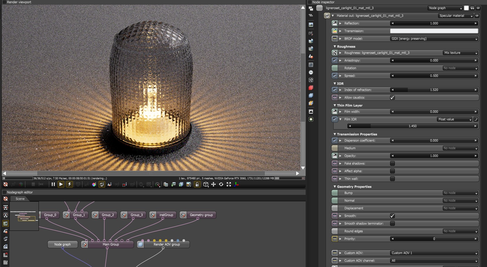

Amazing release so far.
Something I noticed:
light materials options such as "Visible on diffuse" and "Visible on Specular" are not working when a specular material is set ON with "Allow Caustics".
Maybe we need more options or an improved "Ray switch" node?
Regards,
Caustics OFF respond correctly to light restrictions
Caustics ON ignore light restrictions
The ray switch node has a new option for "Photon ray", see if this could help.
Kalua
Posts: 559
Location: Caribbean Sea
Thanks for the heads-up. I see now.
I will give it a try when Aoktar implements it on C4D plugin side.
