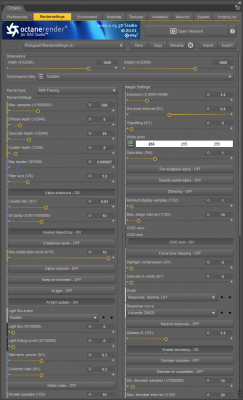

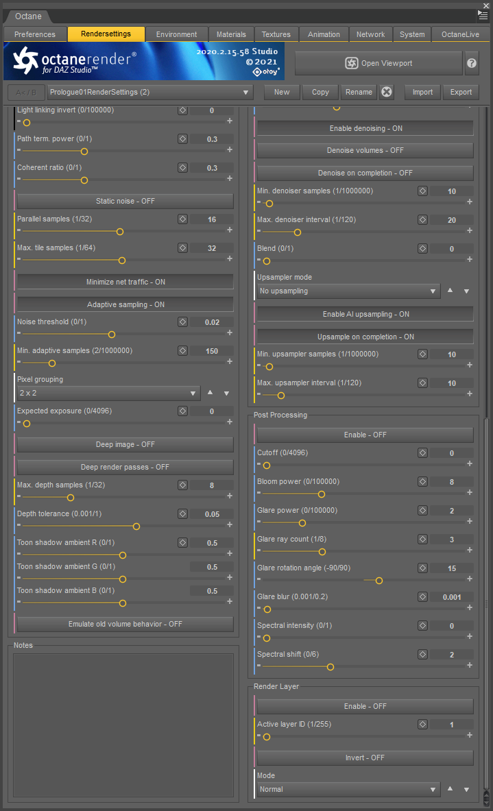

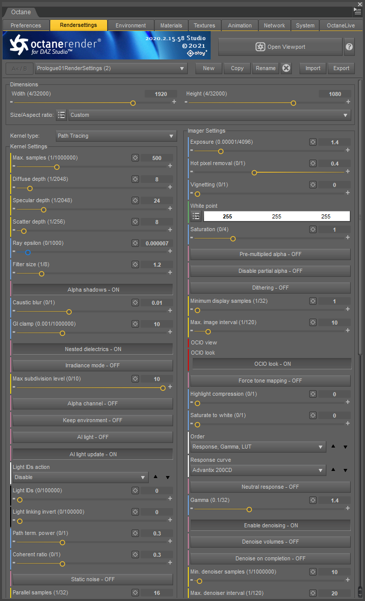

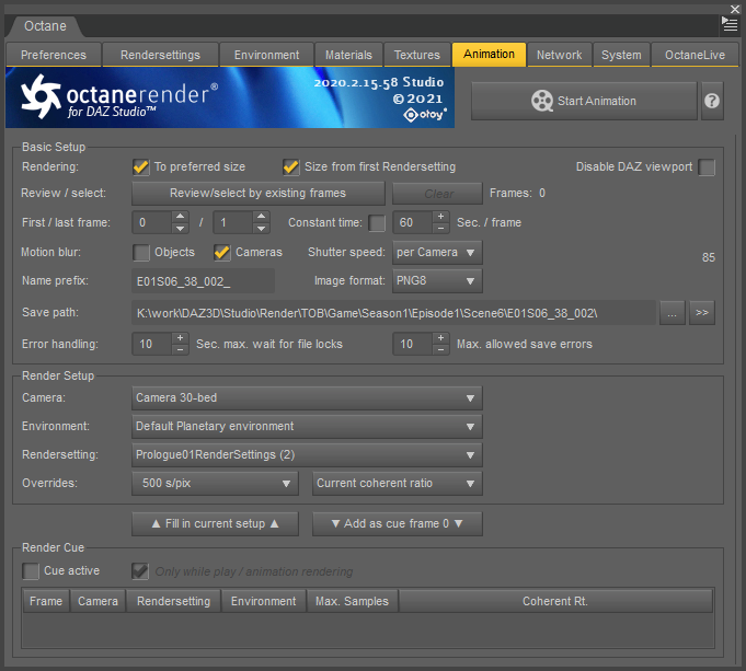

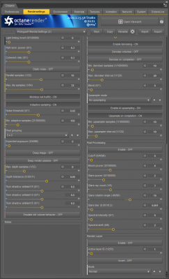

Hey BK,
I just tested and unfortunately removing the settings didn't solve the issue.
Here is the animation settings tab
Bottom part of the Render Settings pane
Render settings tab
Top part of the Render Settings pane
BK
Posts: 1539
Hey BK,
Render settings tab
Hi sudisk,
Thank you so much for the screenshots.
Would you please PM me the rendered images one from still and the animation?
cheers
Kind Regards
bk3d
