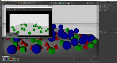

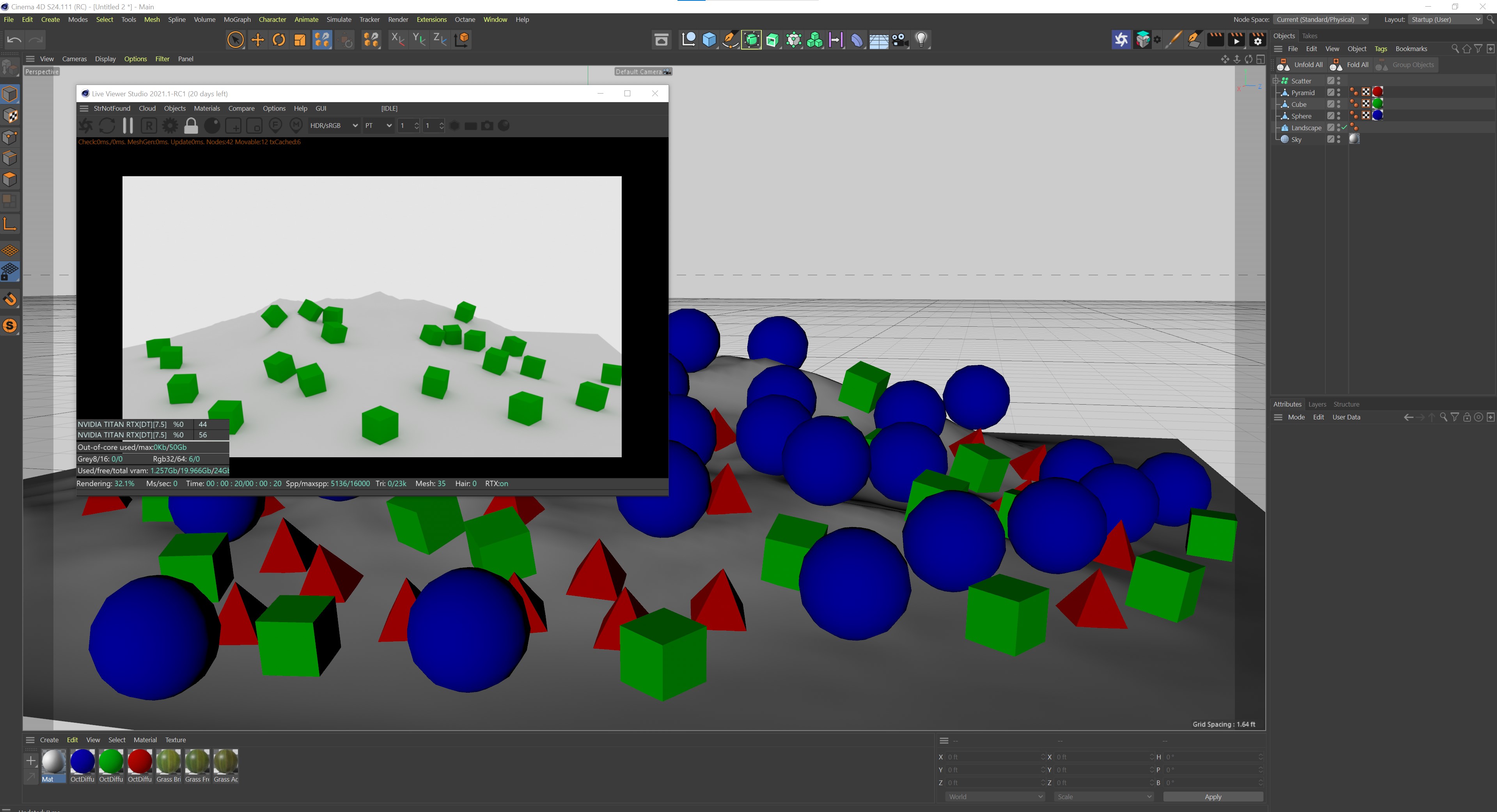

Octane doesn't render multiple scatter objects when using C4D's new Scatter Pen in S24 (selecting and scattering multiple objects with one pen).
It seems that only one object will render. The C4D native renderer renders all the objects.
I am using the latest S24.111 release.

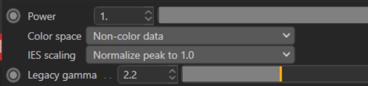

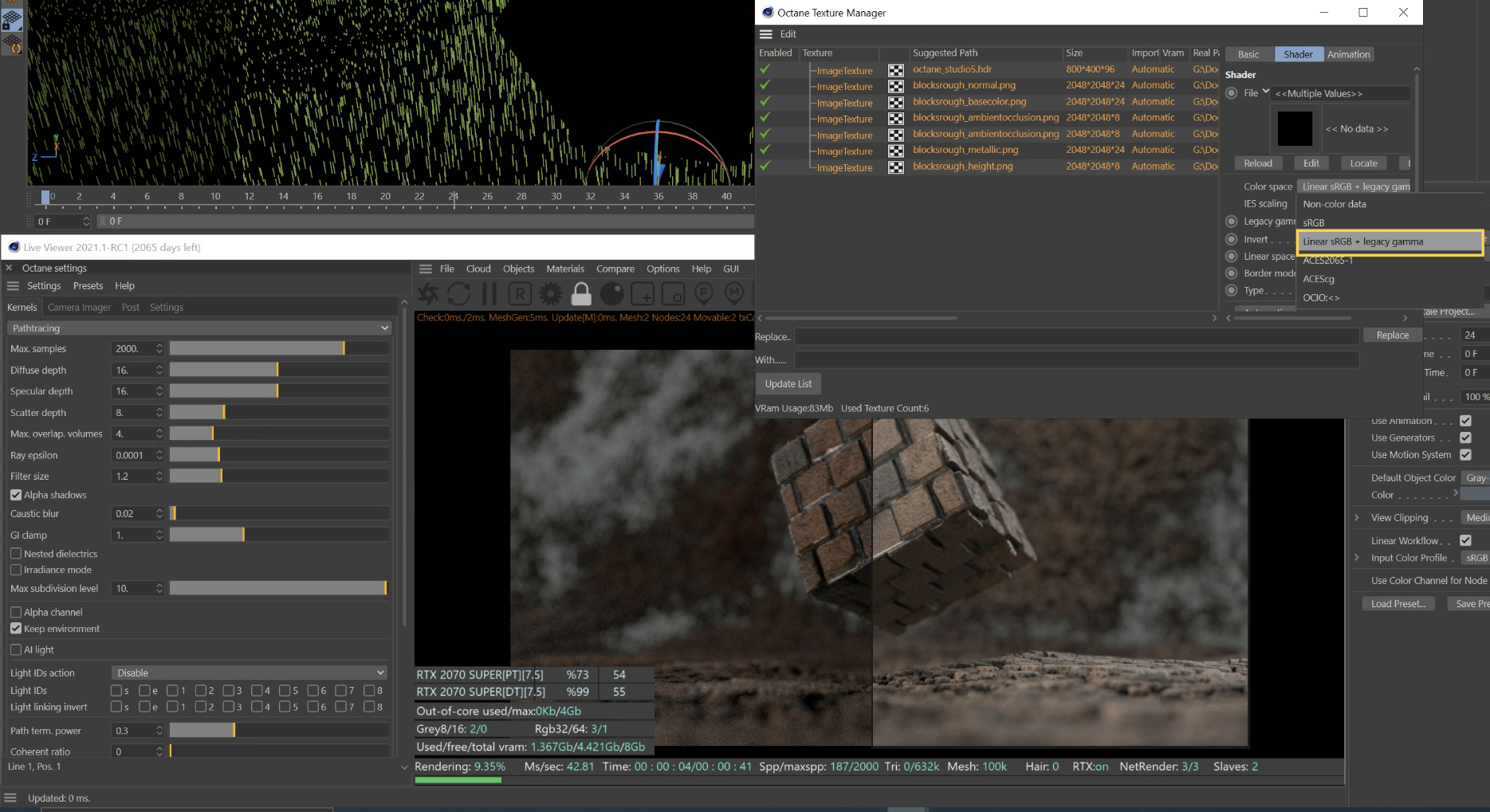

What does any of this mean? Some of my textures from old scenes look completely different.
Edit: maybe consider leaving this option on "Linear sRGB + Legacy gamma" by default for the final release. Had to switch all my imageTexture nodes one by one to match the look of my old renders.
Posts: 10633
Hi feels,
you can change the Color Space of all the textures in the scene at once, by using the Octane Texture Manager panel:
ciao Beppe
