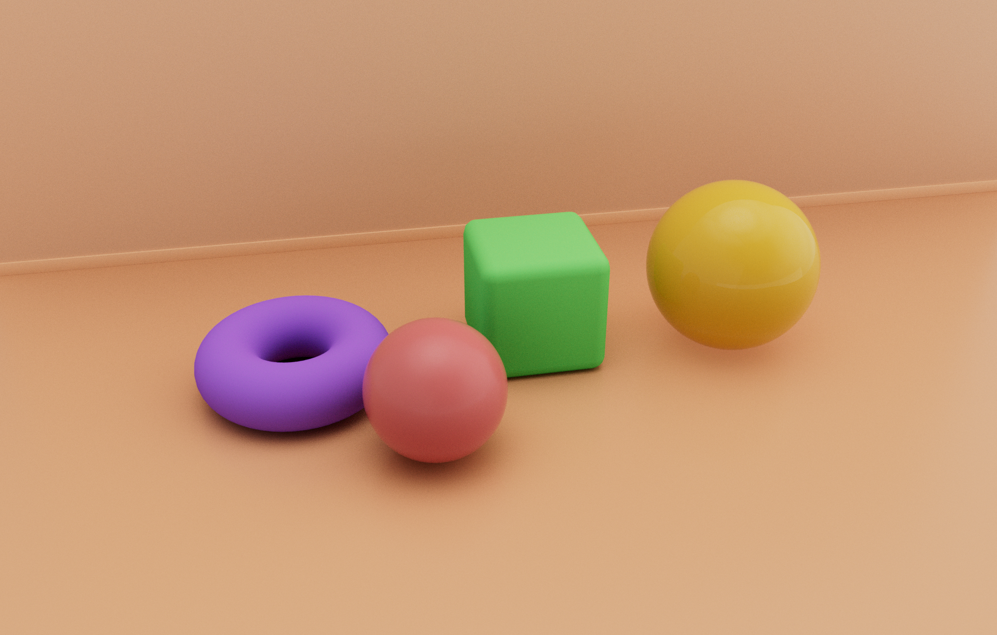

Here are two results:
(I didn't want to share small renders)
RenderOutput_16Bit_OCIO_sRgb_HDR32 Buffer Type
LV_output_16Bit_OCIO_sRgb
I think there is a small light difference between 2 but current output can be handled by post and I should test and check other things as well.
Posts: 16068
Location: Türkiye
I can't see any significant changes. It should be ok if my eyes/monitor is not capable to capture/show this small difference.
