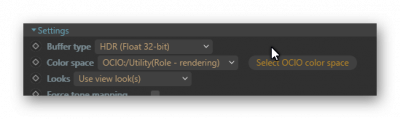

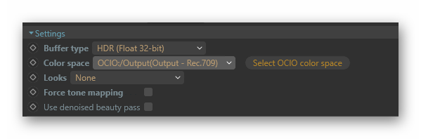

At the end I found that this workflow works :

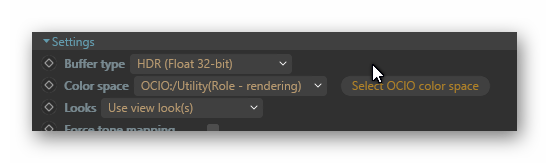

Render as OCIO for camera preview as ACES Rec.709 :

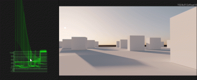

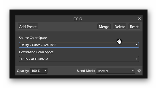

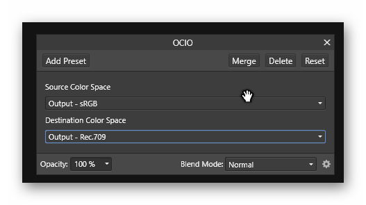

But in compositing software there is need to do some OCIO conversions. For example in Affinity Photo which support OCIO there is need to apply three OCIO adjustment layers :
First:
Second :
Third :

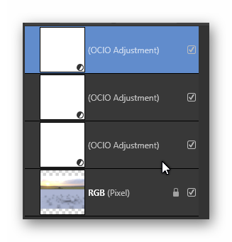

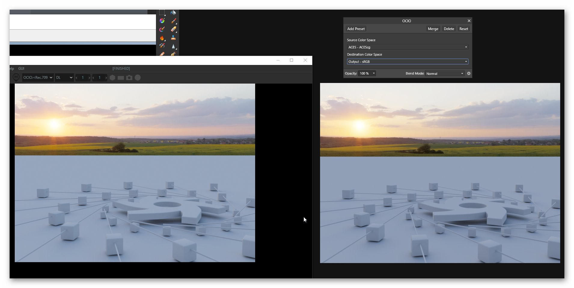

Like this :
Screen_niedziela, 26 września 2021_22h02m41s_004_.png (15.73 KiB) Viewed 4863 times

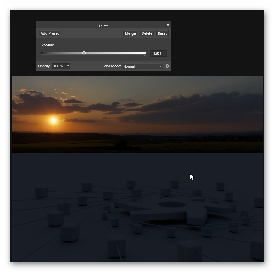

And 32bit Exposure for ACES REC 709 works fine :
It works for any custom ACES profile like ACES P3-D60, Rec2020 etc but the only needs is to change second OCIO adjusmtent layer for proper profile value.
