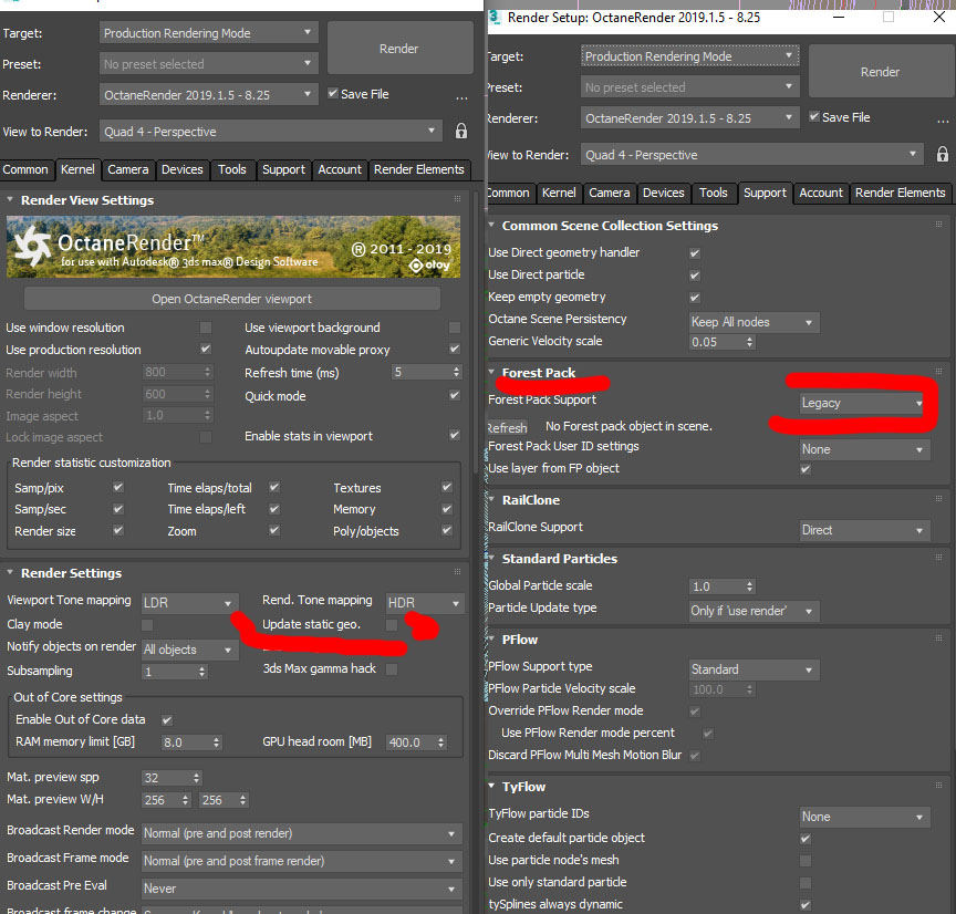

Turn off UPDATE STATIC GEOMETRY and set itoo forest render mode to legacy if you use one. All animated objects must be set to movable proxies. Next frame should take 1-2 sec to evaluate

You may note from the video I posted in the thread I already have static geo off for the rendering.
As for the forest pack objects, using legacy doesn't update forest animation, so that's no use to me. Basically I have an effect where a road is appearing in the middle of the fields gradually, which means I have to gradually make the forest pack object occupying that patch disappear. So far my tests with legacy forest pack have lead to animation not updating, though I suppose there might be another brute force setting for that(like octane scene persistency set to clear all nodes on render, or broadcast render frame change, or w/e).
Point is that this isn't the first time I've hit this brick wall with forest pack, and I'd like to know what causes that. Is it when forest pack has too many objects? Is it when there are too many forest packs within a scene? Is it if a forest pack is getting loaded in from an external file?
