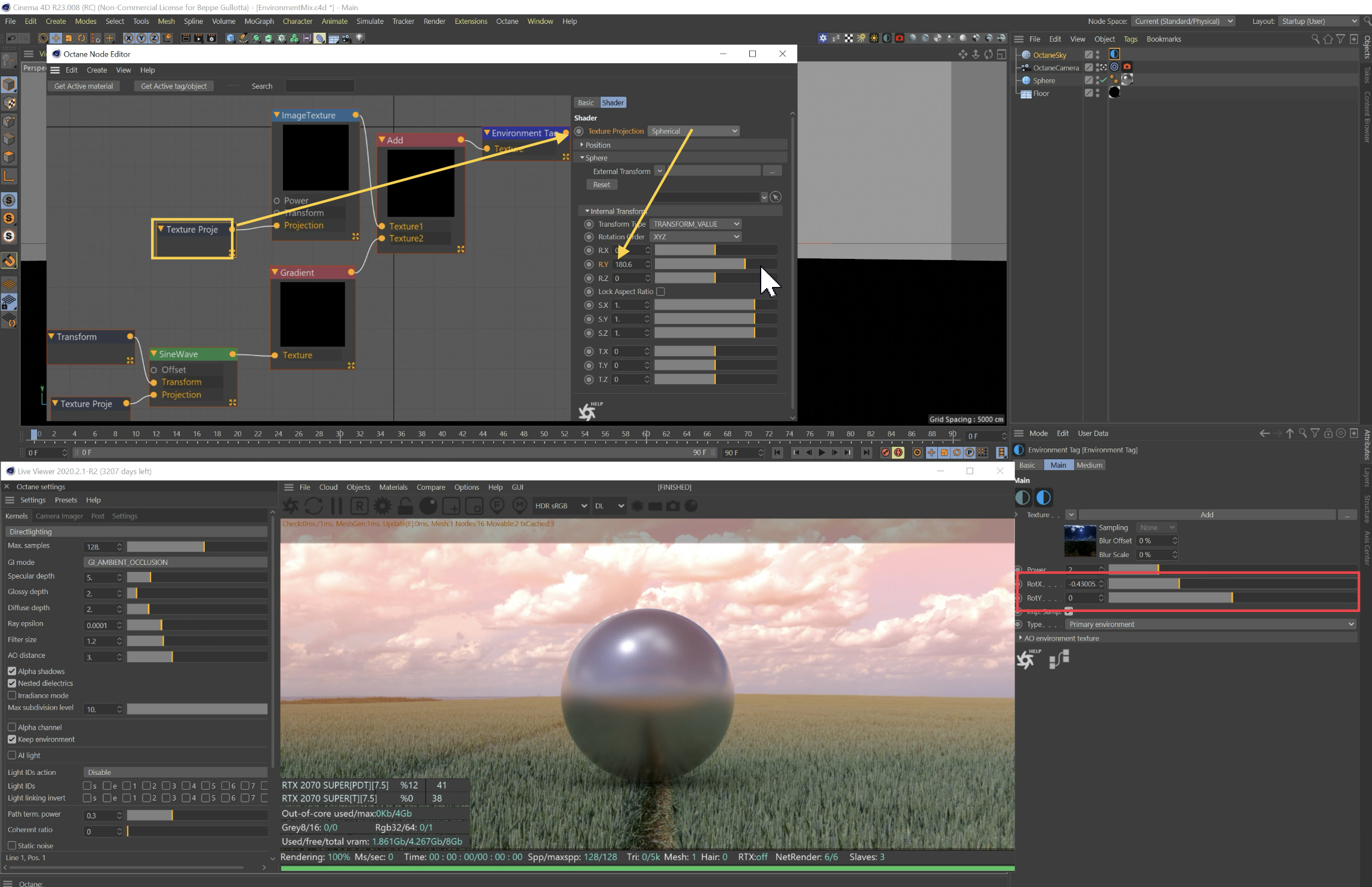

A late reply, but this was annoying me and this thread is the first result in google, so figured I'd throw the answer here:
Create a null
Place the null inside the octane sky
Select the octane environment tag on the sky object
Add the hdr you want to use to the texture slot
Click the node icon at the bottom to open the node graph
select the image texture node
click the projection button to add a projection node
Change this from uv to spherical
You should see there is a blank untitled link field on the projection node's settings. Drag and drop your null object into this box. You can now rotate the null object inside the sky in 3D. You must always keep the sky object zero'd out or it breaks. It should end up looking like this:
