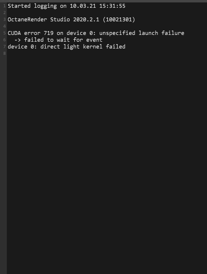

Greggers wrote:Im still getting problems trying to render with toon lights or materials in cinema r21 (latest plugin) and octane latest. Is anyone else having this issue?
Im on win10 1080ti incase this info is needed.
what's latest? this build?
Greggers
Posts: 149
Joined: Wed Feb 15, 2017 9:51 pm
yes mate. This build and the previous.
Im getting this error -

Hi Greggers,
yes confirmed, Toon material is giving CUDA error 719 in 2020.2.1.
We are investigating the issue, in the merantime, please go back to 2020.2-RC6 for scenes with Toon material:
viewtopic.php?f=85&t=76633

Greggers
Posts: 149
bepeg4d wrote:Hi Greggers,
ciao Beppe
Thanks bepeg4d
I can use the Blender Studio (v 23.1) for now as that works. Soon as the C4D version is fixed I will jump in there.
