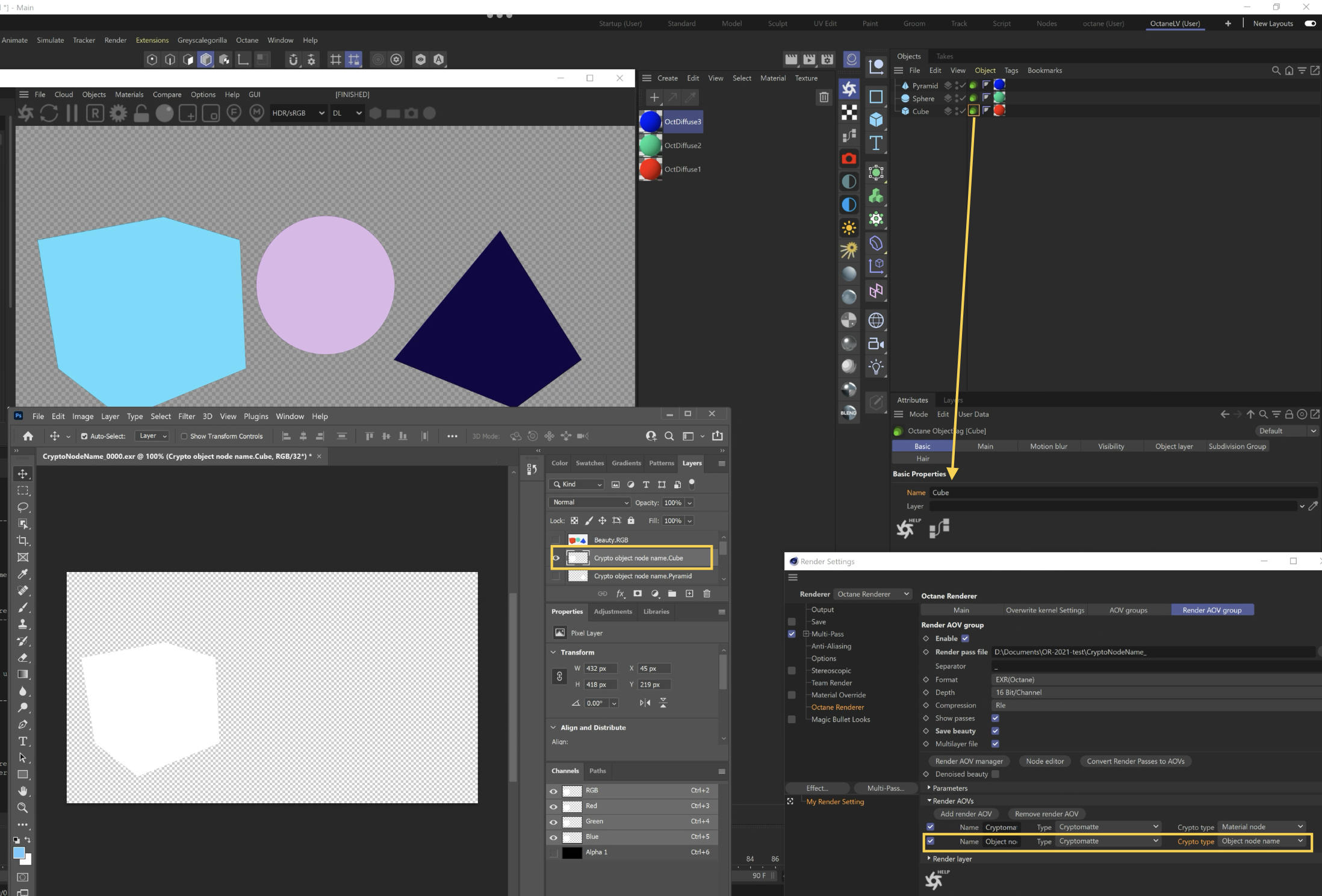

Hi Marc,
just assign an Octane Object tag to the desired object, or group of objects, then change the Name in the Basic tab, and enable the Cryptomatte Object Node Name AOV:
ciao,
Beppe

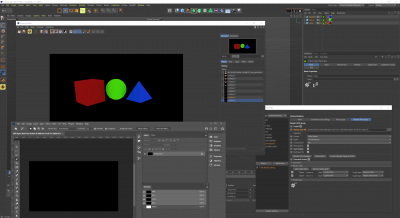

Hi, I'm having some trouble getting the cryptomattes to come out in the new AOV system. I've followed (I think) the steps laid out here. I created a file that matches the example file that you created. I have specified the Render Pass File as the attached image shows. But Live Viewer does not create this file when I render. Render to Picture Viewer creates the Render Pass file EXR but it only has a solid black image with no layers. Here's the Export Log after Render to Live Viewer:

Render to Picture Viewer creates the Render Pass File but it has no content
The photoshop file name is different from the Render Pass File because Live Viewer did not create a Render Pass File

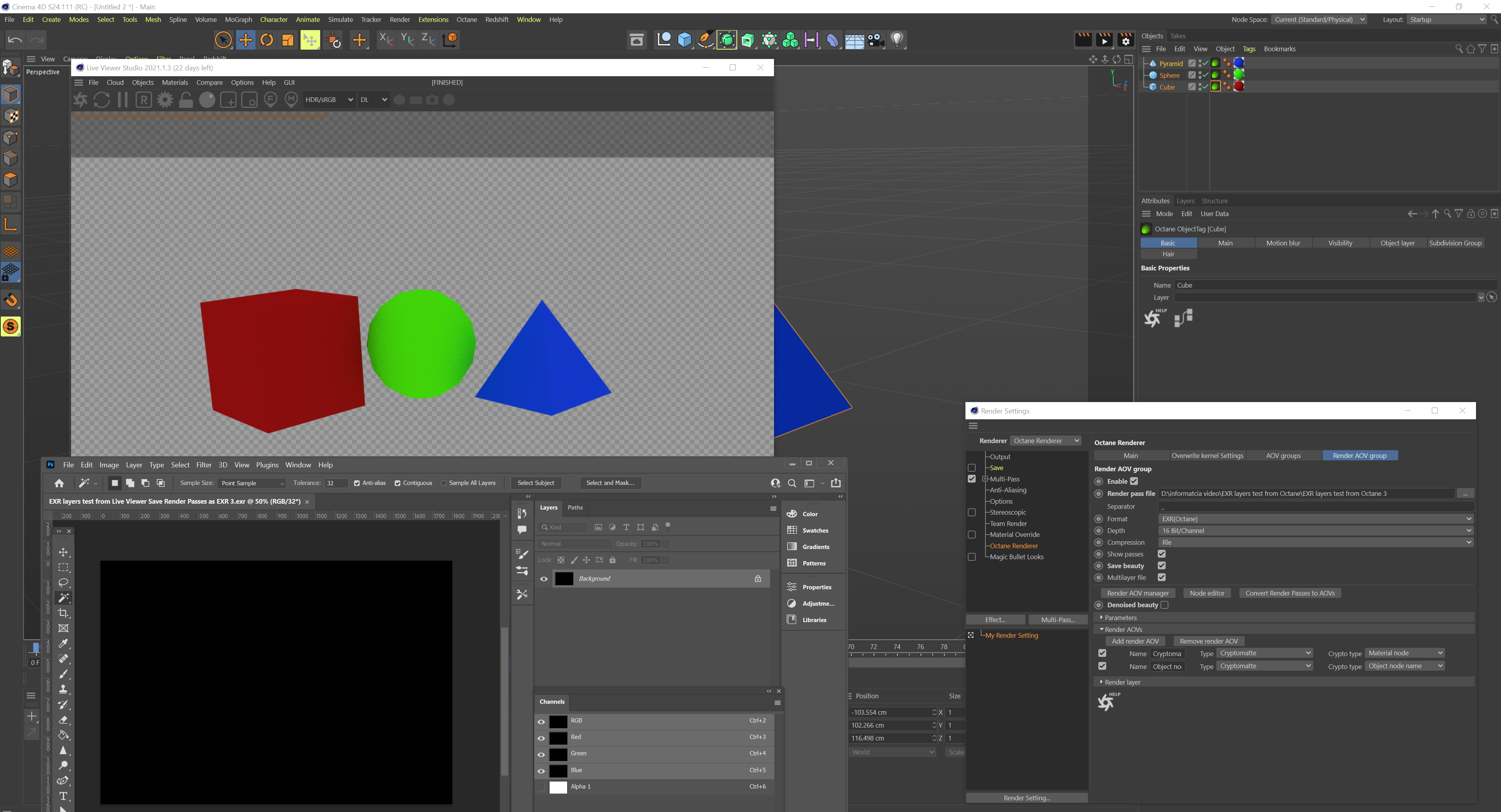

UPDATE: thanks to Zoppo for this tip. The Render Pass file created by "Render to Picture Viewer" needs to opened by the Exr-IO plugin in Photoshop. Downloaded from:
https://www.exr-io.com/
Photoshop does not have native EXR support and the OTOY Compositing Plugin available on from Adobe Plugins does not show the Cryptomatte named nodes (layer masks).
My only remaining issue is that I can't get Live Viewer to create this Render Pass File as implied in Beppe's post above. But at least this is a way to get the layer masks.

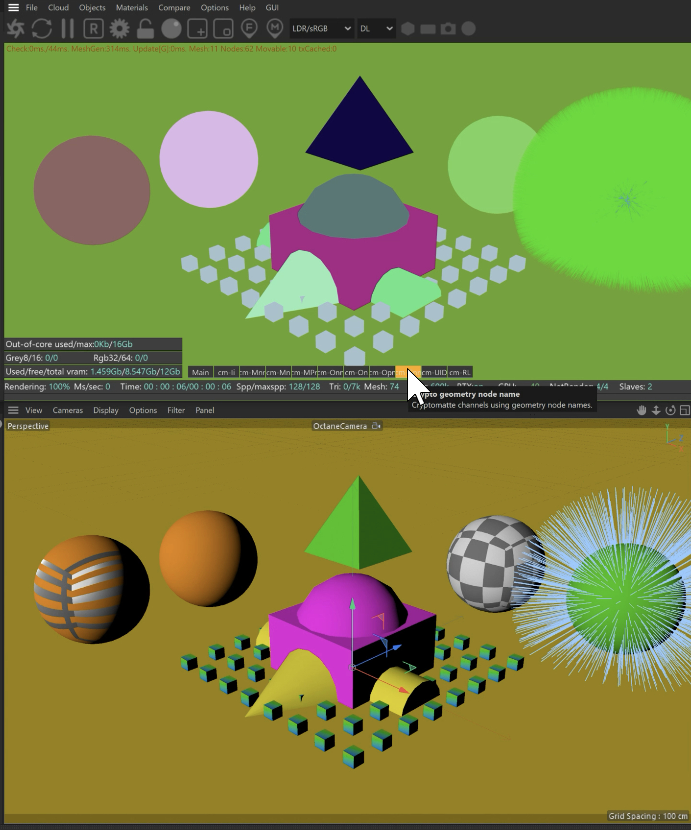

Hi Orion,
not sure to have understood your issue correctly, but in Live View you can only see one render pass/AOV per Cryptomatte type, with different solid colors to display the type of masks that will be generated.
Here is the Geometry node name, for example:
And here is the Material Pin Name:

Beppe, thank you for your reply and for including some pictures. I didn't know that those on-screen buttons you show in the pictures were the on-screen node selections for Live Viewer but it makes sense and I really like that functionality.
My issue was that I expected that clicking Render in the Live Viewer would create the file I had specified in the Render Pass File Octane Render settings. As far as I can tell it does not create that file. But using the Live Viewer/File/Save Render Passes as EXR does create a layered file that has the masks set up by Cryptomatte node Object Name. I just needed the EXR-IO plugin to actually see those mask layers.
