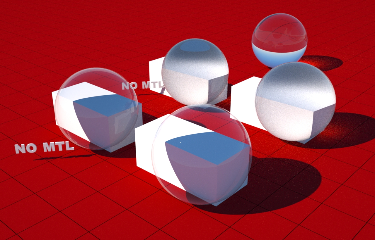

Hi Paride, your mesh on the right is cut because specular material has priority of 1. ( not the case with 0 )
Another question is why spec material is blurred ???

Hi HHbomb,
about no octane material issue (cutting and black), it is quite reasonable, in fact the issue is re-producible in SDK, introducing the priority probably must be Octane materials and you cannot use non-octane materials.
In order to avoid the issue, maybe the developers can convert them on fly.
About the noisy material, I think it depends on the physics rule, it is like in SA.
Regards
Paride
Regards
Paride

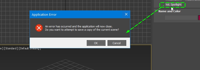

Hi Dartfrog,DartFrog wrote:Trying to create a new Volume Spotlight immediately crashes the scene. I'm using max 2021 with plugin version 11.05, a 2080 ti, a 2080 super, and nvidia drivers 460.89.
yes, you're right.
Sent to deveopers.
Regards
Paride
"About the noisy material, I think it depends on the physics rule, it is like in SA."
I don't see blur in SA exemple... ???

Hi HHbomb,HHbomb wrote:"About the noisy material, I think it depends on the physics rule, it is like in SA."
the screenshot is not from SA, it's 3dsMax, just a few more samples.
Regards
Paride

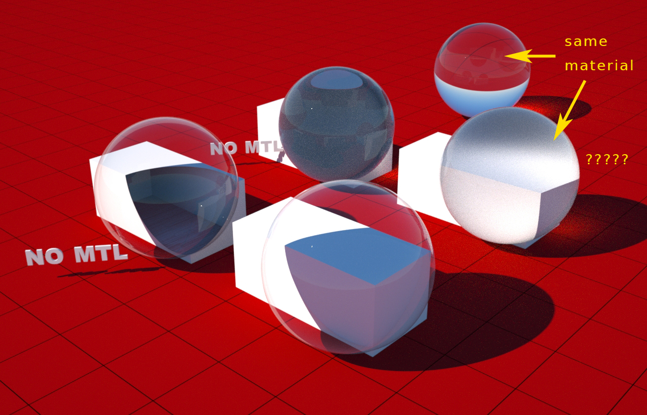

Hi, Paride.
As you said the cut on the mesh has been introduced with Spec Priority. ( see pict rendered with oct 2020.1.3 : no problem )
For the blur : It seems to be a mix between IOR and light incidence on Bright material.
More higher IOR more blur, when light come from back, there is no blur....
Ok now I'm happy if it happens in a render, I will know why
Anyway, it is not a real world situation.
In the real world I should make a booleen operation to have the specular material volume stop before the mesh one begins.
Thank you to take time to answer.

Hi HHbomb,
yes, keeping in mind priority is not a boolean tool, it's to resolve the ambiguity in overlapping surfaces, introduced the surface priority control to allow artists to control the order of preference for surfaces. A higher number suggests a higher priority for the surface material, which means it is preferred over a lower priority surface material if a ray enters a higher priority surface and then intersects a lower priority surface while inside the higher priority surface medium.
Regards
Paride
Regards
Paride
