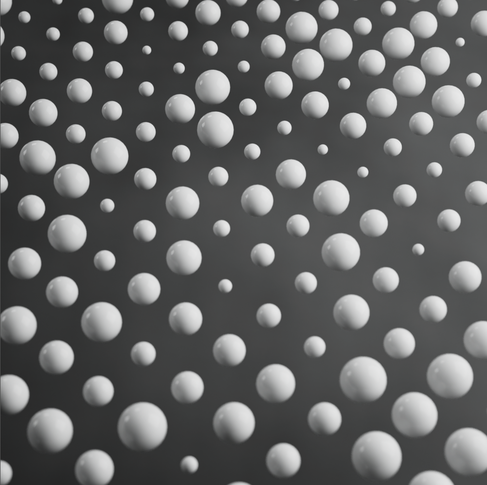

I'm still messing around with the new Packed Geo Instancing functionality, now in 2020.2.0.4. It seems that when using the this feature, if you try to color your instance geo in Houdini and then pull that color into your Octane material network via a Vertex Color Attribute it wont render the color. In this file I'm using Copy To Points to instance the spheres and I'm randomizing the color on the points before they're copied. At the parent level for the geo I'm setting the Render Material path, the Octane Properties Packed Geo Instancing and the Octane Attributes Point Vector Attributes to 'Cd'. If I uncheck Pack and Instance on the Copy To Points node the spheres will render with color, however they all render white when this is checked.
I attached a hip file with the example. Let me know if I can get you any other info.
Thanks!

trogers wrote:Hi Juanjo,
Thanks!
Travis
Octane doesnt support attributes on instances yet. There is a workaround for that in Houdini. Check this thread viewtopic.php?f=101&t=73105&p=372155&hi ... cd#p372155

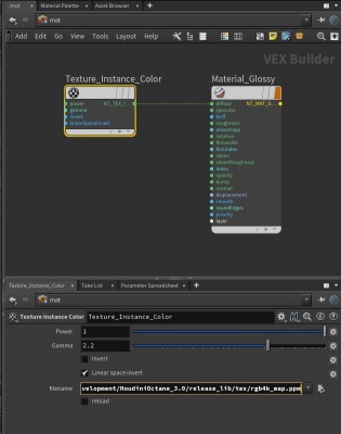

So, what is "Added support for packed geo instancing"? What is the reason to use packed geo option if we can't use colors and attributes? Does it mean that we can use it only with flat colors in shaders? What about UV on packed geo?
Phantom4
Posts: 8
Joined: Thu May 03, 2018 4:30 pm
You can set the OCIO system variable to the config.ocio file provided with Houdini 18.5.x.
Add this line to Houdini.env:
OCIO = "C:\Program Files\Side Effects Software\Houdini 18.5.462\houdini\ocio\config.ocio"
juanjgon
Posts: 8867
Location: Spain

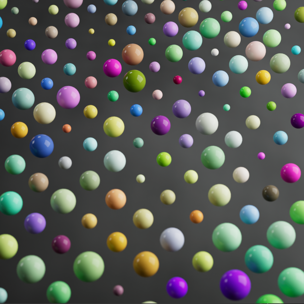

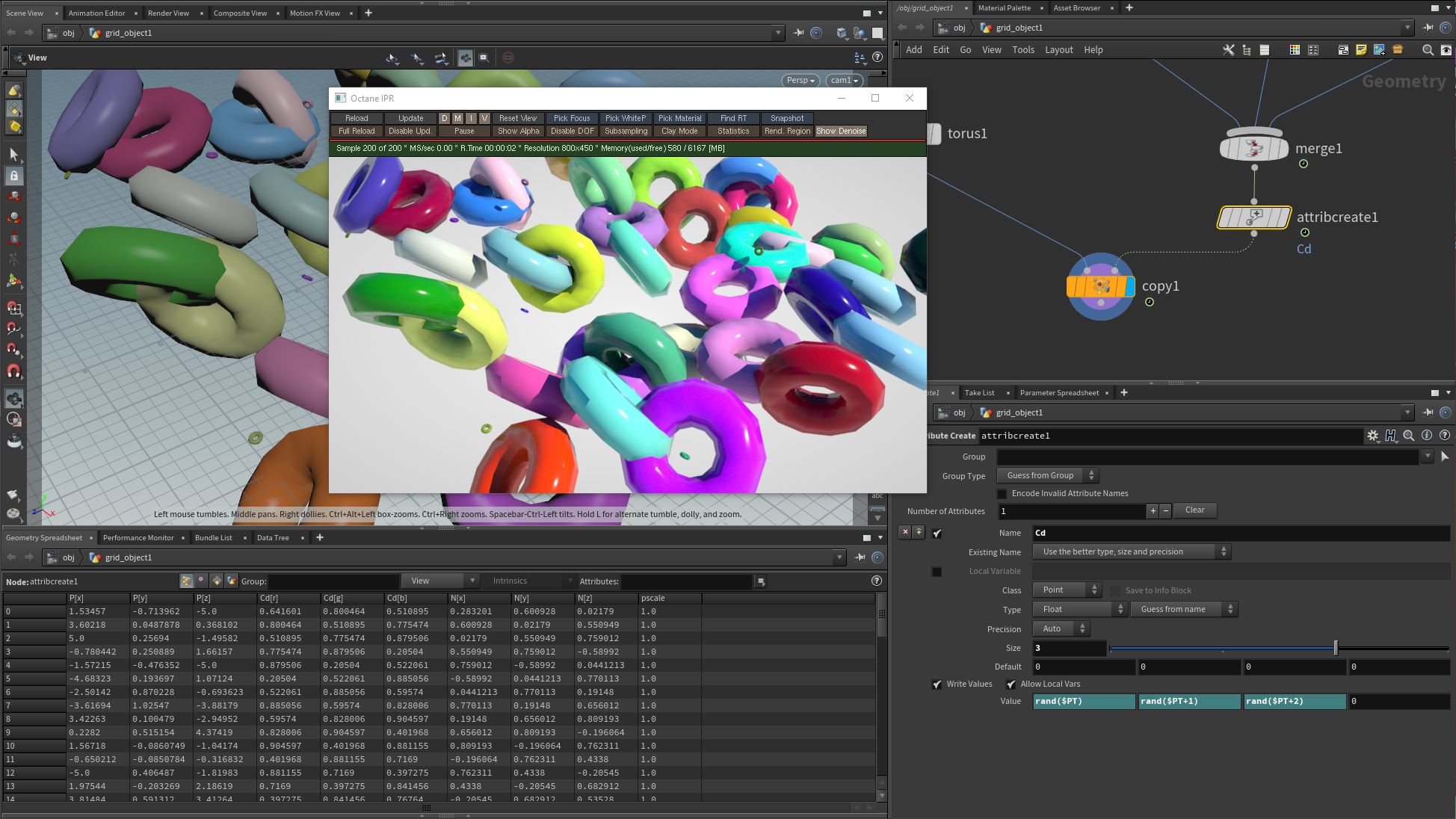

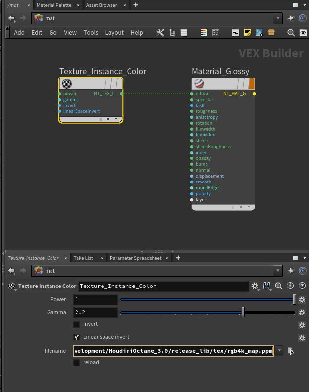

motionskill wrote:
You can use the same workaround available for conventional instancing. Even while working with packed geo instancing, the "Cd" attribute is encoded and available for shading using the texture instancer color node and the rgb4k_map.ppm texture.
