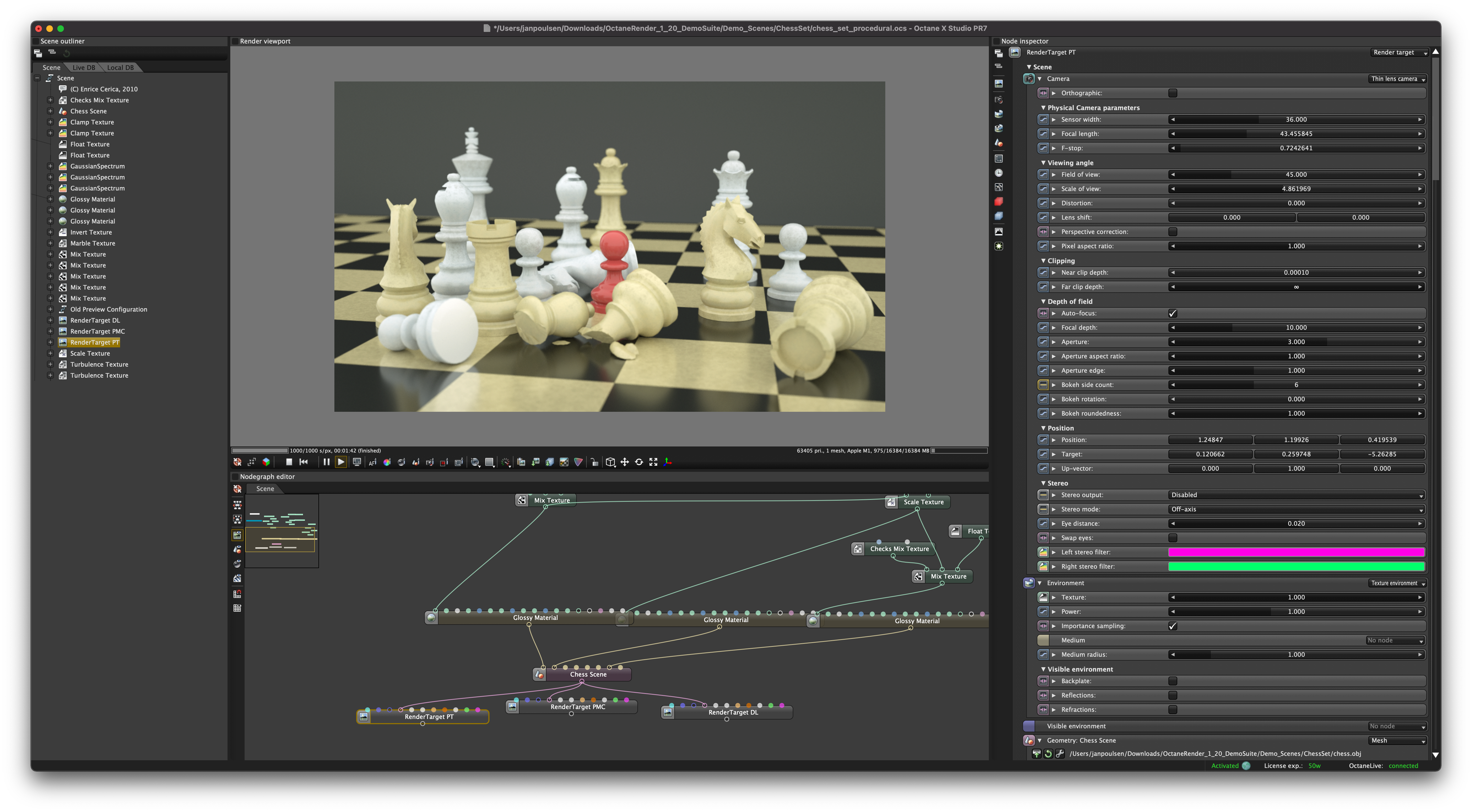

Octane X Studio PR7 Stand Alone works fine on my MacBook Air M1, but not the Cinema 4D plugin.

What’s the performance like?

mitchino wrote:What’s the performance like?
you can try the demo scene on your device for comparison. I did a test on one 2080, it's 19 sec. for the same scene with PT. And 41 seconds for i9 macbook pro with 5500M

I got 31seconds on that PT kernel with that chess scene on 2x gtx1060 and Octane 4
The apple M1 did 1.41minutes :arrow:
