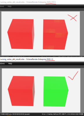

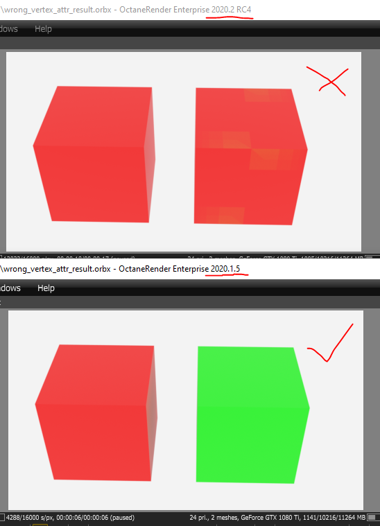

BUG: Greyscale vertex attribute controlling a gradient with constant interpolation is wrong in 2020.2
I have a simple scene here which uses a greyscale vertex attribute to control a gradient with constant interpolation.
In 2020.1.5 this gives me 2 different colored cubes. In 2020.2 RC4, this breaks and both cubes have the same color (not quite, the second cube has some artifacts in the color)

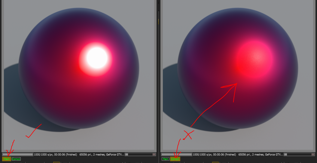

BUG: "Saturate to white" is broken in composite AOVs
If you use the imager > saturate to white feature, it doesnt work in the composite
1. Load the scene and select the rendertarget to render
2. Swap between the "main" and "comp1" passes
These should look identical, but dont.

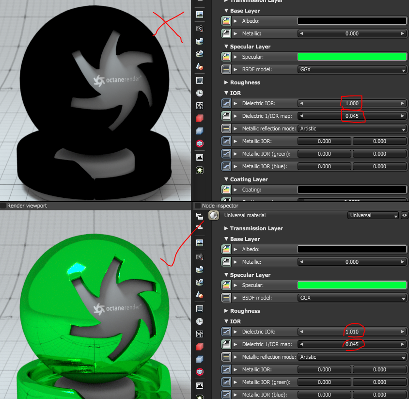

BUG: Universal Material dielectric 1/IOR map doesnt work if dielectric IOR = 1
1. Load scene and right click Universal Material > render
RESULT: The material renders black. It should be a green metal
WORKAROUND: Set Dielectric IOR to 1.01 (anything above 1) to see the green metal
The "dielectric 1/IOR map" should always override the "dielectric IOR" pin (as stated in the tooltip)
I think this may have something to do with the glossy material, where IOR = 1 is a special case (100% reflective). There is no special case in the Universal material though.
- Attachments
- universal_ior_map_bug.ocs
- (38.1 KiB) Downloaded 374 times
Win10 Pro / Ryzen 5950X / 128GB / RTX 4090 / MODO
"I am the resurrection, and the life: he that believeth in me, though he were dead, yet shall he live" - Jesus Christ
Thanks, this will be fixed in next revision.funk wrote:BUG: Universal Material dielectric 1/IOR map doesnt work if dielectric IOR = 1
