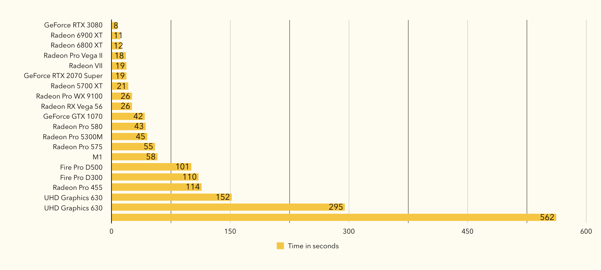

If someone has a 6800/6900, please download the simple example scenes package for Standalone:
http://render.otoy.com/downloads/Octane ... oSuite.zip
Then open the chess_set_procedural.ocs scene in Standalone PR7, then click on the Render Target PT node, and share a screenshot, here is the result of my AMD Radeon Pro 575 4GB:

I am not too familiar with the standalone Octane, as I use the C4D plugin, but I rendered that demo chess scene Render Target PT. Is this the screen shot you wanted or some other place?
Posts: 10634
thanks for the feedback, and render speed test!
Unfortunately the image is not visible, but here is the updated graph with latest results:
Happy Mac GPU rendering,
ciao Beppe

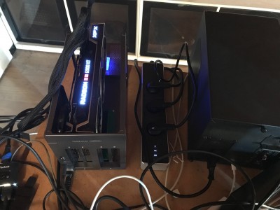

Here is an AMD 6900 XT in Akitio eGPU box, connected to Mac Mini 2018 Thunderbolt 3, with Big Sur 11.4beta3:
It works great :D
ciao Beppe

Whats the PSU on thT chassis?
iI have a breakaway box 550....but don't think it will handle a 6800 or 6900
Posts: 10634
the PSU is a 550W and seems to handle it very well, so also the Sonnet breakaway box should be able to handle it, it is exactly on the right in the picture… the issue is how to fit the beast inside it… it is huge :shock:
Since I’m currently losing one slot of my Akitio Duo, I have to place the 6900 inside the Sonnet me too, but I have to figure out how to correctly do it :D
Let me know if you find a clean solution.
ciao Beppe
