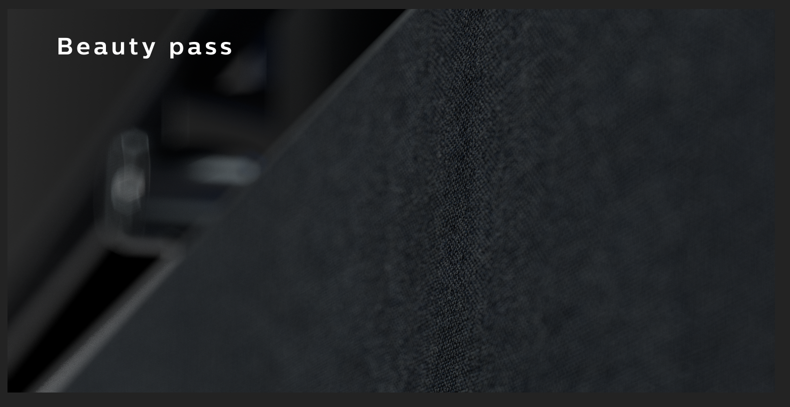

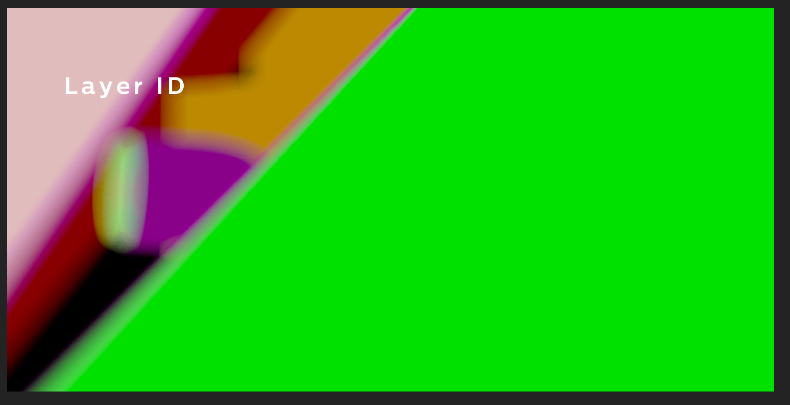

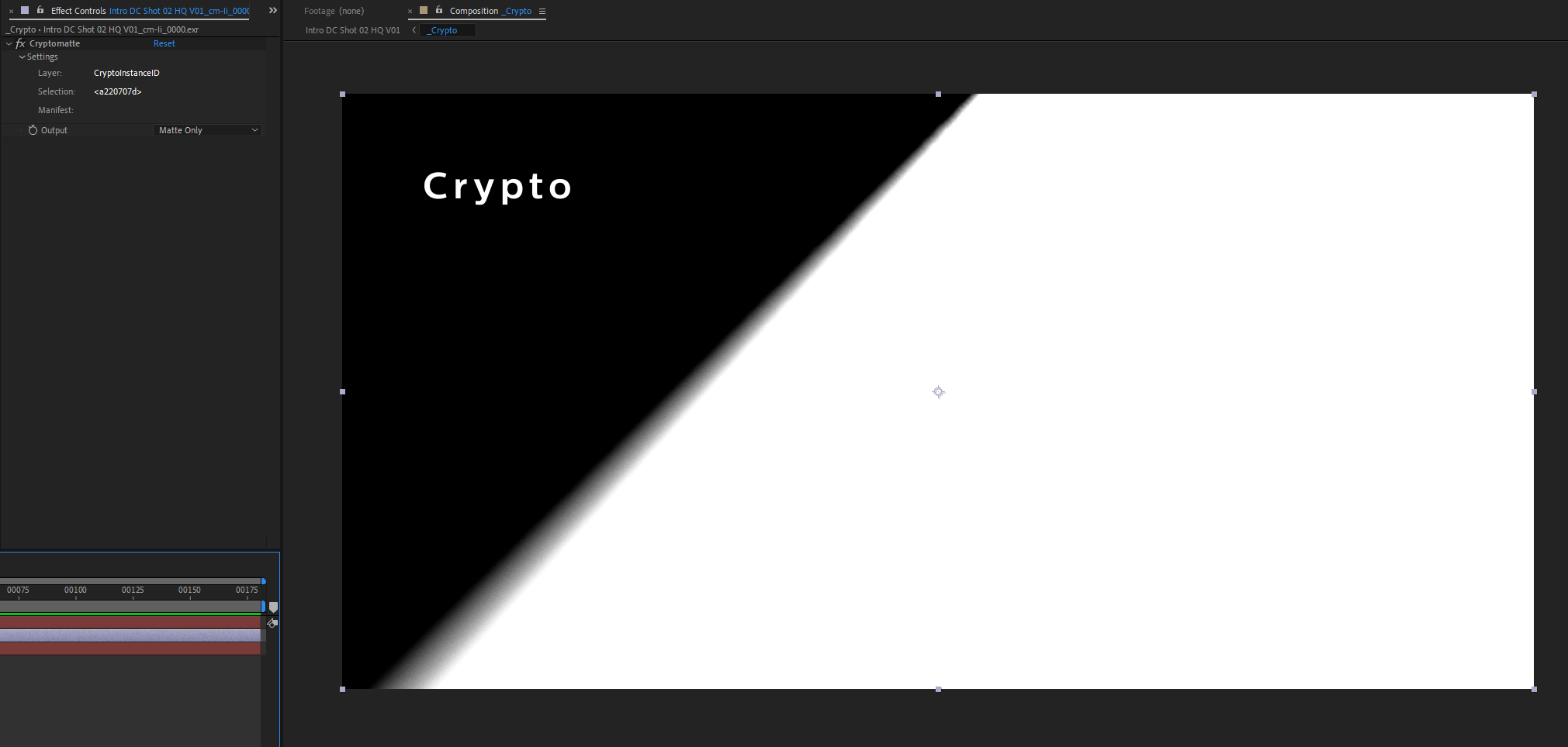

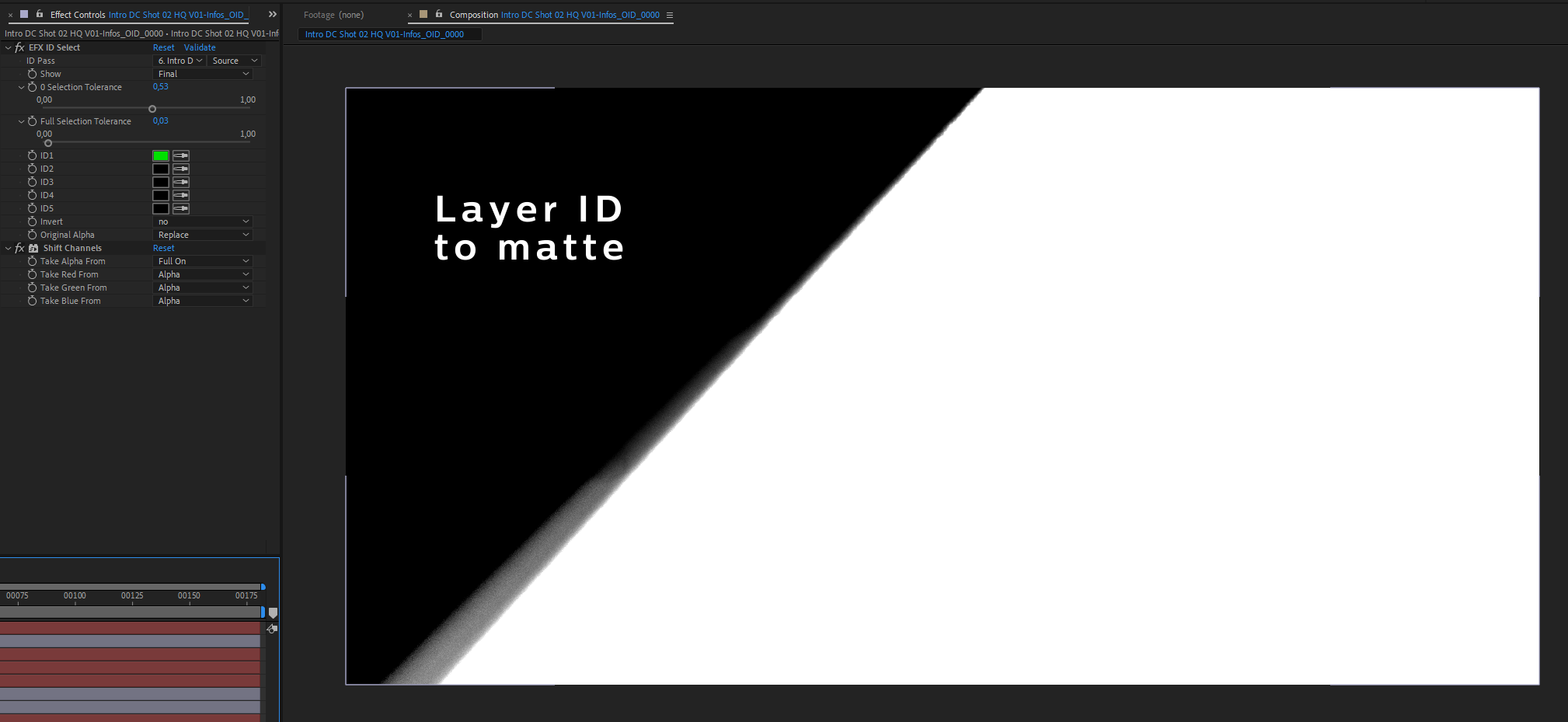

Object Layer ID pass (multicolor) gives me sloppy mattes, e.g. with extreme DOF situations. In AE i tried the color key and the EFX ID Select plugin, see test images attached.Jengo_1 wrote:Hey brother, I think you're right the answer is no. Essentially this is for your own good

Object layer color pass works fine (R+G+B workflow) and is fast. But is restricted to only 3 mattes as far as i know. Multiple RGB mattes is not possible right (like in Redshift)?
Layer masks are slow to render but gives me perfect mattes, can go up to 24 mattes and is fast in AE. In a lot of shots i need more than 3 mattes, and while rendering overnight i don't care so much about the little extra render time.
But since Layer masks can't be combined with Cryptomatte apparently (still weird why not), i think i will go for the RGB workflow (for the first 3 mattes) combined with a Cryptomatte (for the rest).
