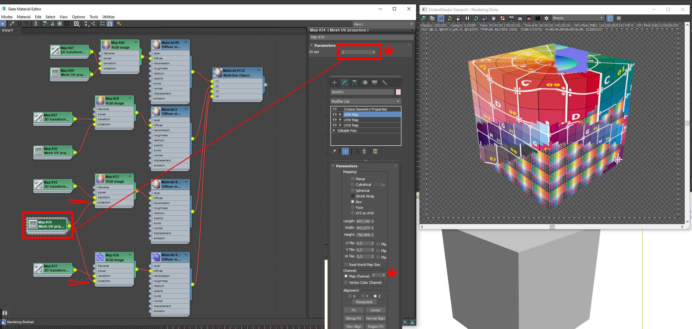

Sorry its me again. I did not have the time to continue to work on Octane until now. I bought the full version now,
so maybe i have to change the thread?
Thanks for your support! To use Octane properly this uv thing is essential for me.
In your Testfile is just the first Material in the Multimat driven by the UVW Map(Box) Modifier from 3ds Max.
The Second one is driven by the 2d transform from Octane.
Is it possible to drive 2 or 3 Texture Maps with the UVM Maps Modifier from 3ds Max?
I hope you get what i mean, sorry abput my poor english;)
Can you tell how to upload scenefiles?

Hi Drigg,
if I understand correctly.
Regards
Paride

here for you.
Regards
Paride
test2b.zip
