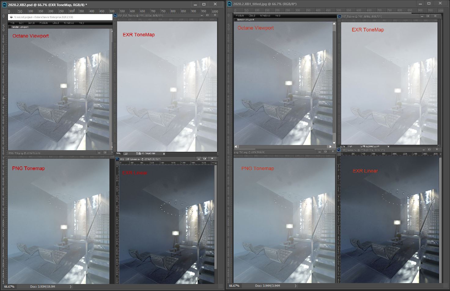

karu wrote: There appears to be a difference in saturation between the XB1 and XB2 screenshots. I guess this is a change in the scene? Nothing should have changed so let me know if it's the exact same scene.
I uploaded a wrong file for the XB2, which I forgot to tag an icc.the one for XB1 has colormanaged and this one did not, so they look different from your side, they should look same (in saturation), actualy from my side they do,
It's a typpo, and have re-uploaded
karu wrote: The EXR ToneMap image is too bright due to Photoshop interpreting sRGB as linear sRGB (or equally, Octane passing sRGB off as linear sRGB on export), as we discussed before. XB3 fixes this by never saving a non-linear color space to an EXR file.
OK,

karu wrote: [*] The EXR Linear image is darker than the Octane Viewport due to using Photoshop's tone mapping instead of Octane's tone mapping. Neither one is objectively "right"; there are just many different methods of preparing a scene-linear image for display (this is something that OCIO can address, if used consistently across all applications).
If a Linear image is produced correctly it should be greyish, it is like raw file with no color profile.

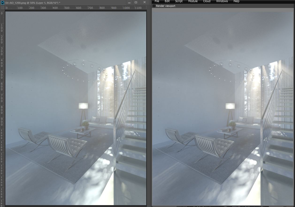

karu wrote: [*] The difference between the PNG Tonemap image and the Octane Viewport image is interesting, and not something I can reproduce myself. I would guess that it's due to different display color management between Octane and Photoshop. Are you using the same display color profile in both applications?[/list]
tonemaped PNG is the closest to the viewport, the difference is quite subtle, I guess on sRGB system it is unnoticeable, no offend, you might find the differenc on a real wide gamut display...

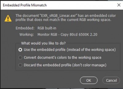

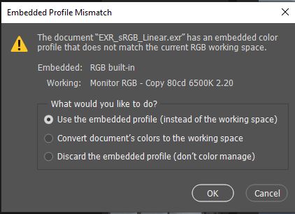

I found different EXR plugins act differently:
1,one EXR recognize your file as RGB profile attched(though you called your file untagged,my view to tag an imge there are different ways, consumer way is to use icc, the programer may do it in a "built-in" way),
the EXR-IO plugin for photoshop call your file has a "RGB built-in" embeded which is exactly same effect as consumer's icc profile attached,
the EXR-IO's webpage listed hereviewtopic.php?f=9&t=75843#p389835
In this case your image might be considered as a color managed imaage but wrongly,unfortunately.

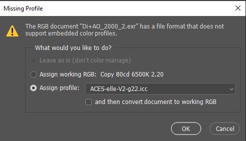

2, another EXR plugin (ProEXR) read you image as untagged,asking user to assign one when opening in photoshop
My point was that there is no definitively correct way to display a scene-linear image. There are artistic decisions to be made regarding how to bring the brightness of the scene into the range of the display device, how to account for differences in white balance between the scene and the viewing environment (based on the extent to which the viewer will be adapted to the white of the display vs. the white of the surround), other psychological differences due to looking at a rectangular screen instead of being inside the scene... This PDF is a huge read, mainly about gamma, but very informative: https://poynton.ca/~poynton/notes/PU-PR-IS/index.html
I think the issue here is that Photoshop (unlike most other applications) interprets untagged PNG files as being in whatever working space you have set, rather than sRGB. Since the vast majority of PNG files in the world are untagged, and the vast majority of those are in fact sRGB, this doesn't make any sense IMO - if you have a fancy working space set up, any random untagged PNG from the internet will just look wrong when opened in Photoshop. In any case, the fix is to either manually assign the sRGB profile to these images, or change your Photoshop working space to sRGB, or for Octane to embed an sRGB ICC profile in PNG files that it exports. Obviously the third approach is the best approach :) It's something I want to do for sure but it's unlikely it'll be in 2020.2 (the library that we use to save images doesn't support embedding ICC profiles so it's not a quick fix...).
To back up and reply to something from a previous post:
jimho wrote: when opening in photoshop, all the image is using octane's by default "builtin RGB profile" to import(see below snapshot),
Since Octane doesn't embed ICC profiles into EXR files (indeed, there is no standard way to do this), the message that you're seeing ("The document has an embedded color profile that does not match the current RGB working space") must be due to an EXR plugin you're using - I guess it's "embedding" that profile into the previously untagged image before presenting the image to Photoshop.

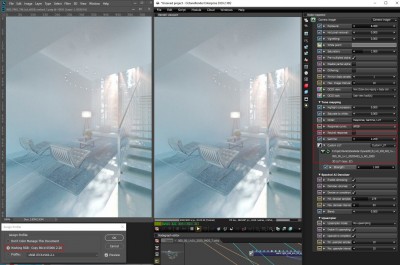

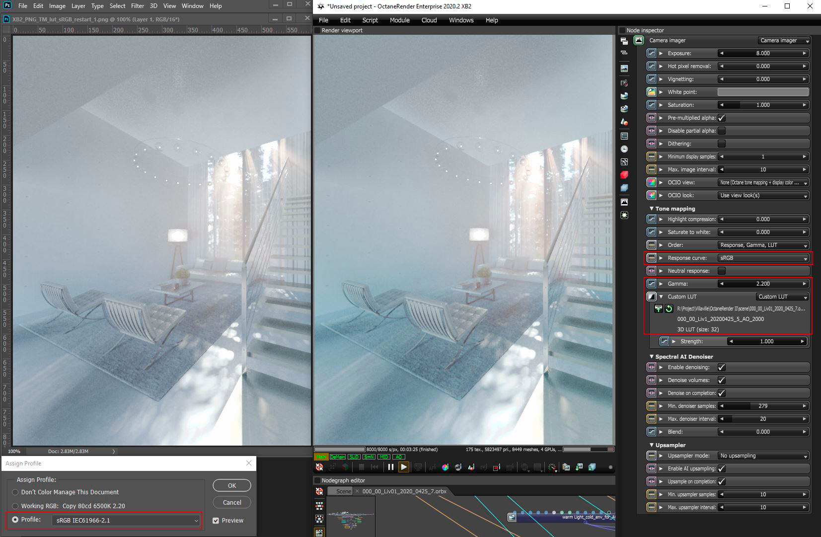

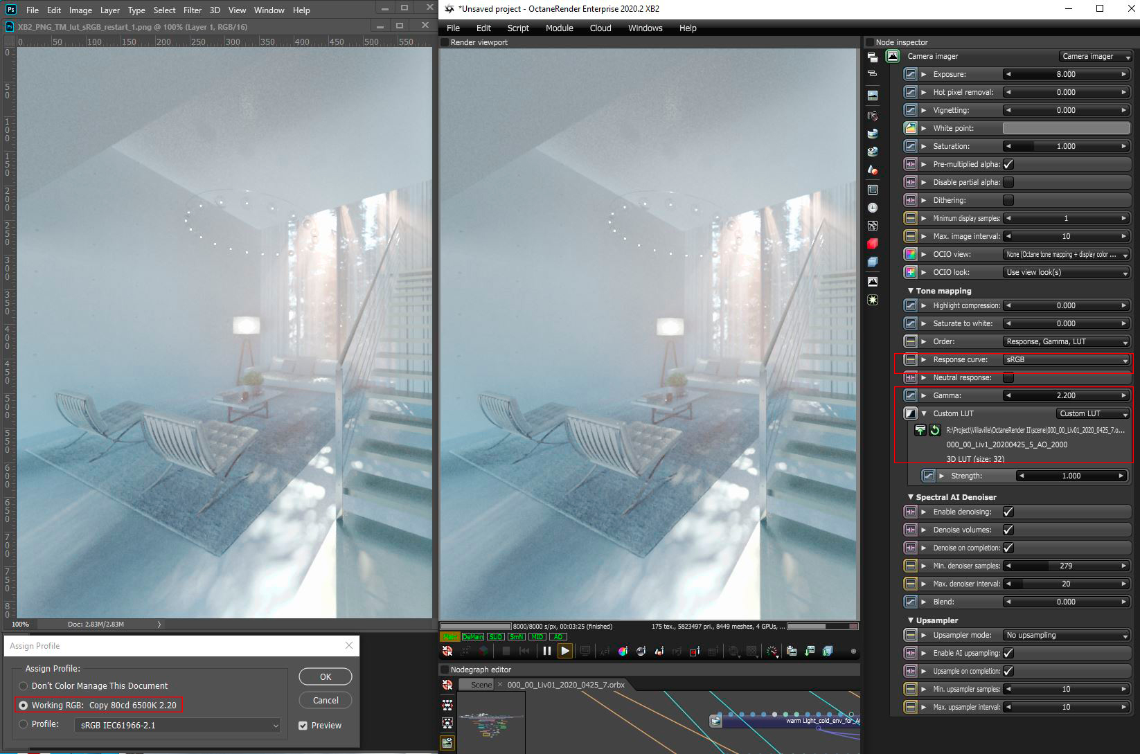

karu wrote: if you have a fancy working space set up, any random untagged PNG from the internet will just look wrong when opened in Photoshop.
That is definately not the point,to show you something here,regard to the PNG which is only one (not so called linear),means it should save the viewport looking:
the above twocomparison, the png are both tagged the screen's color profile, which meet the viewport best,
there are slightly different when change the response curve from sRGB to gamma2.2, that is why I made each of them,and they are all accordingly, Left: PNG exported from the viewport at right(which respond curve has been changed),
the below comparison: PNG are as you instructed tagged sRGB.icc, the result looks differnt to the viewport where the image exported from
These result has been described a few times in the early different posts, here just provide evidence, as mentioned if you are using a pure sRGB system, you can see the difference from your web browser(because I did CM on it),
but you cannot reproduce this.

jimho wrote: the above twocomparison, the png are both tagged the screen's color profile, which meet the viewport best,
Are you sure you're using the same display color profile in both Octane (Preferences > Color management) and Photoshop (which seems to take its settings from Windows color management settings)? Except for possible rounding differences, you should see the exact same result as the Octane viewport by exporting a PNG from Octane and displaying in Photoshop with an sRGB profile assigned. The screenshots you posted seem to be consistent with display color management being disabled in Octane (i.e. the display color profile being set to sRGB).
jimho
Posts: 271
Joined: Tue Aug 21, 2018 10:58 am
karu wrote: Are you sure you're using the same display color profile in both Octane (Preferences > Color management) and Photoshop (which seems to take its settings from Windows color management settings)? Except for possible rounding differences, you should see the exact same result as the Octane viewport by exporting a PNG from Octane and displaying in Photoshop with an sRGB profile assigned. The screenshots you posted seem to be consistent with display color management being disabled in Octane (i.e. the display color profile being set to sRGB).
I see,yes, you are right.
In 2020.2, when in Octane ColorManagement, if choose sRGB, it will be consistancy with previous versions(2019and prior), means the PNG result need tag screen color Profile as before
when chooce screen in the preference, the result need to tag sRGB.icc.
Interesting...
Interesting...
That's correct - when you select sRGB, Octane will convert the sRGB output of the renderer to sRGB (which does nothing - the same as previous versions). When you select your monitor's color profile, Octane will convert from sRGB to that color space, meaning if you want another application to do the same conversion you need to make sure it starts from sRGB just like Octane does.
This is what I meant earlier when I said that if you have the correct display color profile for your monitor selected in Octane preferences, you will never see colors outside the sRGB gamut in the render viewport, because the image coming from the renderer is always produced in sRGB and then converted to the display color space. What you were doing before was effectively disabling display color management in Octane, taking the sRGB image and sending it to the display as if it was Adobe RGB, and then tweaking it until it looked right, which is a way to get wide-gamut display in the render viewport, but also a way to confuse Octane when it comes to exporting an image later, because as far as it knows the image has always been sRGB.
