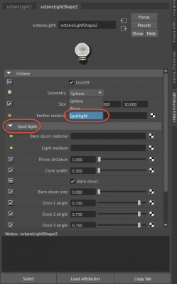

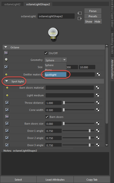

Hello, i've tried to create a spot light with volumetric like c4d, also tried to find some info, but haven't got luck.
Are spot lights fully implemented? (i mean with volumetric like c4d plugin)
If so, is there any info about how to configure them?
Best Regards
JimStar
Posts: 3835
You can ask the detailed explanation of how to use it on the support line. I don't see it in Maya plugin help topics either...
hgarrou
Posts: 59
Joined: Thu Jul 05, 2018 4:31 pm
I create them by creating an orbx proxy object, then opening in the oxtane node editor, and creating the spectrum light and linking it there. I could record a quick demo if you wanted one. I've also been asking for this to be put into the plugin. I'm hopeful they're coming out with it sometime soon.
