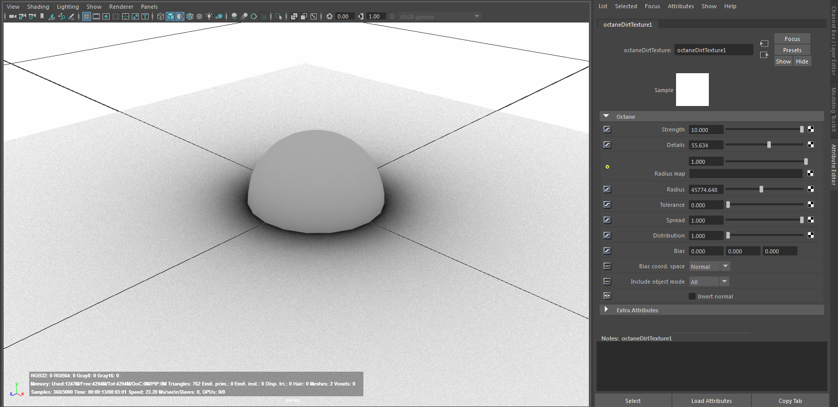

Hi Jim,
You don't need a scene for that the node is broked no settings is working when created from scratch tested on 35 machine at office and same issues.
is not based on scene is any scene settings on the node is not being updated.
Maya 2018
win 10
all similar machines.
Best,
JO

Hi Jim,
Here a video showing the node options are broked not working. also attached the scene.
Cheers,
JO
ScreenRecorderProject1.mp4
Quick preview Maya 2018 dirty texture setttings not working broked
(13.6 MiB) Downloaded 1970 times
Dirt_texture_node.rar
Maya File
(15.21 KiB) Downloaded 217 times

JimStar
Posts: 3852
I don't see any problems on my side with your scene. Playing with dirt parameters back-and-forth changes the texture in the viewport...
I'm getting Cannot find procedure "DCF_updateViewportList" error from Maya when opening your scene, so maybe some Maya's plugin on your side does some fishy stuff with viewport...
