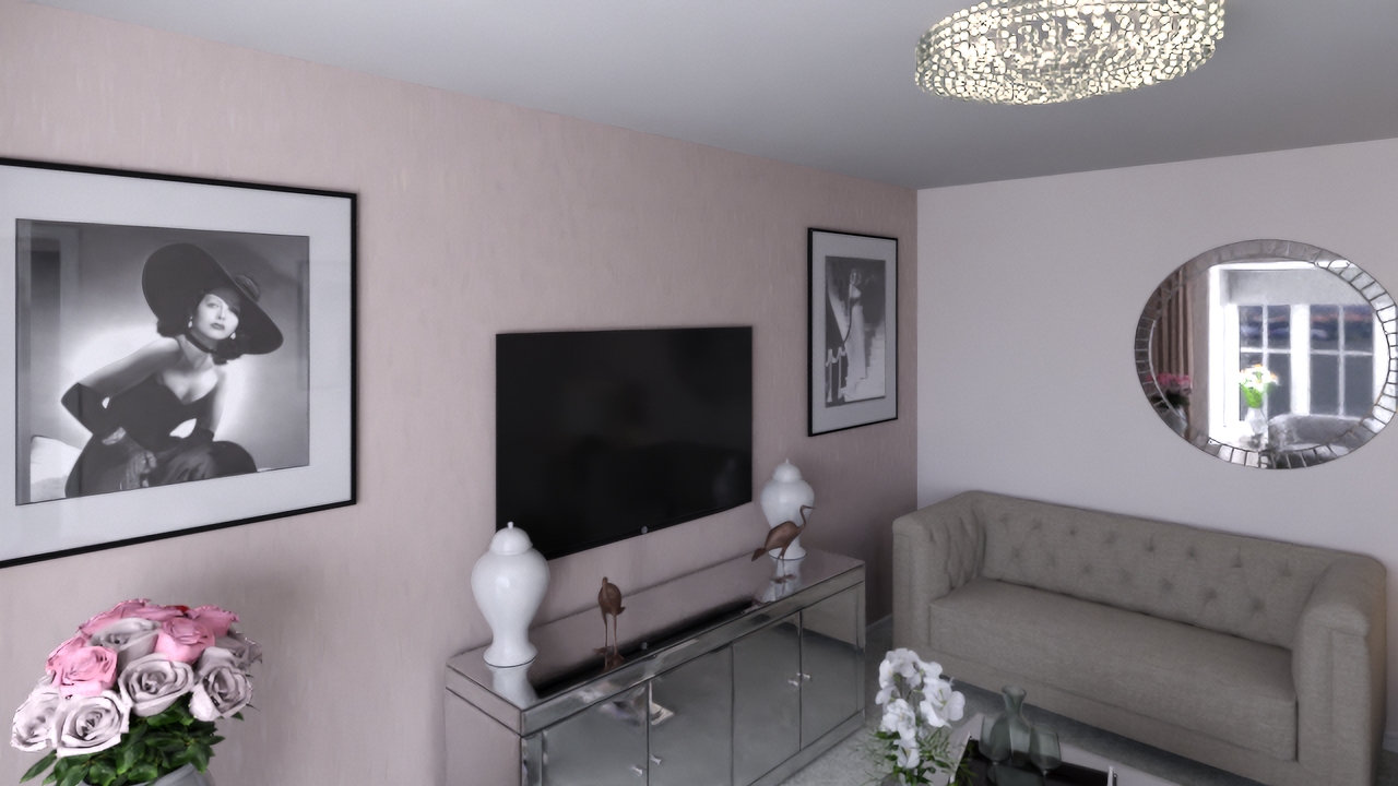

OK, I can see a difference between upscaling and AI upscaling.
Unfortunately, neither are useable for anything other than drafts renders;
Upscaling makes image blurred
AI upscaling makes image slightly less blurred but adds artefacts/noise all over image
Using AI denoiser smooths things out but looses alot of detail and makes the render look sort of fake. Probably because it's having to get rid of so much AI upscale added noise.
Or am I doing something wrong?
These images certainly don't reflect the render quality of the quad bike renders used to demo AI upscaling when this feature was released.
