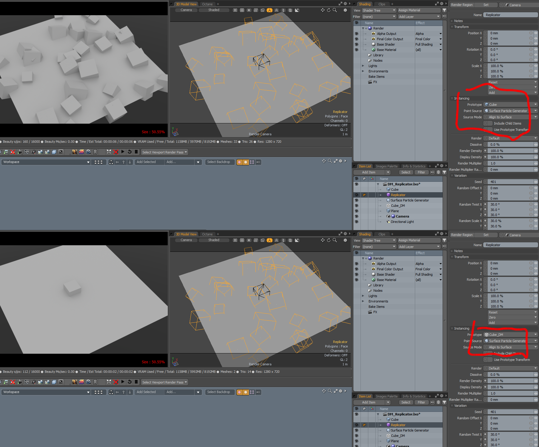

am i missing something or does Octane not support replicated deferred meshes?

however all this is likely irrelevant because unless i'm missing somethjing it looks like Deferred Meshes cannot be replicated. can you pls confirm?
I can confirm this - only normal Modo "Mesh" items can be replicated in the Octane plugin.

face_off wrote:I can confirm this - only normal Modo "Mesh" items can be replicated in the Octane plugin.
Paul
thanks for confirming. that's a shame and it makes the discussion above redundant for me.
is that something that can be added or is it not possible at this time?
face_off
Posts: 15812
Location: Adelaide, Australia
I think there are a lot of other Octane 2020.1 and 2020.2 features that users would be wanting me to add for something like this, so I don't think it's something I could look at in the near term. I /think/ you can scatter/replicate an Octane ORBX proxy, so you could save the Deferred Mesh to ORBX and use it as an Octane Proxy to achieve what you are looking for.

face_off wrote:I think there are a lot of other Octane 2020.1 and 2020.2 features that users would be wanting me to add for something like this, so I don't think it's something I could look at in the near term. I /think/ you can scatter/replicate an Octane ORBX proxy, so you could save the Deferred Mesh to ORBX and use it as an Octane Proxy to achieve what you are looking for.
this is pretty much what i do but from a workflow POV it's not pretty or efficient, but i get that you need to prioritise features.
a simple example though - say i need to populate a park with different plants and trees. i can replicate ORBXs, which works very well, but the problem is i can't see where the meshes are placed in OpenGL, so it makes it tricky to populate as needed. i can't use 'real' mesh plants because they slow everything down and increase scene size unnecessarily. so the only option is to use Deferred meshes which work well in that they keep the scene light, but they're not rendered by Octane, so i need to duplicate all replicators and duplicate an ORBX for each DM and so on and basically have 2 sets of replicators, one for MODO and one for Octane.
if Octane could render replicated deferred meshes this would be a very simple process.
or even if we could have the Octane Proxy tab on Deferred meshes (like we do with regular meshes)? that would help a lot as we could then use deferred meshes to place everything and simply point Octane to the required ORBX. would save a lot of time and effort.

Hi Dingbat,
i think the solution to your problem is to create a lowpoly Version of your highres Mesh (or a simple cube with the right dimensions) to use them in the Meshlayer you use as a proxy. So you can see your lowres Meshes in the viewport, but Octane will pick up your prepared Orbx for rendering.
