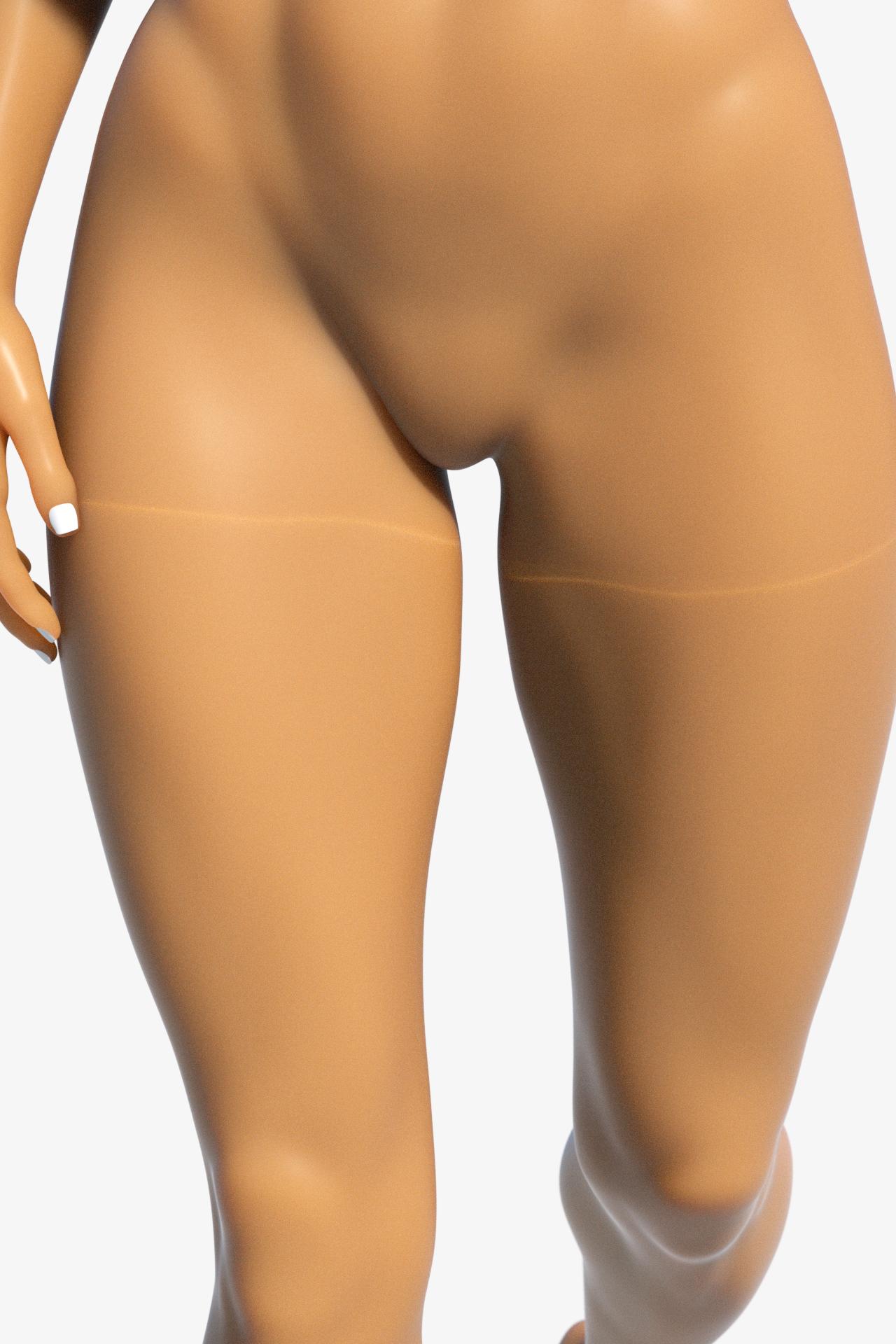

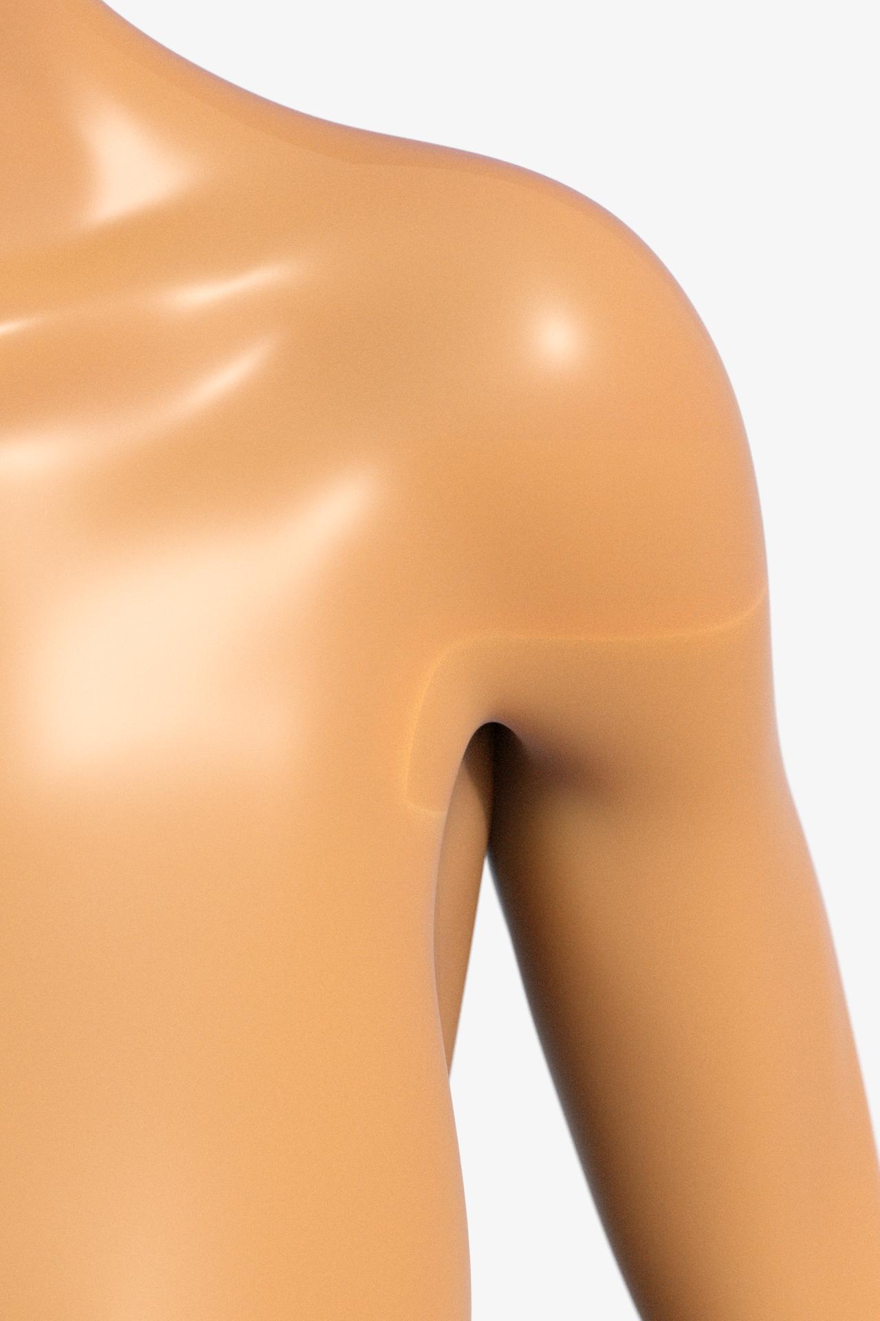

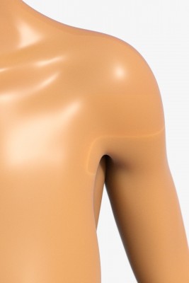

Hello Paul,
I am also encountering this same problem but there is yet another thing that i am experiencing. And i believe that it might be
related to this "faceting" problem. When applying scatter medium to a material and aplly it to a character
(i tried it with genesis 8 and 3) there appear seams between the bodyparts. I will attach examples.
I have also found out that this problem does not exist in the 2019 version of the Plugin. Everything
scattering-related works just fine there for me.
I just wanted to know if you think those problems have the same source?
Have a good day and thanks for your work.

Banti wrote:Hello Paul,
The seems between face-groups is a known issue in 2020.1. A fix is scheduled for 2020.2 as far as i read.

Thanks for your summary. The facetting and seams problem are extremly annoying. At least the seams should be fixed in the latest release. Since i rarely use a pure specular material for skin the facetting is not always a problem for me but its frustrating for sure.
That said, i had some great results with using random walk in specular materials, its faster than regular scattering and looks as good if not better. So there is that.
face_off
Posts: 15760
Location: Adelaide, Australia
It would be worth trying the Octane 2020.1 RC3 build of the plugin that I just posted, as Octane 2020.1 RC3 contains the fix "Fixed issue with subsurface scattering causing visible seams.".
