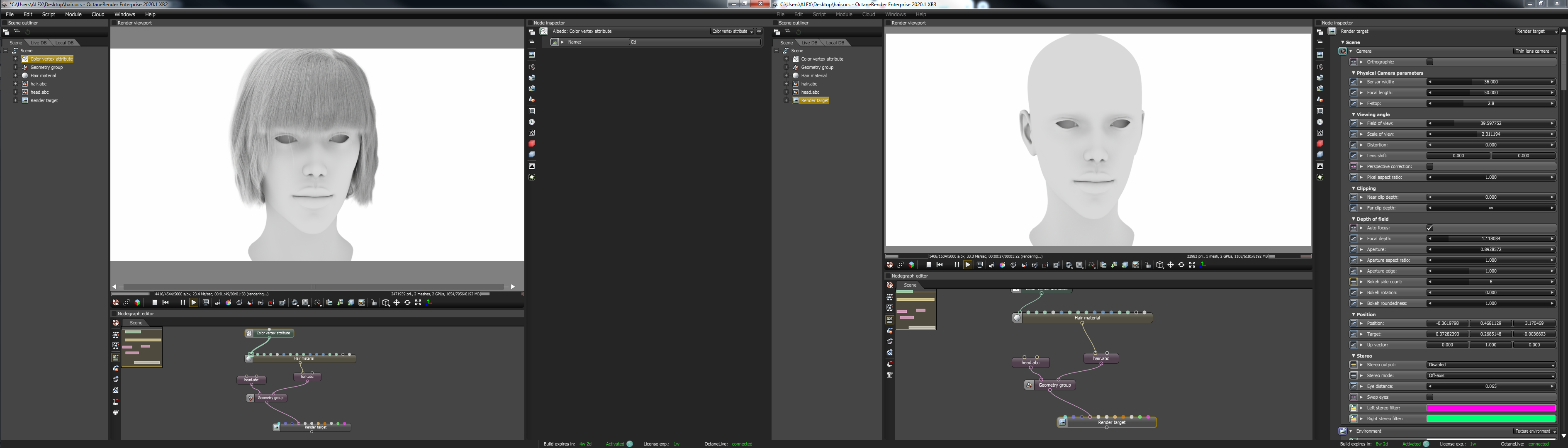

Okay, I had it working now.
(1) I was testing to see if the "Vertex Attribute" thing with FBX had anything to do with BlendShapes or Morph Targets. But it looks like it had nothing to do with that, right?
(2) The floats for Primitive hair mesh thing have something to do with Alembic? Because was wondering iof there was a new mode in Hair shader, but I didn't see any new primitive color float nodes for the Hair shader.
I had high hopes, but maybe unfounded - I might be 0-for-2 here then! :?

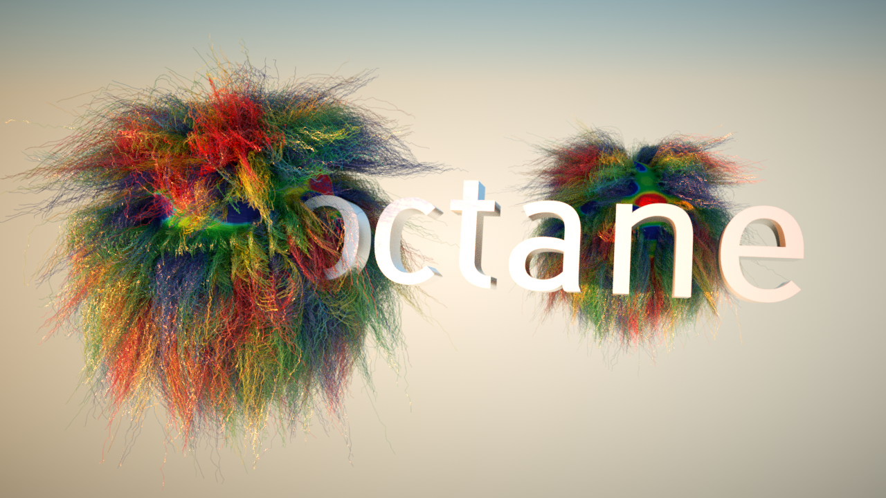

Curves are not rendering in this version.

galleon27 wrote:Curves are not rendering in this version.
Hair seems to be rendering fine, maybe there's something with your specific project that breaks it? Could you share your ORBX package so we can test it here?

@mojave
that is some seriously nifty developer art. Sweet! 8-)
Ok so with the help of Mojave, we found a temporary solution for this until it gets fixed in the next version. If you export curves from Houdini (or any other DCC i suppose) with primitive attributes, its not going to work. Just delete them and its all gonna be fine.
Thank you for that.
Just a heads up for everybody: this issue applied to not just hair but also particles and triangles imported from Alembic that would contain one attribute per primitive.
We currently support attributes per vertex, so this case was handled as an error as the number of attributes was smaller than the expected. We are implementing a solution for this that will be included in future builds that would ignore such properties but still allow loading the mesh.
