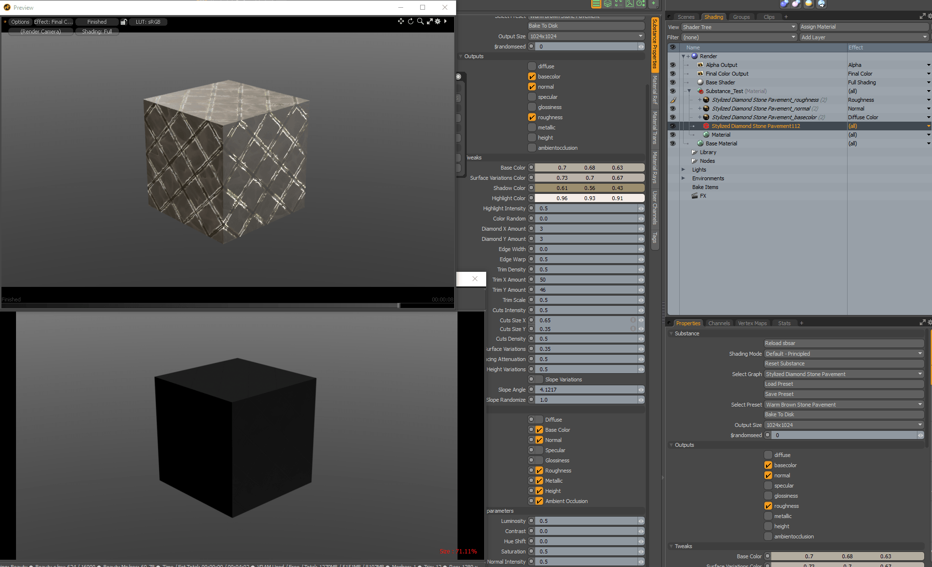

Substance plugin compatibility looks to be broken with 2020, example below. It seems to be working fine if I manually import and assign all the maps.
Modo 14, Substance 2.7.3 and octane 2020 rc2.

paberu wrote:Substance plugin compatibility looks to be broken with 2020, example below. It seems to be working fine if I manually import and assign all the maps.
This is a problem with recent versions of Substance. It was reported to the Substance devs about a year ago, but I am not aware of any resolution yet. May I suggest you report the problem on the Substance forums.
