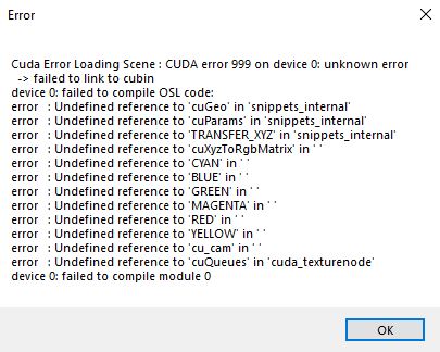

Hi Simon,
See the CUDA 999 message attached. I have a standalone license, latest Version 3 plugins for Rhino 6, latest Rhino 6 service release, latest NVIDIA driver for my Geforce GTX 1080. I've been using the software with no issues for 5 years and I can usually resolve problems by either reverting to previous versions or updating the software / drivers. Thoughts?
Cheers, Dave :D

stonearch.isaacs wrote:Hi Simon,
Cheers, Dave :D
Hi Dave. Please see point 7) in the Solution to Common Problems at the very top of this thread.

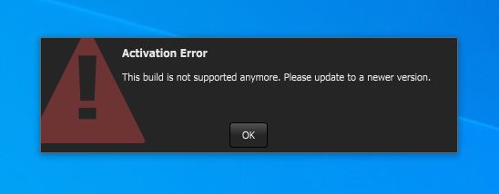

hello,
i'm trying to install the 2020 realease _118 but i receive this error: "This build is not supported anymore. Please update to a newer version."
Thanks,
Roy
I will post a new build in the next 24hrs to resolve this.
Paul
