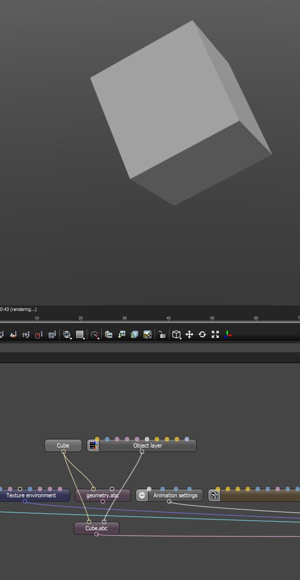

I had a look at your files, and I think there might be some confusion on the recommended way to do this.
1) Enable only static meshes in the Modo scene, open the Octane Viewport, and export the FRAME to ORBX using the plugin
2) Disable the static meshes and enable the dynamic meshes in the Modo scene, and use the octane.saveAnimation command to save to ORBX.
3) Open each ORBX above in a separate copy of Octane Standalone, and copy the .abc file from step 2) in Octane Standalone into the scene from step 1) in Octane Standalone. Merge the geometry together with a Geometry Group. You would now have all the static mesh geometry in one Octane node, and the dynamic meshes in another and they will render together as per your original Modo scene.
Paul

I know that and thank you for your effort. As i said, this works great, but becomes useless if you have a large number of highpoly meshes which are only transformed and not deformed. My files are meant to show, that it is possible to have this kind of animation exported in a fast way.
So if you have only transformed meshes you can export them as alembic (only takes a few seconds instead of minutes or hours) and import without a problem in octane standalone. The only downside is that you have to make the material connections by hand. So i thought there might be a way for you to change (or let the user change) the way the alembic file is created. You repeatedly said this is not possible for you and i'm willing to believe you
but it's hard to do so because it seems to be so easy to get this animation out of modo.
