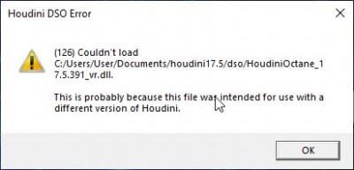

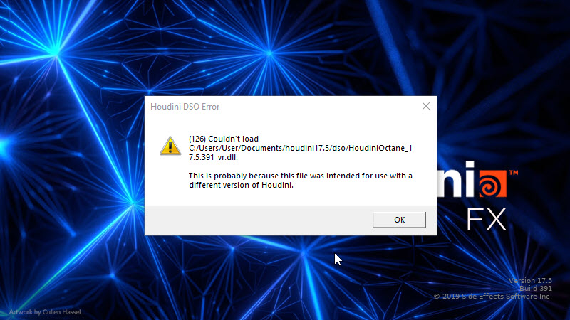

Hi
I've added this build to houdini 17.5.391 but it gets this error...
126 couldn't load in attachment ...
juanjgon
Posts: 8867
Location: Spain
This can be a problem with the NVIDIA drivers version or a problem with the installation. It seems that you are installing the plugin inside the Houdini $HOME folder. This is usually not a good idea, because you could mix by mistake Octane plugins or system files from several Octane builds, breaking the installation. Perhaps you should fully clean this $HOME folder and install the plugin again.

modjtaba
Posts: 59
Joined: Thu Sep 21, 2017 4:29 pm
I'm just copying files to my documents Houdini version folder after cleaning it completely.
whats the better alternative?
where is $HOME?
sorry for the noob question.
juanjgon
Posts: 8867
Location: Spain
$HOME is the main Houdini configuration folder, that yes, usually in Windows lives in Documents/houdini17.5. Although the plugin can work if you put all the plugin files and folder inside this directory, it is better to put them into another place and configure the houdini.env file with the PATH and HOUDINI_PATH variables, as you can see in the docs:
https://docs.otoy.com/HoudiniH/HoudiniP ... oudini.htm
In any case, inside a clean $HOME folder the plugin also should work, so if you still have this problem, you should check if you are installing the right plugin build for your Houdini version, and if Octane can work without problems on this system, perhaps checking if Octane Standalone works fine.

modjtaba
Posts: 59
its a clean installation and attachment obviously shows versions are same...
juanjgon
Posts: 8867
Location: Spain
Hmm, do you know if Standalone 2019.1.4 can work fine on this system? If it works fine the problem is on the Houdini plugin installation time for sure.
