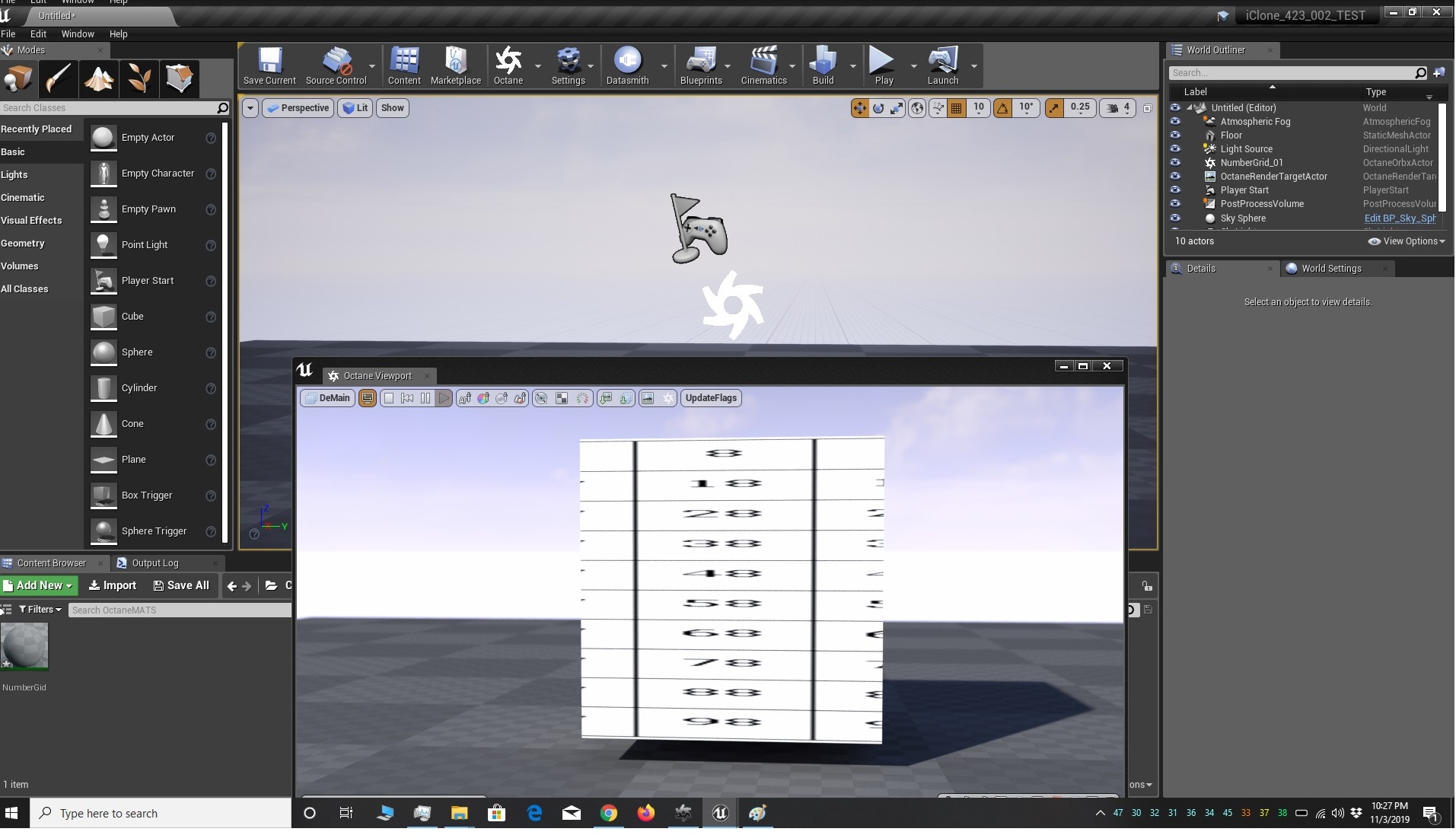

Hi Chris,
I imported an FBX externally and then tried to ORBX in materials from standalone.
I am having a problem with UV placement, so I figured, no worries, I'll just use the material's Transform Value in UE4 Octane to find the correct rotation or translation, and then I can map that onto the entire ORBX at import time.
ISSUE:
Only Scale works, but Rotation and Translation do not function in Material Editor in plugin.
If I mod the Rotation and Translation values, nothing happens.
THX!
EDIT:
Something strange additionally, when I did export out scene as orbx, I could apply the material fine, with no need for remapping UV-wise.
Maybe something corruptive happens with the import and UV placement of the material by the plugin?

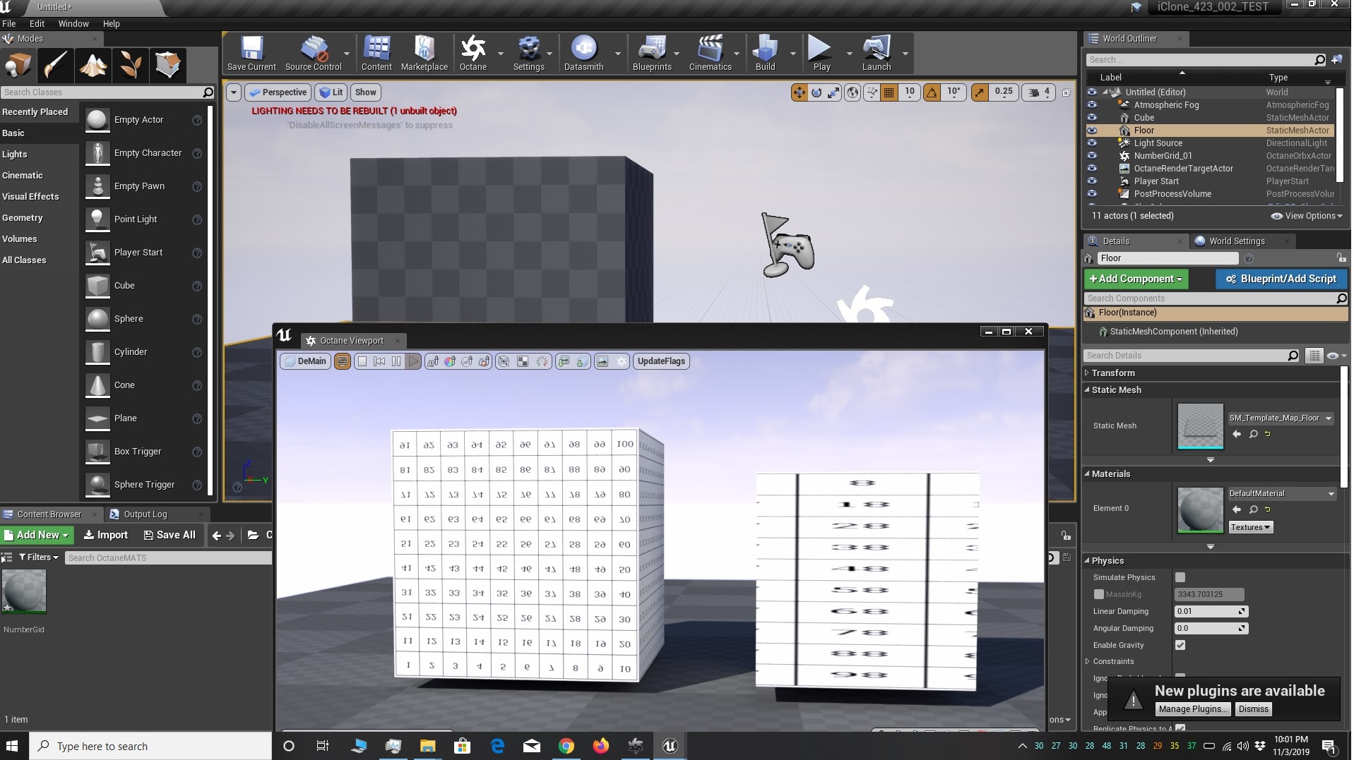

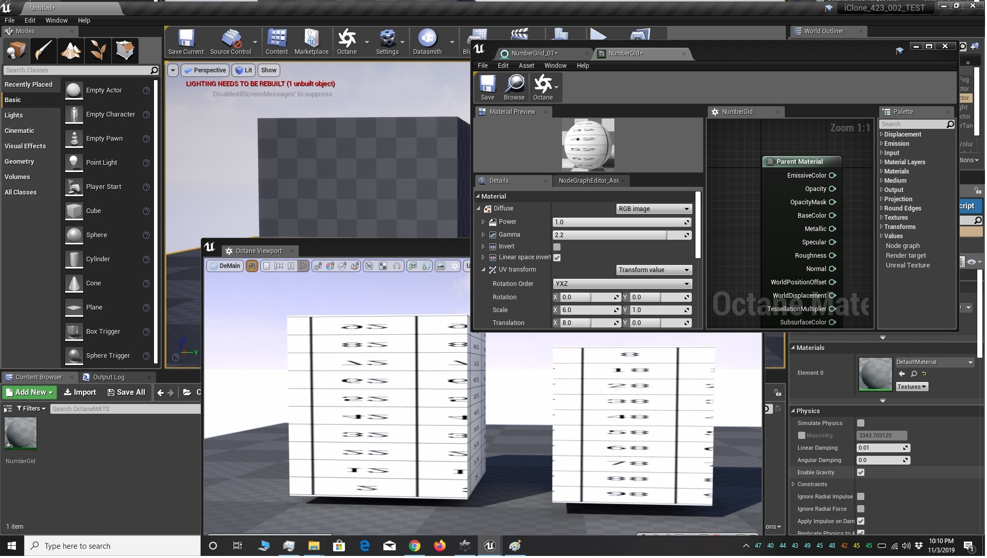

Chris, here is a quick example:
1) I create an Orbx in Octane on primitive with a number grid material, set with default material Transform Value
2) I import in as ORBX from Standalone to plugin, so far so good
3) I likewise (a) copy the material from that ORBX and create into a new Octane material.
I then (b) apply that material to a primitive cube in UE4
The grid texture is scaled differently when applied to the cube, and it inversed for some reason. In any event, it is not sitting on the UE4 cube the same as it is sat on the ORBX's Standalone Primitive cube
4) If I try to adjust with transform values, I can't modify the material, except for Translation-X.
And Translation-X only works when scaled up....
But then it's still inversed, and I can't rotate it, so it's screwy
What I would like to happen is have the material sit same if the mesh has the same shape, even if scale is different.
THX!

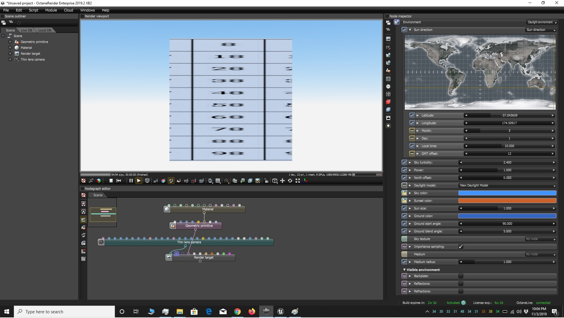

Notiusweb
Posts: 1285
So strange, when I next export back this now 2-cube scene from UE4 to Octane Standalone, the UE4 created cube is still warped, and texture inversion matches the issue in the plugin.
It's like there is something mirror going on with the UVs in UE4. I blame UE4 here.
Because, even If I completely disconnect the UE4 cube from its screwy pasted on plugin material, and then paste on a whole new simple Diffuse in the Octane Standalone, it's still messed up.
So, like the material the whole time is always fine in all circumstances.
Just somehow meshes from UE4 have some UV distortion thing going on that is preventing Octane standalone materials from being directly imported onto them.
