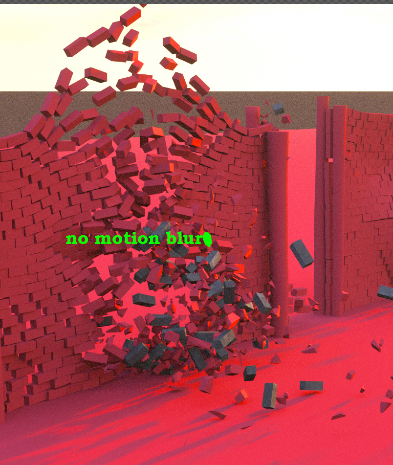

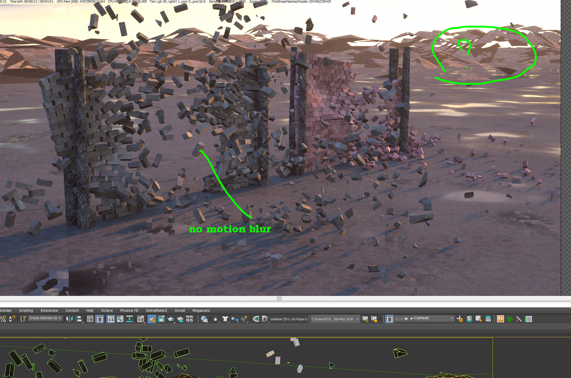

Hi Paride,
There is a bug with motion blur. Not just phoenix but mesh and camera motion blur. I sent you the scene as PM. Please go to camera 15 and frame 3374 and there won't be any motion blur from bricks. There is some kind of bug. We use 2020.2 max
It's like sometimes it works and sometimes it doesn't. After restarting PC and opening this scene in octane viewport I hear windows sound like a crash. Not sure if drivers are at fault . Also strange artifact with displacement.
It seems that lately we are not working but troubleshooting. Tons of bugs in 2019
UPDATE:
I selected all bricks and did inverse select of all other scene objects deleted them and then undid the delete. Instead of camera I used perspective view and mb came back. So it is a strange bug may be something to do with slaves too
UPDATE:

HI All,
Can anyone try to open the scene and go to frame 3374 and see of you have motion blur or not. We use max 2020.2
Hi, Paride,
I sent the same scene through wetransfer. It is attached here too. Wetransfer was giving us problems.
Thank you
Hi, Paride,
Thank you
