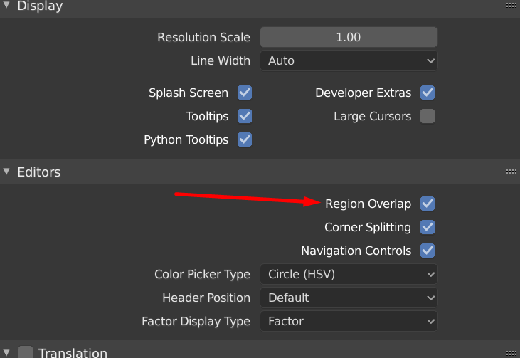

JC, looks like you have "Region Overlap" disabled in the Interface settings

Thanks Chris, that did the trick!

Hi J.C,
Thanks for your video. Could you please let me know what shortcut did you use to hide the sidebar in the video? As scaling the side panel by mouse seems to be working fine in my tests. Thanks.
About the Cycles nodes, they will be hidden in the next build.

Hi DrawFun,
The shortcuts for hiding the 3d view sidebars are N for left and T for right sidebar. Enabling "Region Overlap" solves the issue as Rick suggested.

Awesome. Thanks for your tips and confirmation!
