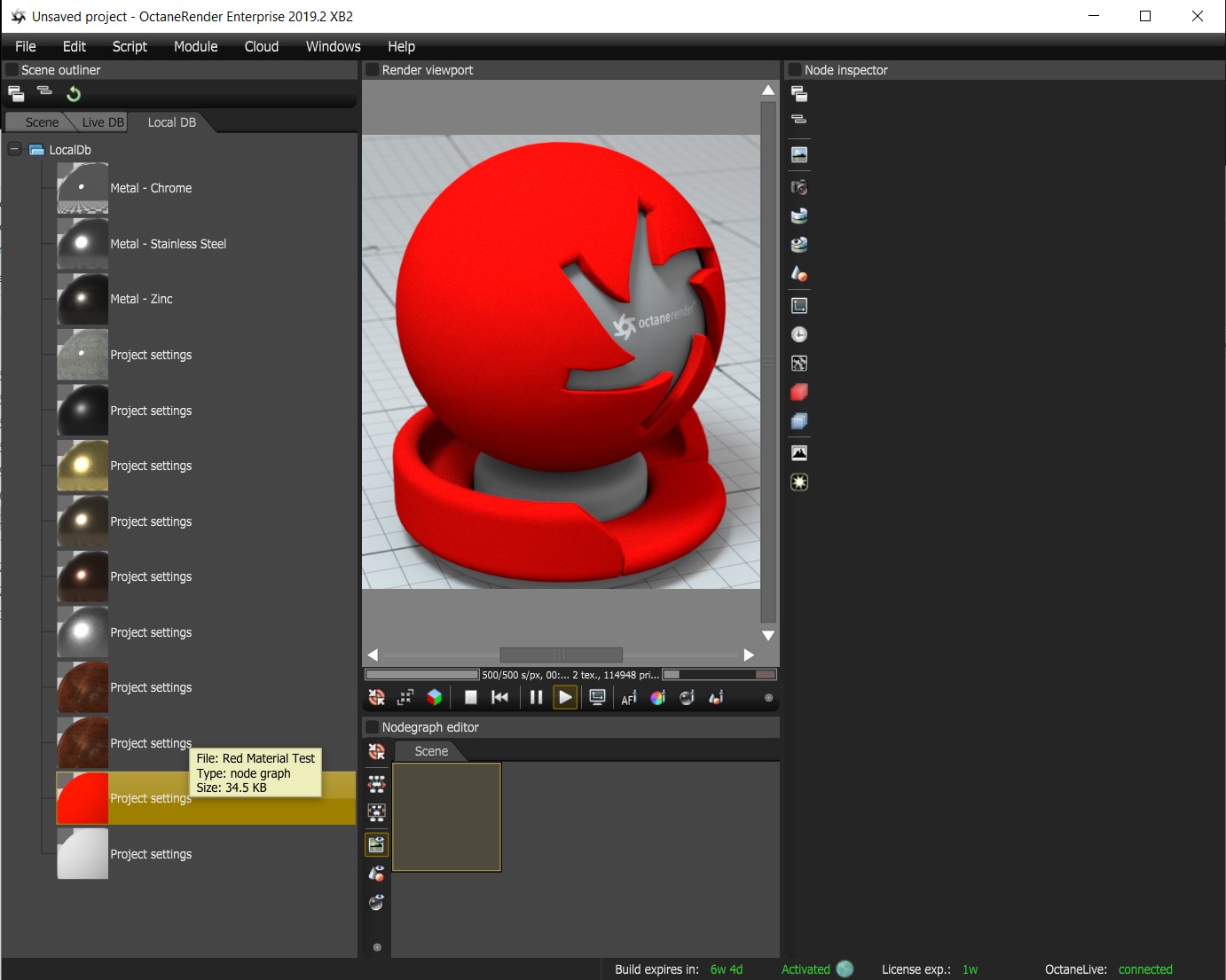

I am finding that the Display name of ORBX Materials in the Local DB ends up being "Project Settings" for any materials created or edited in Standalone.
Interestingly ORBX Materials created through the ArchicAD Plugin have the Display name they were originally exported to the Local DB with.
In the screen capture below most of the materials were created from the ArchiCAD Plugin, but aside from the top 3 on the list which haven't been edited since in Standalone, they all display the "Project Settings" name, but when you hover your mouse over them the little yellow information pop-up shows the correct name of the ORBX.
This issue is present in all of the current builds of Octane, but it's only become apparent to me recently since I started trying to optimise them in SA using the node graph editor to set them up better. The "Project Settings" display name then gets carried over into the way the ArchiCAD plug in shows the Local DB as well.

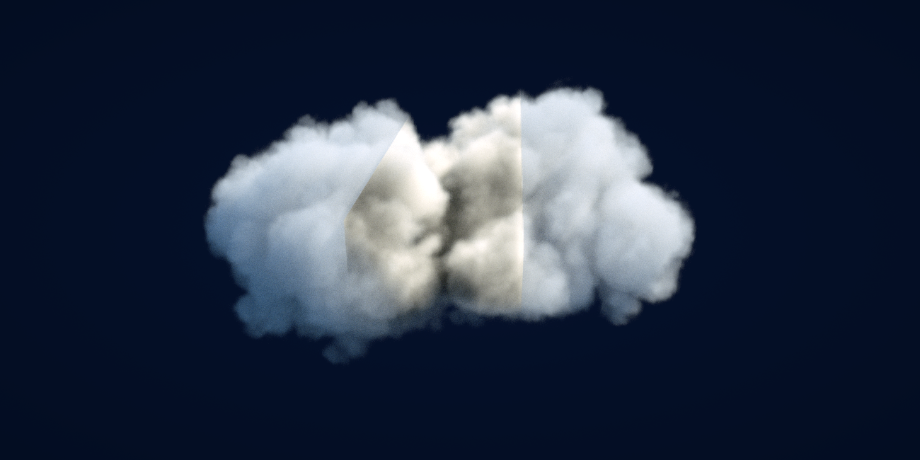

Just tested on Linux Mint, no errors, but the cloud looks strange. Is this how it's supposed to look?
Jason
Jason
Linux Mint 21.3 x64 | Nvidia GTX 980 4GB (displays) RTX 2070 8GB| Intel I7 5820K 3.8 Ghz | 32Gb Memory | Nvidia Driver 535.171
No, it does not. In 2018 it looks different.grimm wrote:J.C and Haze,
Jason
The issue with Cuda Error happens on OSX, on Windows it is ok.

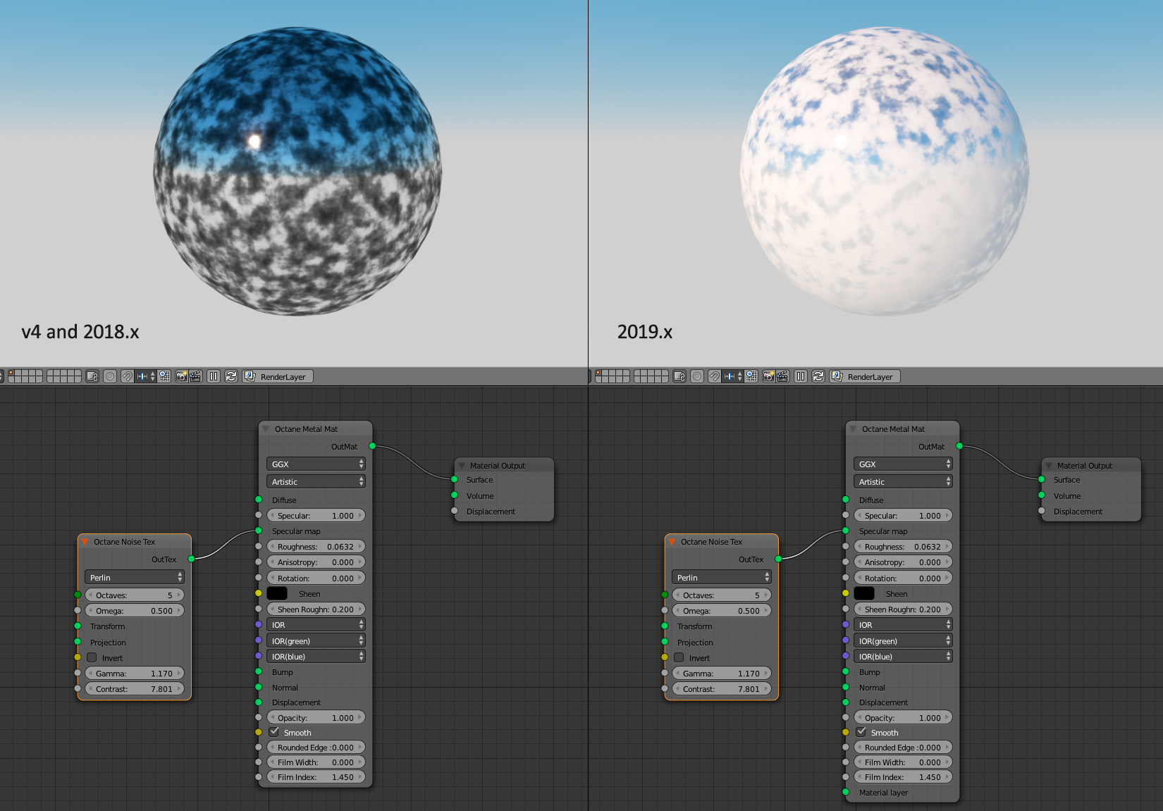

In Octane 2018.x Metallic material's default Diffuse color is Black, in 2019.x it is White.This leads to unexpected differences in projects created in 2018.x or below.

material from 2019 loses mixture texture in 2018
