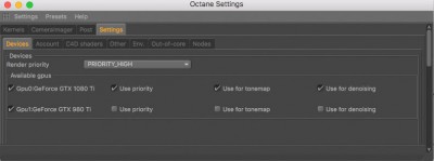

Hi mitchino.
please post a screenshoot from c4doctane settings Devices and Others panels, thanks.
The best is always to have a dedicated GPU for system/monitors/OpenGL, and one or more GPUs for CUDA rendering only.
ciao Beppe

Attached

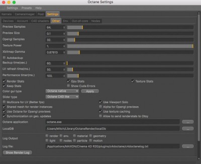

Please, post also a screenshot from the Others panel.
Assuming that 1080ti has also the monitor connected, if you set the Priority to High, it is like having the Priority disabled.
Please set it to Low.
ciao Beppe

Here's the others panel.
The monitor is plugged in to the 980ti, not the 1080ti.
It's like the LV is taking the main c4d hostage, while it's running, the main c4d interface is sluggish. I thought the CPU would take care of that while the GPU runs the LV?
I'll try lower render resolution, but I need to be able to see fine detail in bump maps etc.
Posts: 10591
Priority should be enabled and set to LOW, only for the GPU connected to monitor.
Please, connect the monitor 1080ti instead, in this way you should have more available VRAM.
Also, always make sure to have disabled the Synchronize on geo update option, in Octane Settings / Others,. If enabled can cause instability issues under OsX.
ciao Beppe
