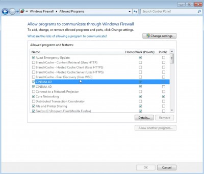

Cool and how do i enable the firewall connections with R20? thanks
Also plz check the scene ur self, u will immediately see the problem with network. It happens on 2 pcs here, cant be coinsidence.
Posts: 10611
Hi thanulee,
please have a look at this screenshot:

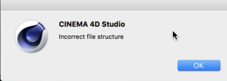

Posts: 10611
I’m having this error message when trying to open your scene:
Please, copy paste the entire scene in a new one, and share it again, thanks.
