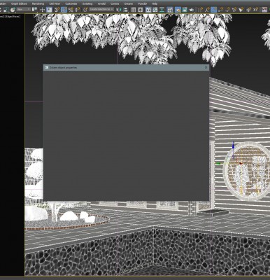

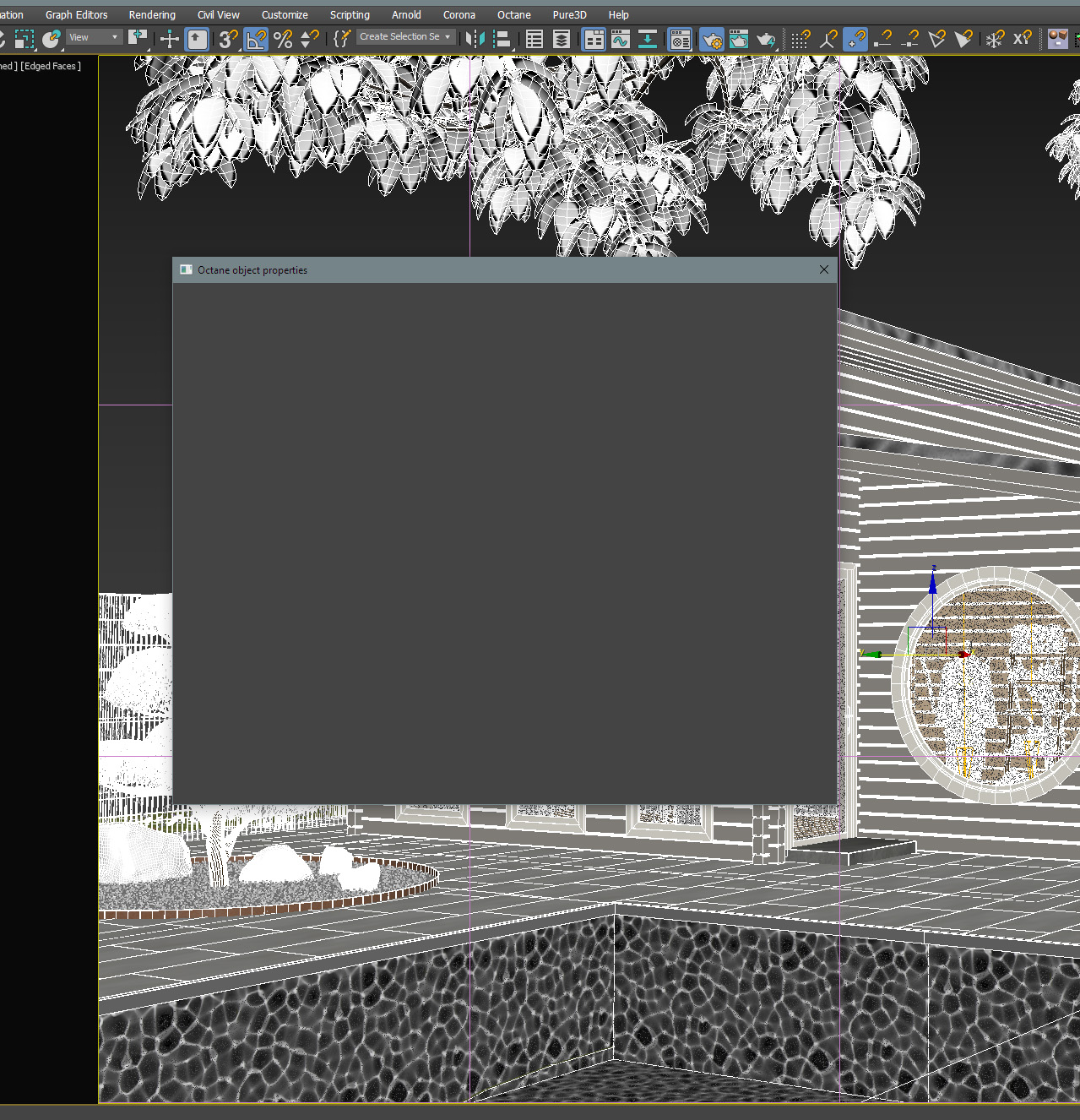

Sometimes when I select all object with CTRL+A and open Octane Properties it is all empty and can't be closed with the "X". But I can resize it. Only a restart of the program helps.
Happens random.
