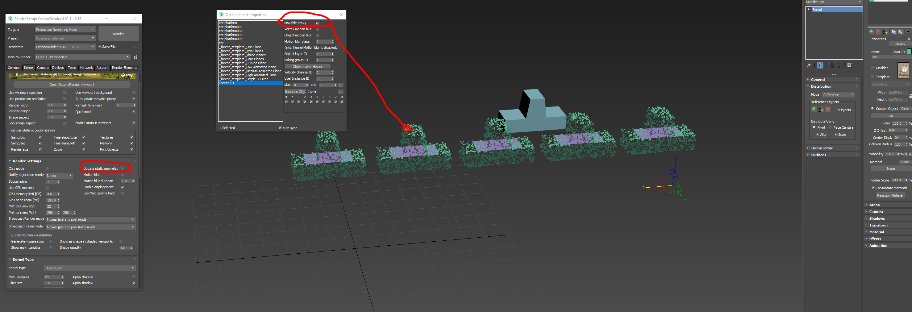

There is a problem with Update Static geometry and itoo forest.
We have animated primitives and itoo is scattered on them (more detailed cars are scattered on moving boxes.). When update static geometry is unchecked itoo objects quit moving even though itoo geometry and itoo forest itself are set as movable proxies. For some reason octane recognizes itoo only as a static element.
Because of this update static geometry must be checked and this makes processing time go from 5 sec to 30.
Can you add an option to recognize itoo as movable proxy too?

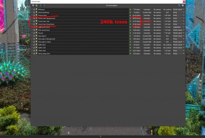

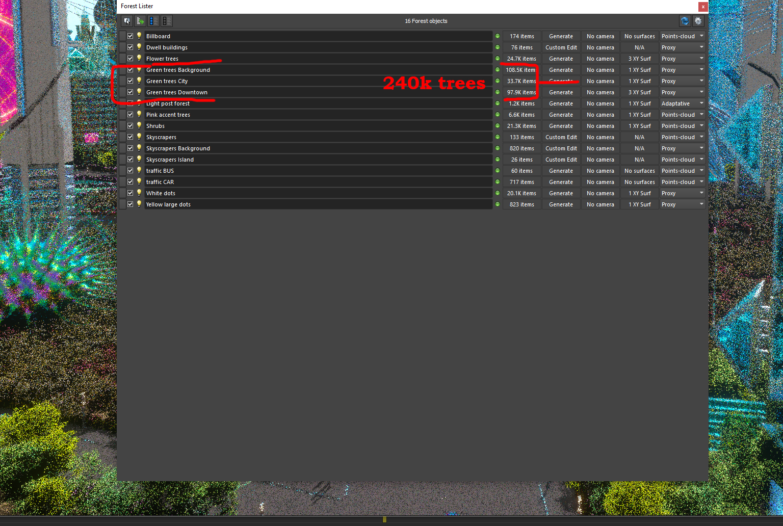

There is a problem with processing times and high count of itoo objects like high poly trees in this example. When green trees are enabled processing times goes from 13 seconds to 54 each frame. There are 244000 trees. Why? I thought once it is loaded into vram there shouldn'r be any processing times.
I think the problem is octane updates itoo every frame because update static geometry is on but we cannot turn it off because we use itoo to distribute on moving planes as detailed moving cars. If we uncheck then itoo cars wont move since octane sees itoo as static object only. Making itoo forest as movable proxy wont work. Please fix it that way we can make itoo as a movable proxy if we want. I think octane updates itoo every frame now

Hi Paride,
I attached the scene it is not working. Itoo cars are not moving. When you turn off update static geometry and set itoo as movable proxy itoo forest does not move even though it is set as a movable proxy
itoo test.zip
(49.94 KiB) Downloaded 290 times

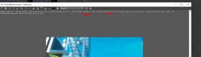

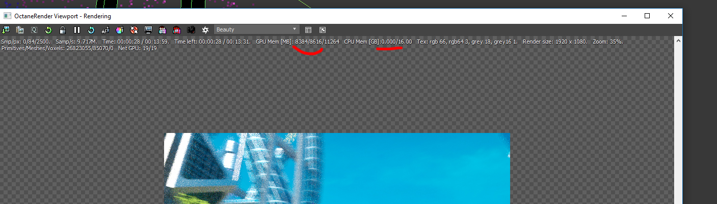

I think out of core has not been working properly.
Now I get cuda error failed to move image texture out of core
Also why am i even getting this error. When I went to octane viewport I am borderline close to my vram limit and RAm is not even being used.
I will also send you the scene soon that has slow eval tiems due to itoo forest.

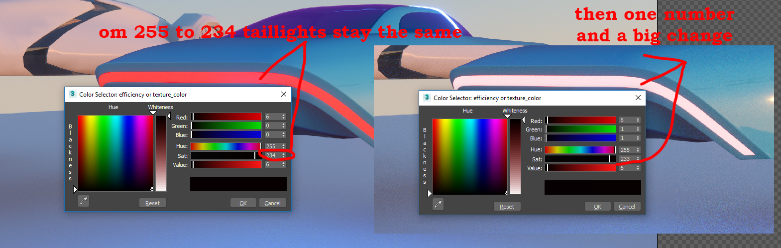

is there any way to have more precision of color. Changing red values from 255 to 234 changes nothing and then changing by 1 number changes red a lot. I need red inbetween. Thanks
paride4331
Posts: 4000
coilbook wrote:is there any way to have more precision of color. Changing red values from 255 to 234 changes nothing and then changing by 1 number changes red a lot. I need red inbetween. Thanks
Hi coilbook,
maybe it could help:
you https://render.otoy.com/forum/viewt ... gb#p143144
Regards
