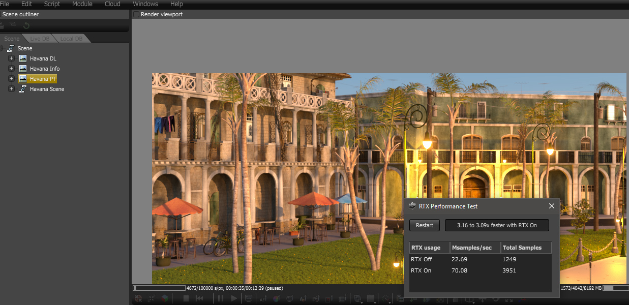

marcvankaam,
I had the same problem with my 2x RTX 2070 their was no difference with "RTX On". The problem is the Nvidia driver 419.35. Download the new version of creator ready driver 419.67 that Nvidia did for GDC. Is not available yet in the normal nvidia driver location. Get the Windows version from here https://www.nvidia.com/content/DriverDo ... type=TITAN.
See below the test with 2x RTX 2070 with benchmark scene where I got 3.16 times faster with "RTX On" and 70.08 M/sec.
