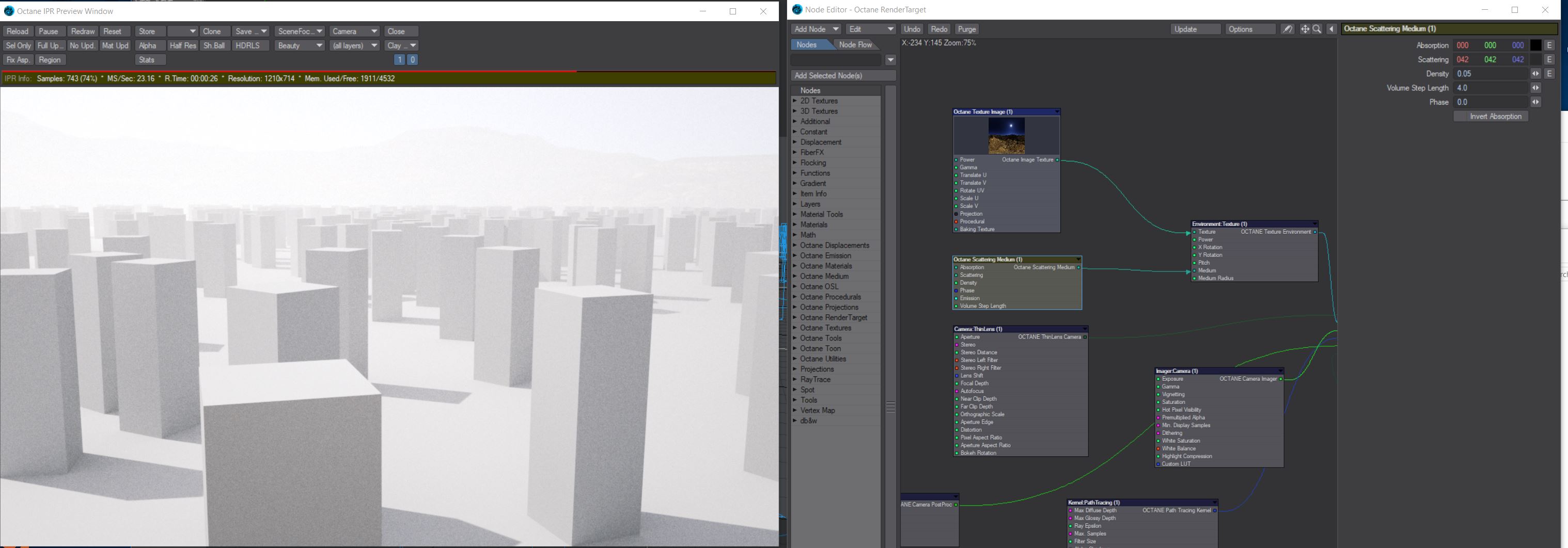

I have no idea how to set the gamma on colour pickers in Lightwave. The fog feature is clearly broken and I would imagine there will be no more attention spent on V4 with 2018 coming soon, beginning to wish I'd never bothered with Octane.
juanjgon
Posts: 8867
Location: Spain
I'm sorry to say that, but I can't see any problem with the fog feature. It is only a matter of adjusting the right parameters in the medium node and the medium radius for your scene scale. To me, the fog feature is clearly working fine, as expected, like in the other plugins.

I can see straight away without even downloading it that the fog isn't working properly, you clearly see the fog in the foreground, fog does not work like that in C4d you can adjust it to work on distant objects and leave foreground objects unaffected.

There is no fog in the foreground objects near the camera. Check it yourself making the instances black and playing with the density and medium radius parameter.

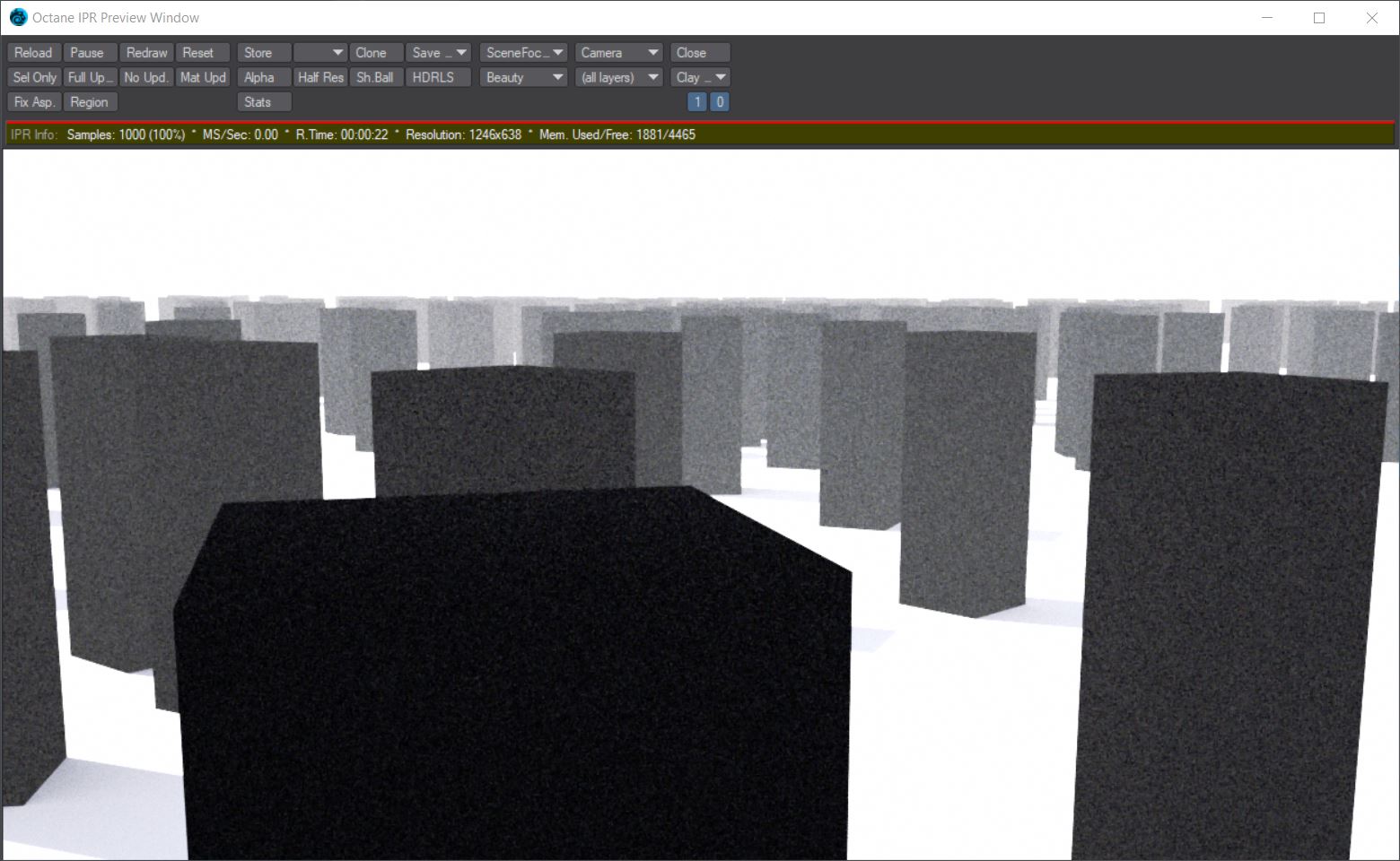

Juanjo, I can see the grainy fog in your picture here, I'm telling you man it's broken and doesn't work the way it should.

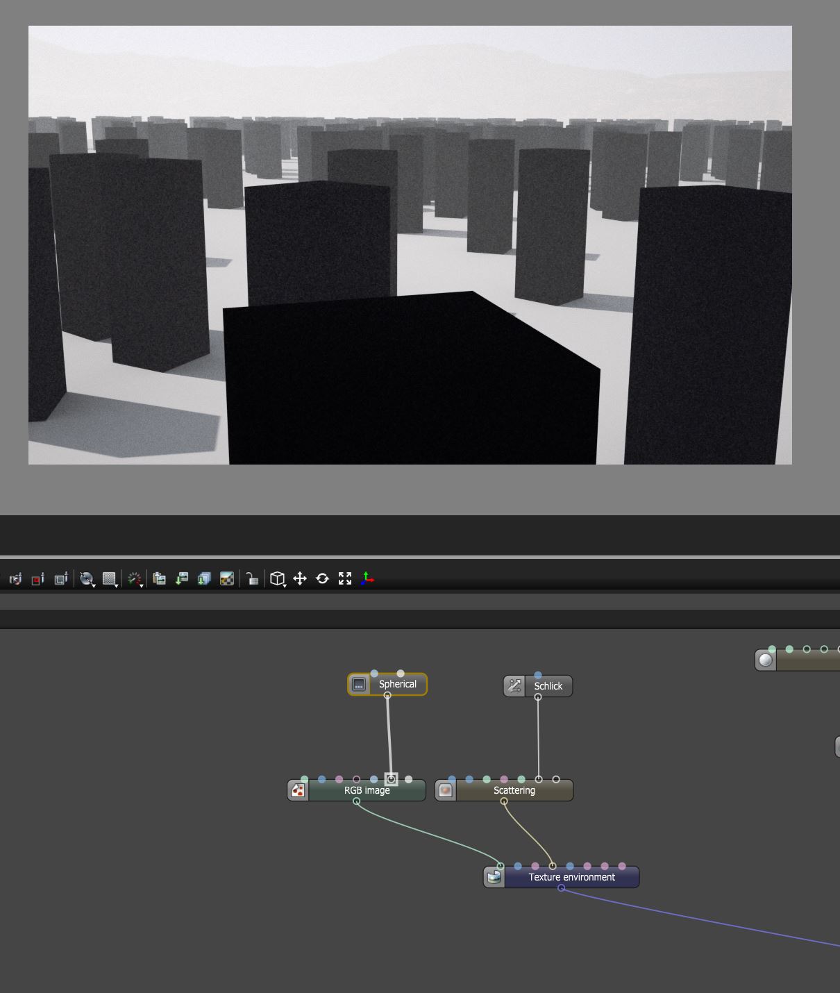

Well, what I can say ... I've exported the scene to the Standalone and everything is right there, with the expected nodes and parameters, but if you think that it is broken you win. Feel free to report a bug in the Standalone using the attached scene if you think that something is not working fine.
https://www.dropbox.com/s/jdlvz2kz3s5nq ... .orbx?dl=0
Thanks,
-Juanjo

AndyM1969 wrote:I can see straight away without even downloading it that the fog isn't working properly, you clearly see the fog in the foreground, fog does not work like that in C4d you can adjust it to work on distant objects and leave foreground objects unaffected.
As a C4D user I can confirm that Juanjgon is correct. There is no difference. ;)
I think that most of the confusion about environment medium input stems from the fact that it is actually a big sphere modeled around your scene with a specular material. It is parented to the camera and radius is actually very important. Also I think there might be a scale difference between C4D and LW and that affects absorption and density values. And of course because it's a sphere it will cover up big part of the sky. Before they added VDBs that was the quick way to cover the scene with fog, but of course we could use any geometry, not just a sphere. And we still can.
Learning more about scattering medium node and how it works in a specular material without any refraction or reflection would be a good starting point. After that you can apply that knowledge to VDB and procedural volumes and those will give you much better control than the environment medium. Refraction is the only difference between fog and SSS.

Juanjo, you can even see the difference between the standalone and the Lightwave version in the two pictures you posted, just look at them, the standalone has no grainy fog on the foreground object and the Lightwave version does, if you can't see it I don't know what else to do.

AndyM1969 wrote:Juanjo, you can even see the difference between the standalone and the Lightwave version in the two pictures you posted, just look at them, the standalone has no grainy fog on the foreground object and the Lightwave version does, if you can't see it I don't know what else to do.
it is not the same scene exactly. I had not saved it ... believe me, the output from LW and from Standalone in this same scene was the same.
