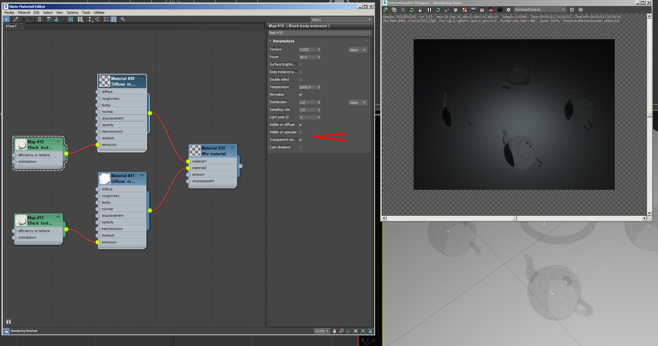

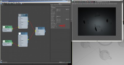

Hi coilbook,
try using a mixmaterial with two emitters animating the amount.
Regards
Paride
test.rar
(80.27 KiB) Downloaded 257 times
anim.mp4
(88.32 KiB) Downloaded 3241 times
