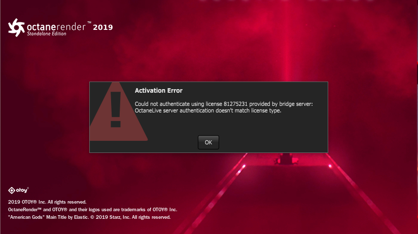

Thanks, but I can't test it with my v4 license ... I think it's work with all access in contrary to the description.

I would really like to test, as in any software, this last version - seems awsome!
I'm on a regular V4 License and considering upgrading.
At the moment only Studio subscription can test.
I could buy 1 month but it would be nice from Otoy to let V4 customers test the beta version.
M
